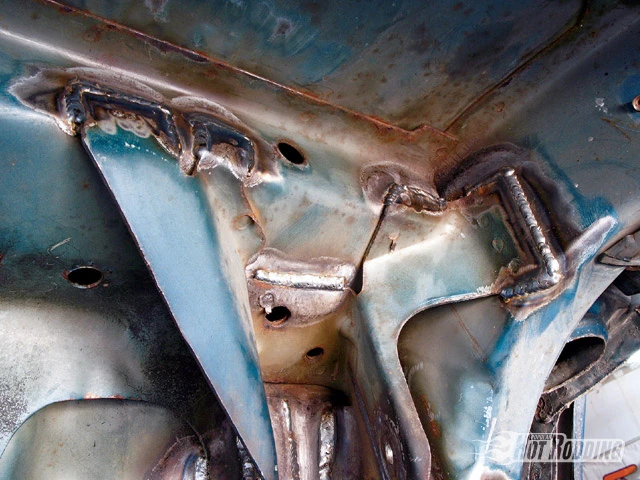

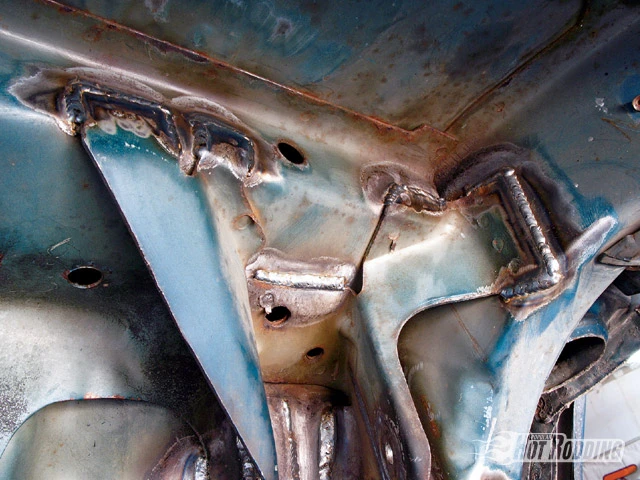

As for the clunk, you might want to turn your attention away from the rear axle and toward the upper control arm mounts on the chassis. It's not that uncommon for the brackets to tear and pull away from the floor especially if the car's been abused (e.g. drag raced with slicks on a prepped surface) or if it's seen a lot of winter miles in areas where road-salt is common. Since these mounts serve to locate the rear side to side and to deal with axle wind-up clunking and knocking may be heard in both turns and when transitioning from coast to drive if one or both of these mounts is damaged.
Awesome! I noticed my left upper control arm was a bit loose, enough for me to rotate a bit. And when I did the lowering springs and dropped the axle down, I noticed all my bushings are shot. I'm in north west Indiana so we get a lot of snow and road salt. That helps ease my mind a bit because control arms are a lot easier to replace than rear end internals, and you can limp the car home a lot easier if a control arm goes out compared to the whole rear end. I remember I had to drive my old Lumina a good 10-20 miles with the rod going out because the intake gasket sprung a coolant leak. I never want that feeling again lol.
If you can move the control arm by hand I think you've found the source of the noise.
But go check it again. It's possible the bushings are bad but you should double check to make sure the upper control arm brackets that mount to the floor/frame of the body have not been damaged. The bracket's I'm referring to can be seen here:
Check this article:
http://www.popularhotrodding.com/tech/0911phr_1993_ford_mustang_notchback/index.html
