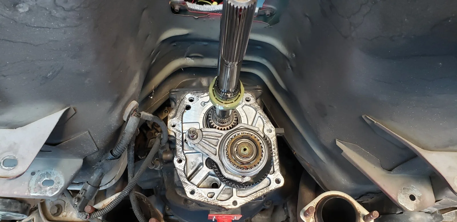

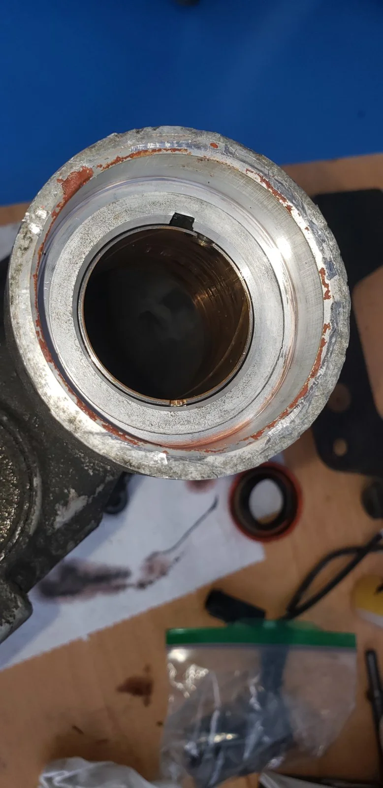

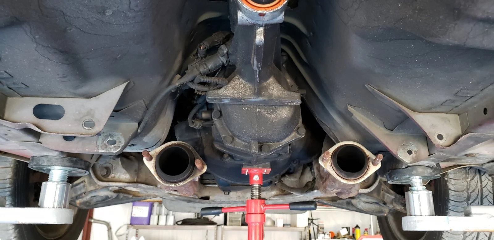

Got a good bit done over the weekend. To start with my father-in-law surprised me with a late birthday present.

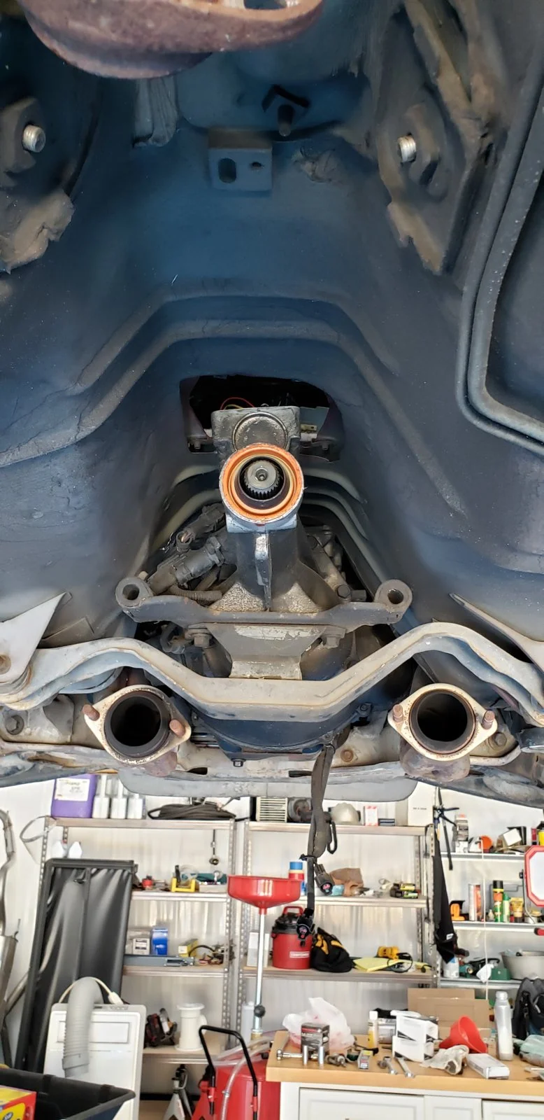

This will do pretty much everything I'll want to do for a long time. So, with the car I decided to just pull the tail housing as suggested and remove the bushing. I probably could have finessed the two bolts out from the front of the shifter cover, but I figured they would be a pain in the ass to put back in so I went ahead and pulled the center console to get down to the shifter. Either way it worked fine. Next I got under the car and pulled the h-pipe. Everything came off pretty easy.
Drained the oil then pulled the cross member.
Then off with the tail housing!
I messed around for a bit trying to get the old bushing out. It didn't want to budge. Then I realized that there is a grove under the bushing where it could be cut without the risk of messing up the tail housing. Out came the sawzall and a hacksaw blade. The bushing never stud a chance!
I ordered the new bushing a seal from Rock Auto and they came in over the weekend. The new seal is a lot longer than the old one and the new busing is split with one oil grove circling it from top to bottom. The old bushing had two oil groves and was not split. I don't want to put in a cheap bushing that I'm just going to have trouble with. I also noticed that there is a spot on the new bushing that is already scared. I'm going to send pics to Rock Auto and I'm sure they will just give me a refund.
Anybody got a good recommendation on a quality bushing and seal? Other wise I'm just going to get one from LMR or Summit.

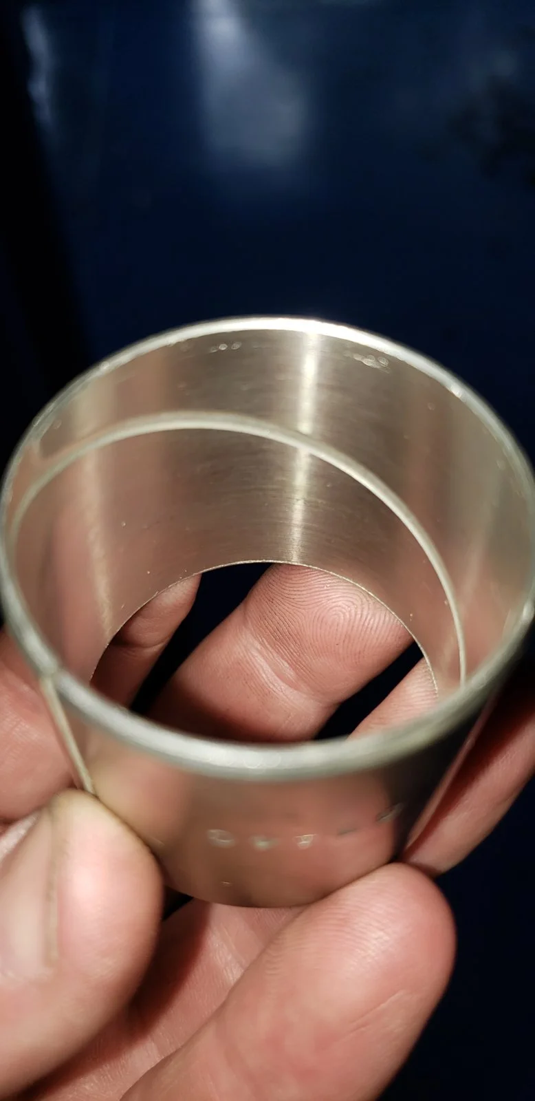

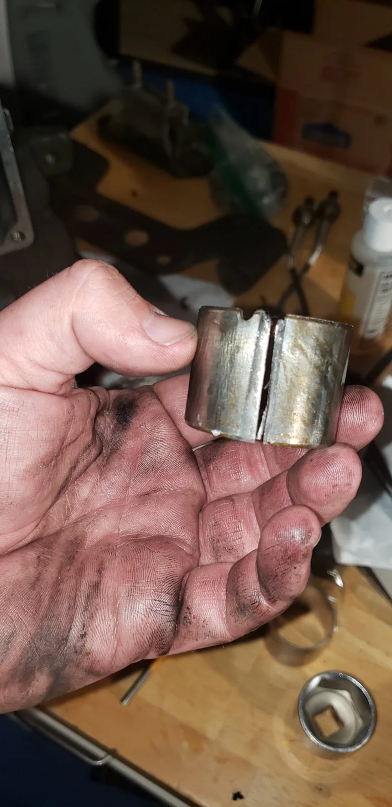

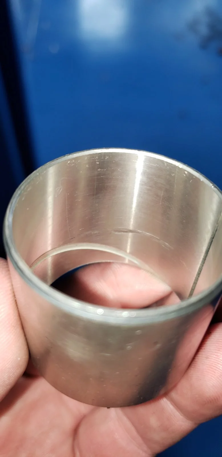

Here is what the new bushing looks like.
You can see the ruff spot in the pic.
and the old one.

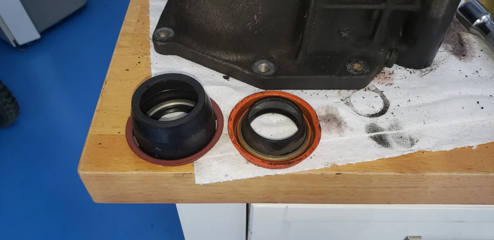

Here's the old and new seal. You can see the new one looks a lot different.

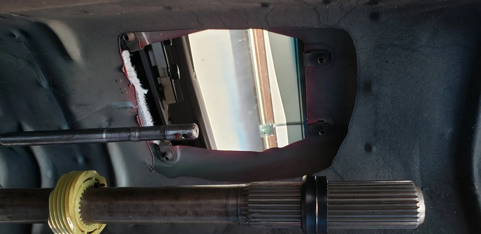

On a side note. Looking up through the transmission tunnel where the shifter go through. It looks like someone cut to make the hole wider at some point. As far as I know this car has always been a manual, but I guess maybe someone put an auto in it at one point. Or maybe just a different manual. I wouldn't be surprised by anything.
