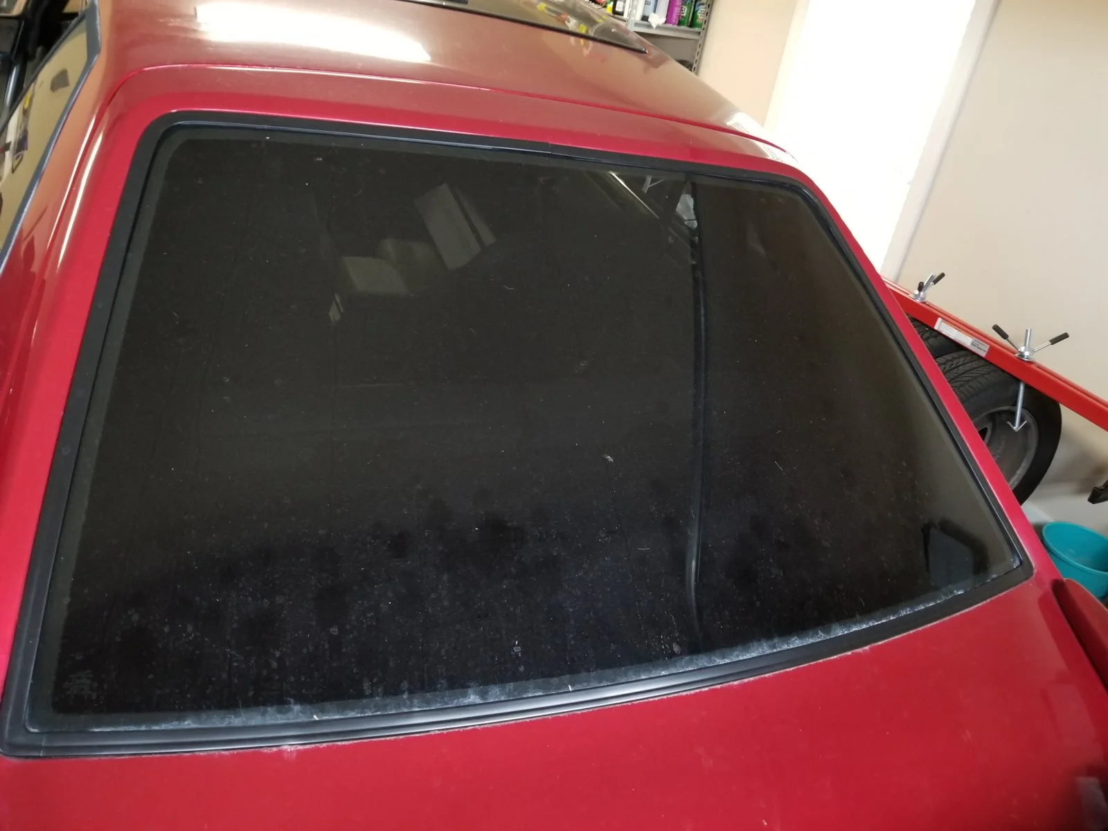

Just to let you know, when doing the sunroof, those plastic pieces that the stainless things slide into at the front, take them out and make sure they are not cracked and reseal them, I used silicon, on the little screws too, if they are cracked they leak, the gasket from the factory dries up and will leak too.
Mine were not cracked but they had been wrapped in duck tape and were rusted into the plastic sleeves. I had to dig the rusted metal out. I bought new replacement. I can't remember if I sealed the screws.

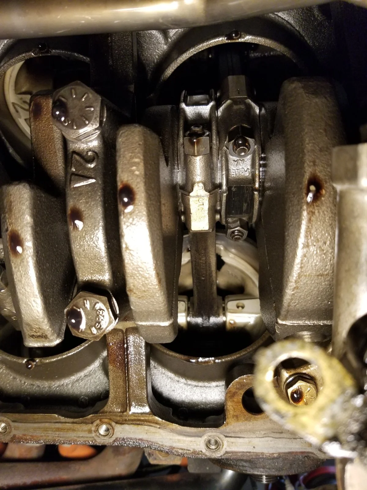

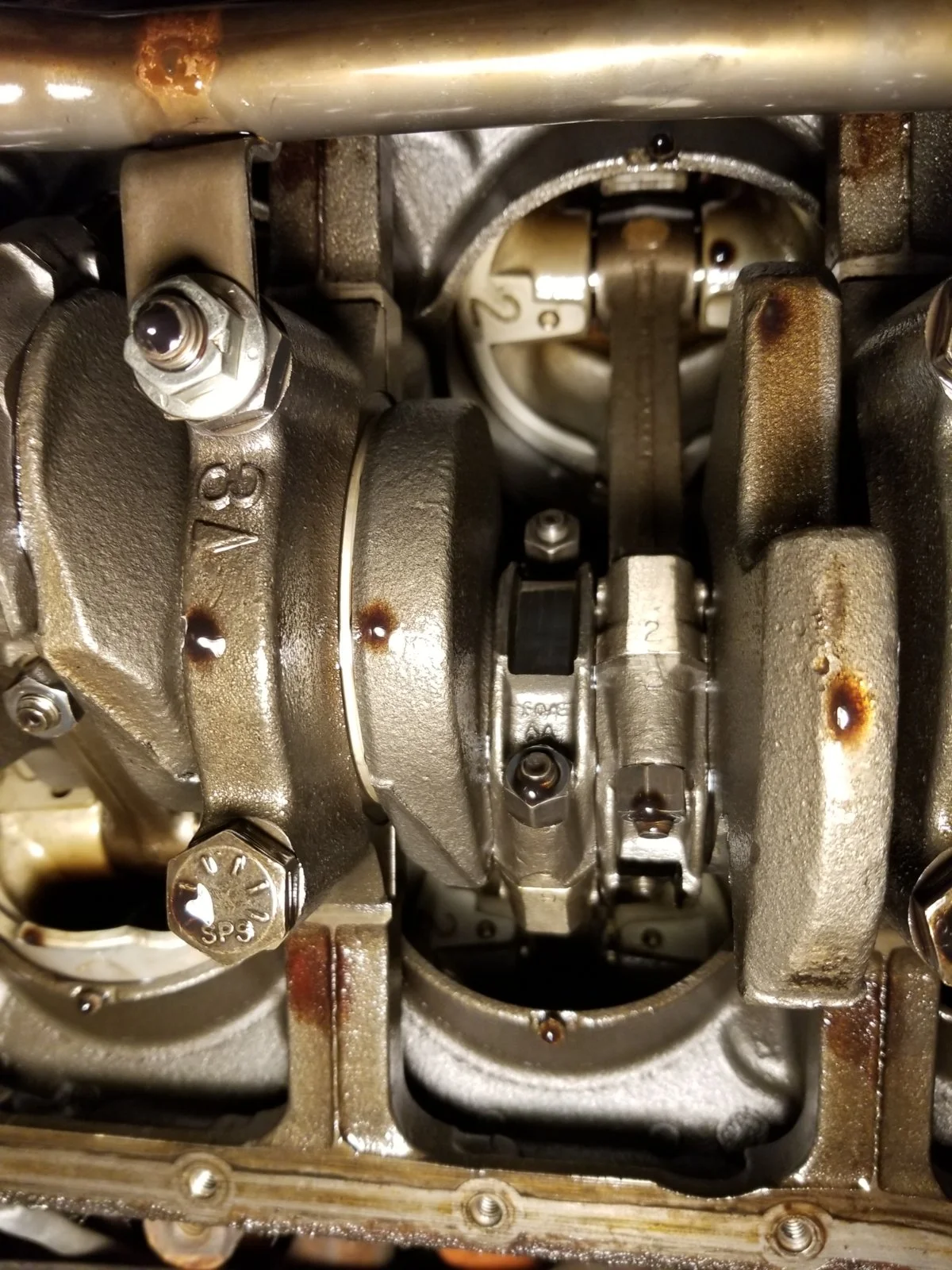

Soooooo. I got under the car tonight to check for cylinder notching. This is what it looks like. Doesn't look notched to me.
Nope, not only that, but the internals are bone stock.
It's too bad that bogus statements made by a seller doesn't end up costing them money...especially when the seller makes claims that the engine is what it isn't. If for whatever reason the seller is asking premium money for something, and one of the parts that justify that asking price can't be verified, there should be a special 24-48 hour contract that could be entered into: I.e.
"Here's my 75% initial payment towards your selling price. And I'm going straight home to inspect. When I pull the pan and verify that there are aftermarket internals and cylinder notching confirming your claims, the remaining 25% will follow." If you don't inspect within 24/48, then the money automatically goes to the seller, if you do, and find what you found, then he forfeits.
I know there are too many bad things that could go wrong with a deal like this on both sides, but I'll bet in this case that the guy selling ( and lieing about it) wouldn't have agreed to sell, or thought better about making false statements.
I'm not gonna like finding out that aspect of the car is false isn't fun. The only saving grace is that I didnt give a lot for the car. No premium because of it being all done up. I actually low balled and he called back a few weeks later and excepted my price.
The silver lining to the whole thing is that now I know more about what I'm working with. Also, when I get ready for to make changes I can do what I want and I'll know that the work is quality.

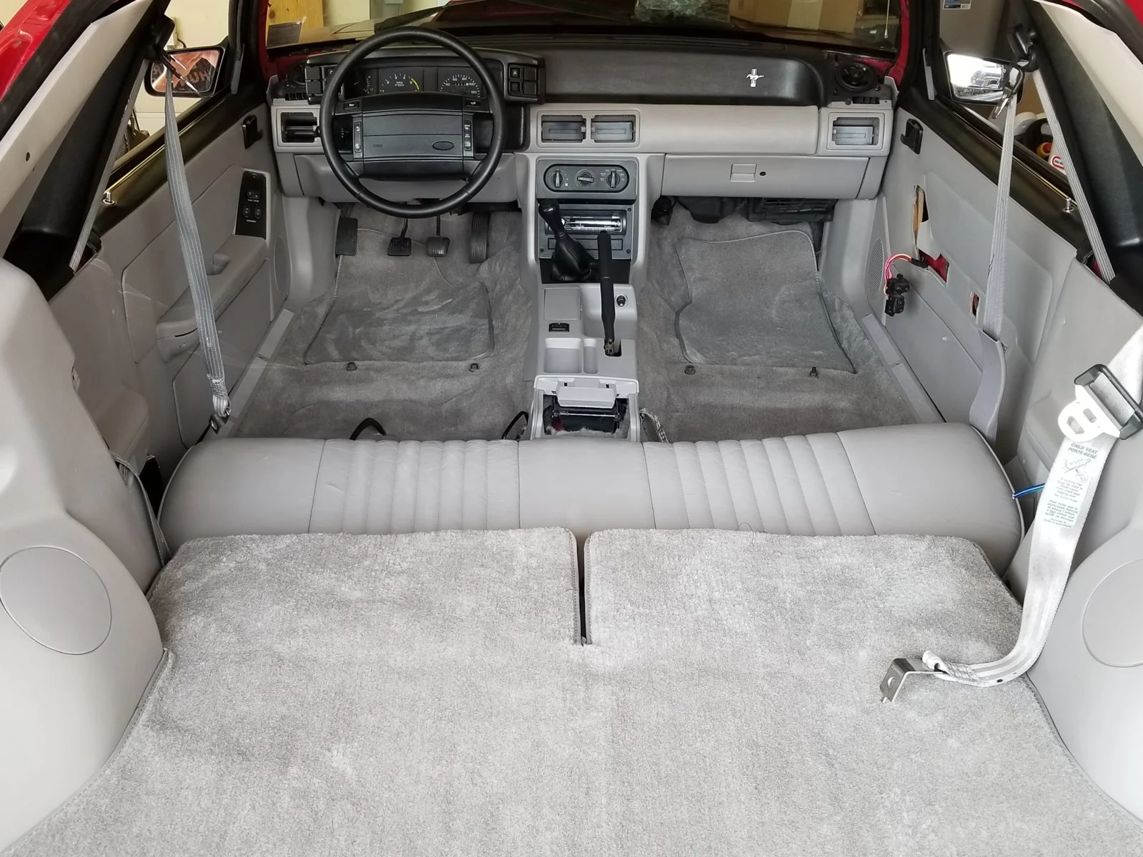

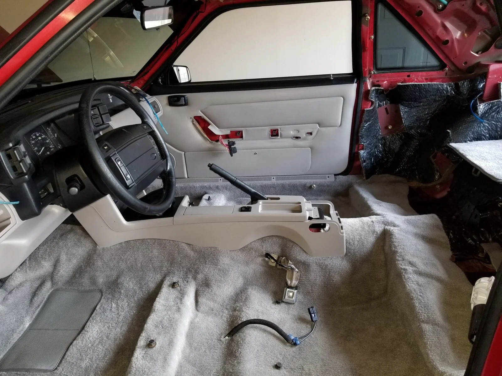

Other things that have been done to the car to date are: front and rear window trim was sanded and sprayed with trim black

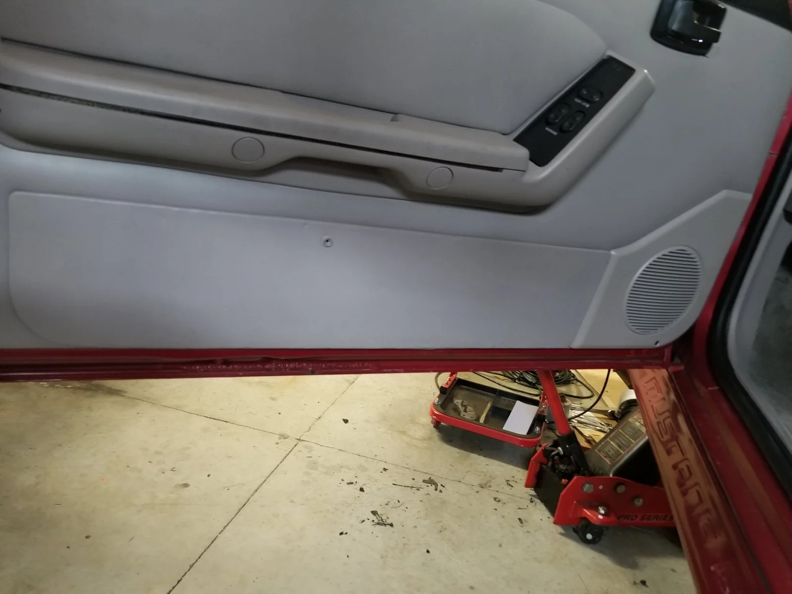

I didnt buy new map pockets and I didnt want to buy deletes either so I took the doors apart and removed the pockets from the factory card then reinstalled them. The entire door card was cleaned up and sprayed

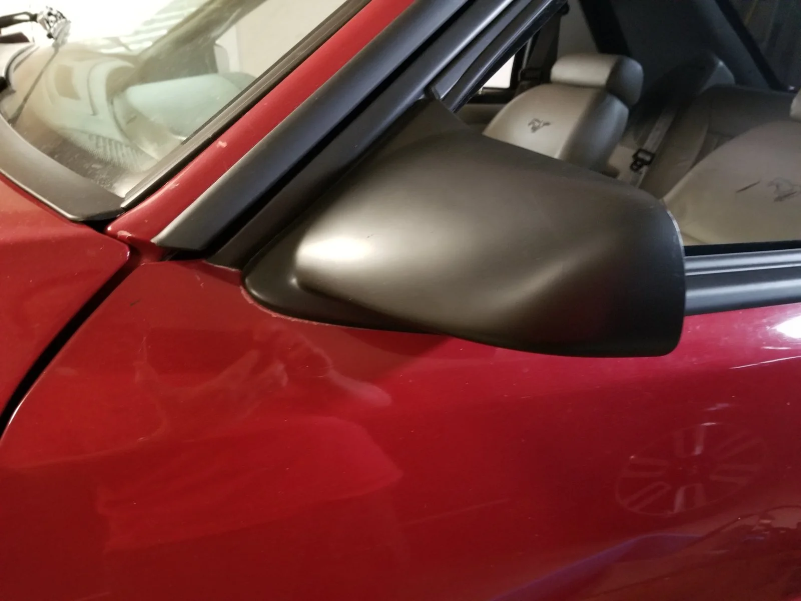

Also, replaced the armrest. Cleaned and sprayed scuff plates. New window belts. New roof rails, all new door seals. I removed the side mirrors and sprayed them as well.
I cleaned and wet sanded these 4 or 5 times. Every time I painted them the paint would fish eye like I hadn't properly cleaned them. I even primed them. They are on the list to replace at some point possibly anyway so I'm not worried about it. New power window motors. New inner and outer door belt weather striping. I replaced the outer door molding but I dont like the fit. It has a large gap close to the rearview mirror. The old ones looked bad but were tight. Unfortunately i threw away the originals before realizing I probably should keep them.
The door handle bezels have been replaced. New speakers in all 6 spots. I went ahead and replaced all the wiring while the interior was out. New center arm rest pad. I took that entire thing apart to cleans and spray it. It was not easy to put back together. The hatch supports are new. I replaced the hatch weather stripping. Also bought front seat belt sleeves. I haven't installed them yet. I think that's about it for the interior. I'm sure there is more but I can't think of them.

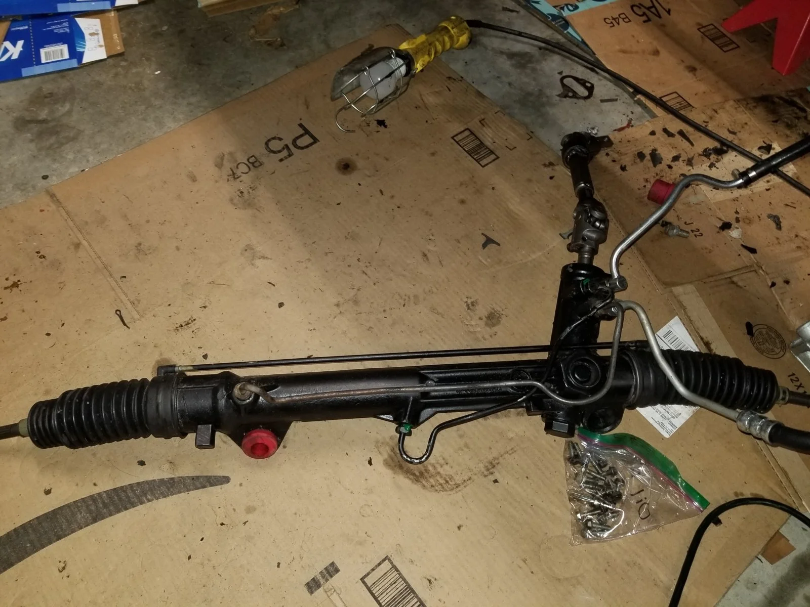

Under the hood I got the 6AL sorted out and it has been mounted on the inner finder well by the intake. You can see it in other pics I've posted. Replaced all the hoses, water.and power steering. New radiator bushings. Rebuilt the power steering pump. New alternator

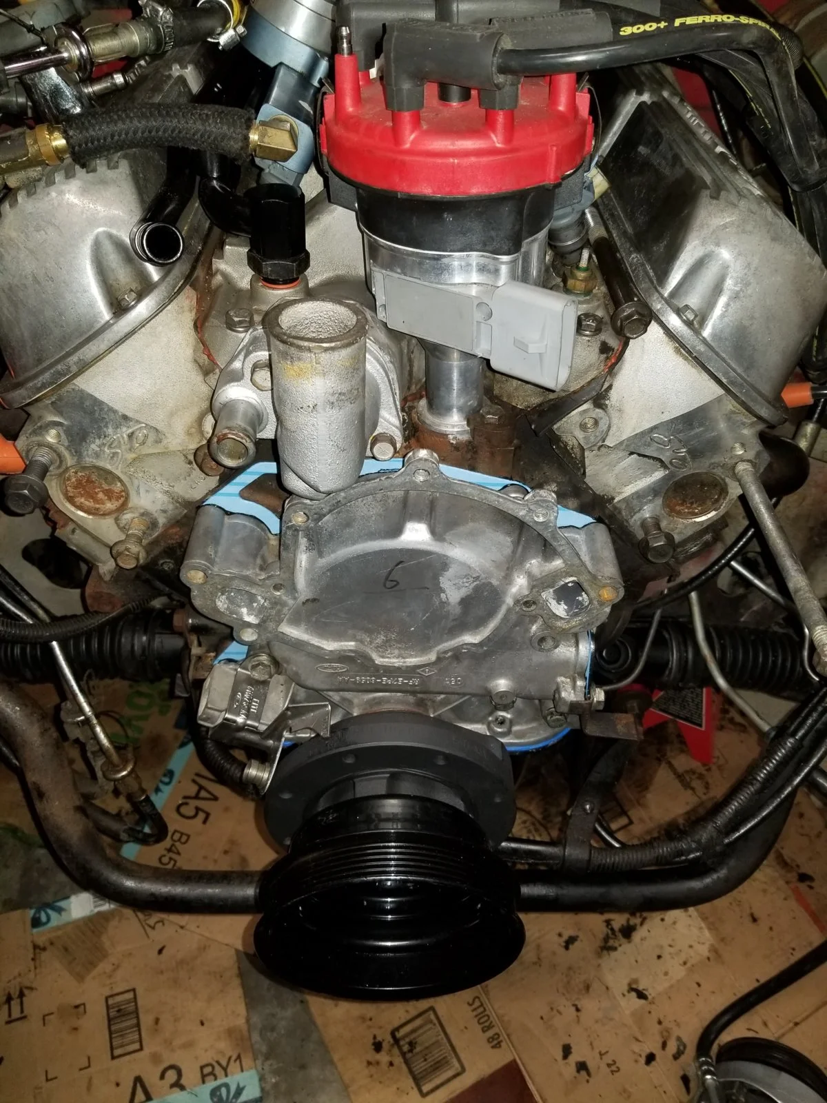

New water pump. Just picked up a factory crank pully from a local shop. My alternator had melted the plug and was burnt looking. New SN95 rack and pinion. I also picked up a MM steering shaft.
SVE bump steer kit. The car is lowered.

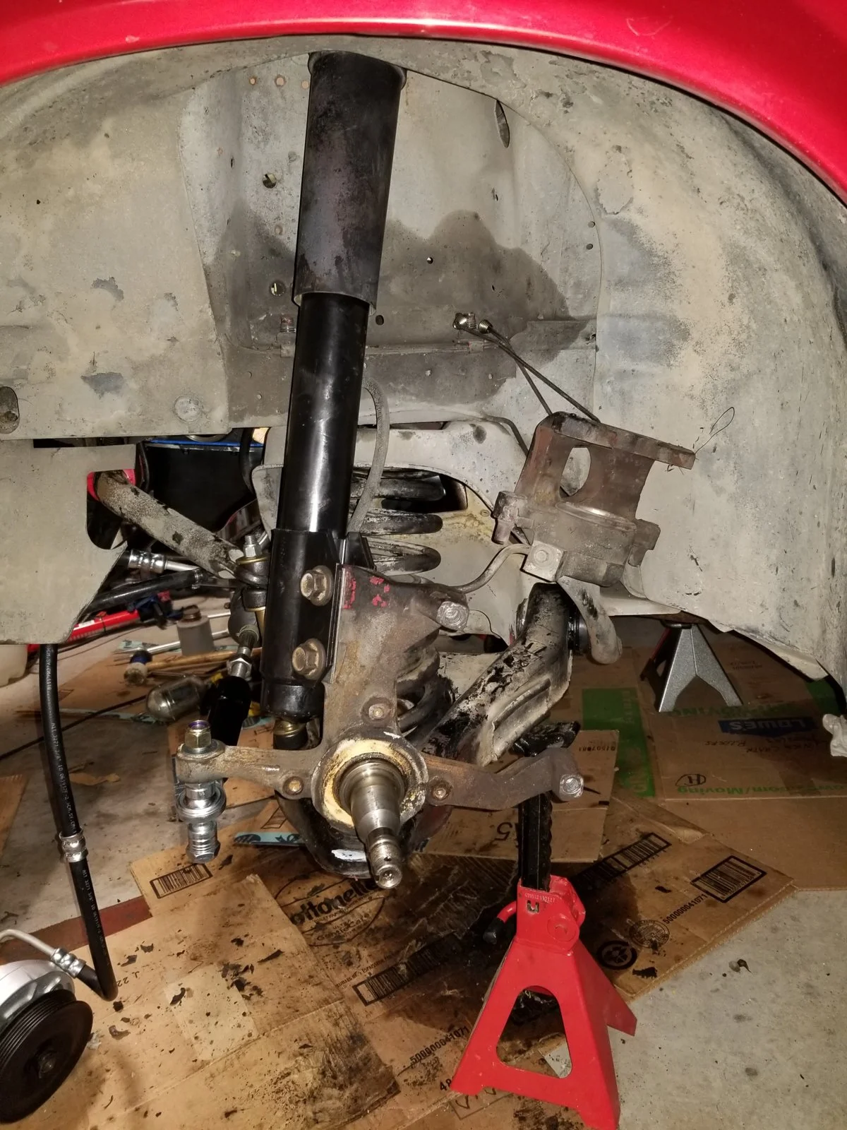

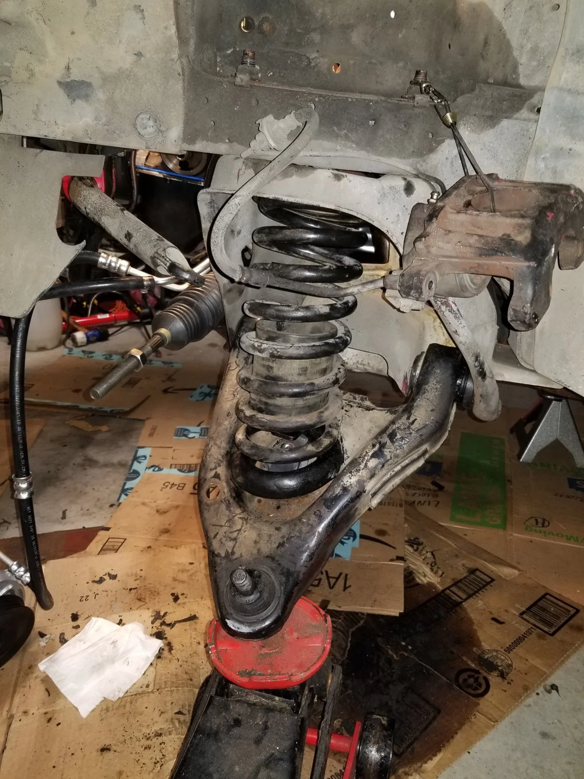

The last time I drove the car it was awful. Keep in mind this was before replacing or upgrading anything on the suspension or steering. I have yet to get all this stuff removed and replaced..That was also the first long drive I had taken in it. About 100 miles or so. It just kinda mushed around in the corners. Steering was sloppy. It just wasn't right. That's when I decided to go through the steering and suspension from front to back. I might regret it but I went with the energy suspension polyurethane kit. I also put offset rack bushings on it. I plan on upgrading to coil overs in the future so I went with an OE front strut. I bought Moog ball joints. I have all the bearings for the front spindles. I went ahead and bought new rotors and pads. When I took the water pump off and replaced it with a new one the timing chain cover started leaking. With everything else off I ended up dropping the k member and replacing the oil pan gasket, timing chain cover gasket, and front main. Last night i got the k member up, rack reinstalled, drivers side spring installed, spindle on, and sway bar end link on. Hopefully tonight I can get the strut installed.

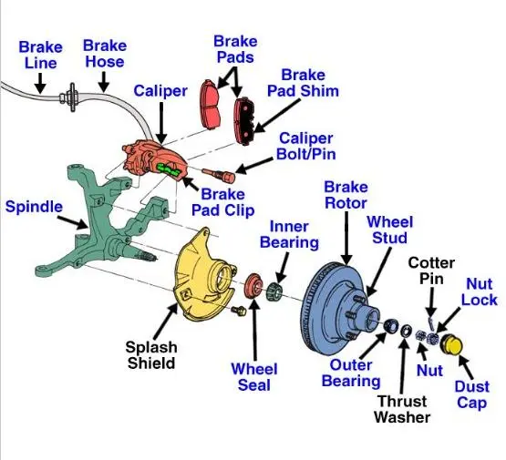

It's been a long time since I took the hubs off the front spindles and I'm a little foggy about everything needed to put it back together. I tried looked for a diagram but didnt come up with what I think I need. I have a seal and inner/outer bearing, nut, nut retainer, washer, and dust cap. For each side. Other than the splash guard and hub am I missing anything?
Thanks! Not sure why I couldn't find that, but it looks like I have everything.
When I disassembled my spinal there was a paper or felt gasket between the back of the spindle and the splash guard. Is that factory or did someone add that to help cut down on squeaking/noises? Do I need to keep this?
