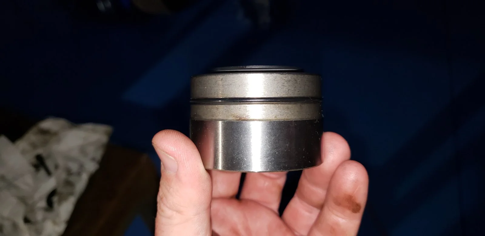

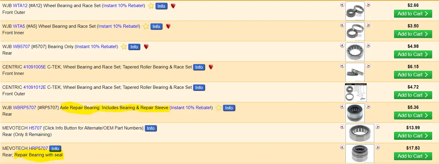

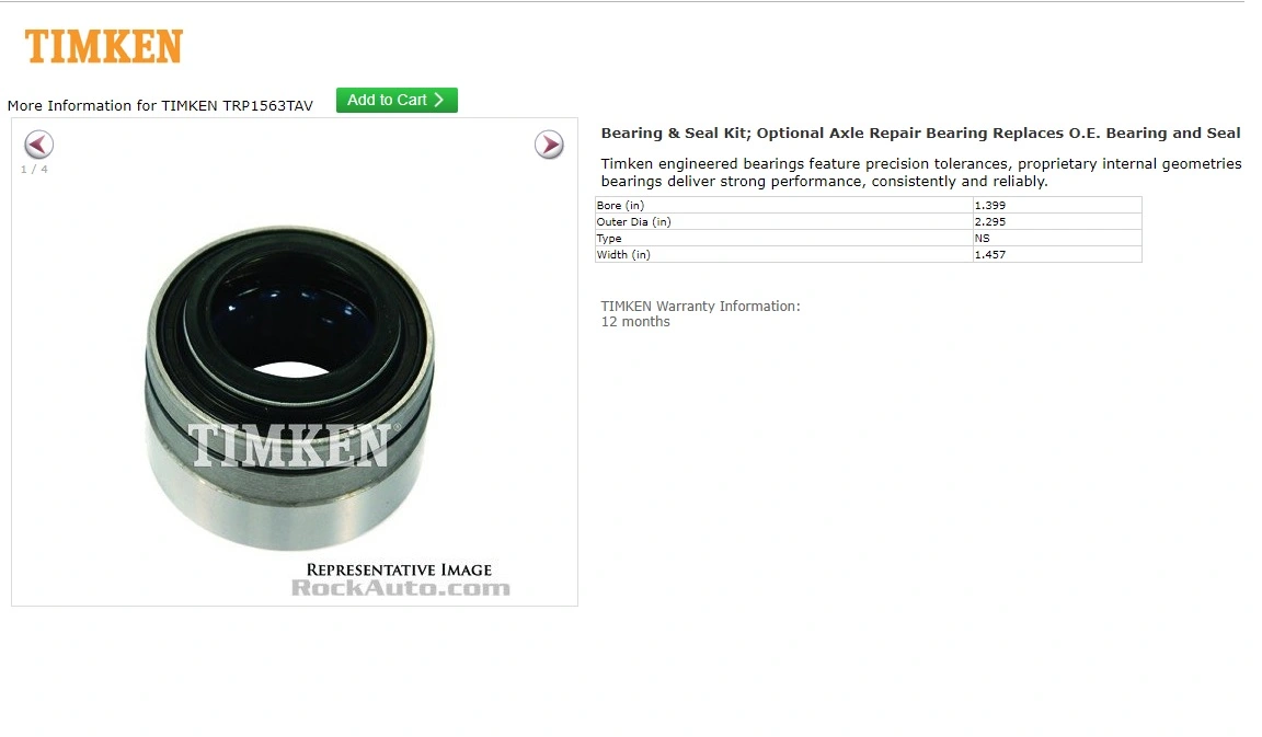

Holding the new bearing up to the old it was obvious that the new one was slightly larger on the O.D.. It also has an o-ring around the seal end. With the OEM suff the area of the axle tube is slightly larger where the seal goes in, but the larger end of the new bearing is also larger than the oil seal.
In the pic above the seal is on at the top and the actual bearing is on the bottom.

I can google search it and find other places that say it fits a 92 mustang 5.0. I just don't see how. I even tried to get it started last night, but it didn't want to. That's when I started comparing it to the old one and realized that the new one was slightly larger.

I might just do that. I'd like some feedback from the group first to confirm that I'm not just looking at the issue wrong. I dont want to complain or try to get a refund/store credit if the problem is me!

It looks as you just accidentally ordered the incorrect part. What you have there is a repair wheel bearing that includes a sleeve to fix the housing. I assume there isnt anything wrong with your axle ends, so you should be able to just get the right bearings.

Slide hammer and the bearing puller kit are the way to go to get these out. I bought the puller kit, but usually just rent the slide hammer.
But I agree with others...that bearing is not the right one

You nailed it! Not knowing what repair bearing meant I got them. It seemed like a cool part as it was all one unit, bearing and seal. I read the description of the part, but just thought the "repaired a bad bearing". Which is what I wanted to do. I know now. Well if I ever need to "repair" the wheel bearings I've got a set!
This is the description.
It even says "Replaces O.E. Bearing and Seal"

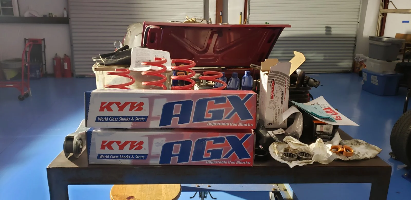

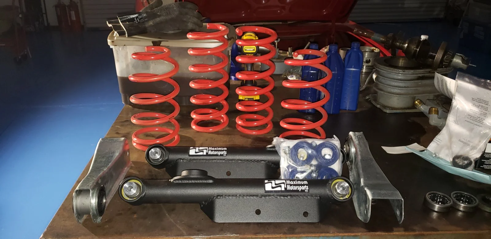

The LMR fairy stopped by the house last night!
Whats in the boxes!
Shocks from Rock Auto should be here this afternoon.
Reactions: Potomus Pete, 2Blue2, 90sickfox and 3 others

Christmas in October! Very nice. Good call on the uppers. If you go solid or poly on the uppers and lowers, the geometry of the stock suspension can cause it to bind and potentially damage the torque boxes. I think Maximum Motorsports has a great explanation on their site under torque arms. Basically the short upper arms and longer lower arms are trying to swing in two different arcs when the rear end travels. The mushy rubber stock bushings have enough give to help prevent it, but then you get bad wheel hop, so they had to add the quad shocks to fix that.
Whats in the boxes!
I’m sure I missed it somewhere, but which Eibachs are those? interested to see the stance when your complete.
They are the Sportline. I hope it isn't to low. It sits low in my opinion anyway. The tires that are on it currently are not as tall as factory tires. Thats what the PO had on it, so when I put new tires on I just went with it. It makes the wheel gap slightly larger.

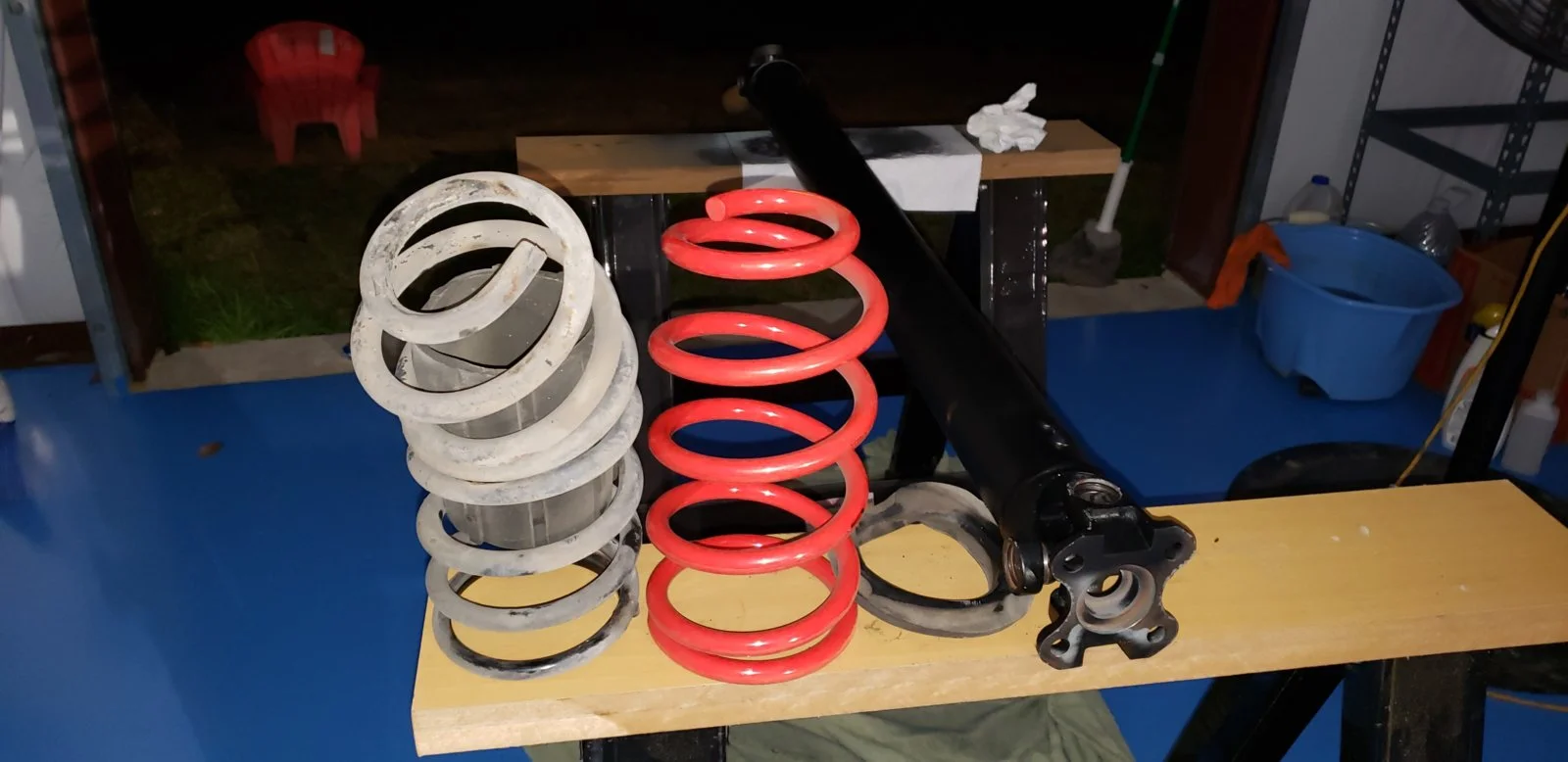

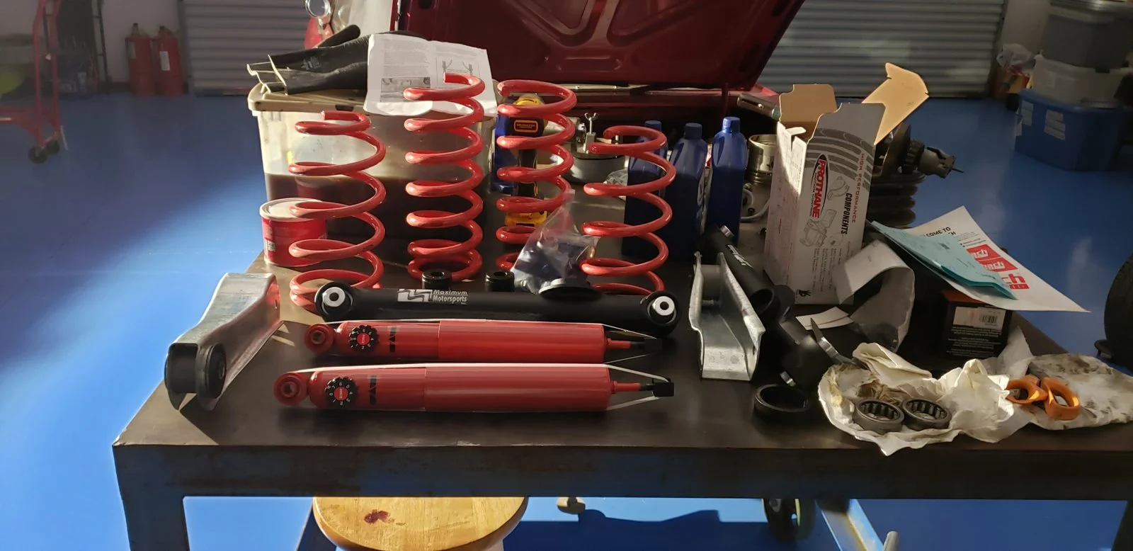

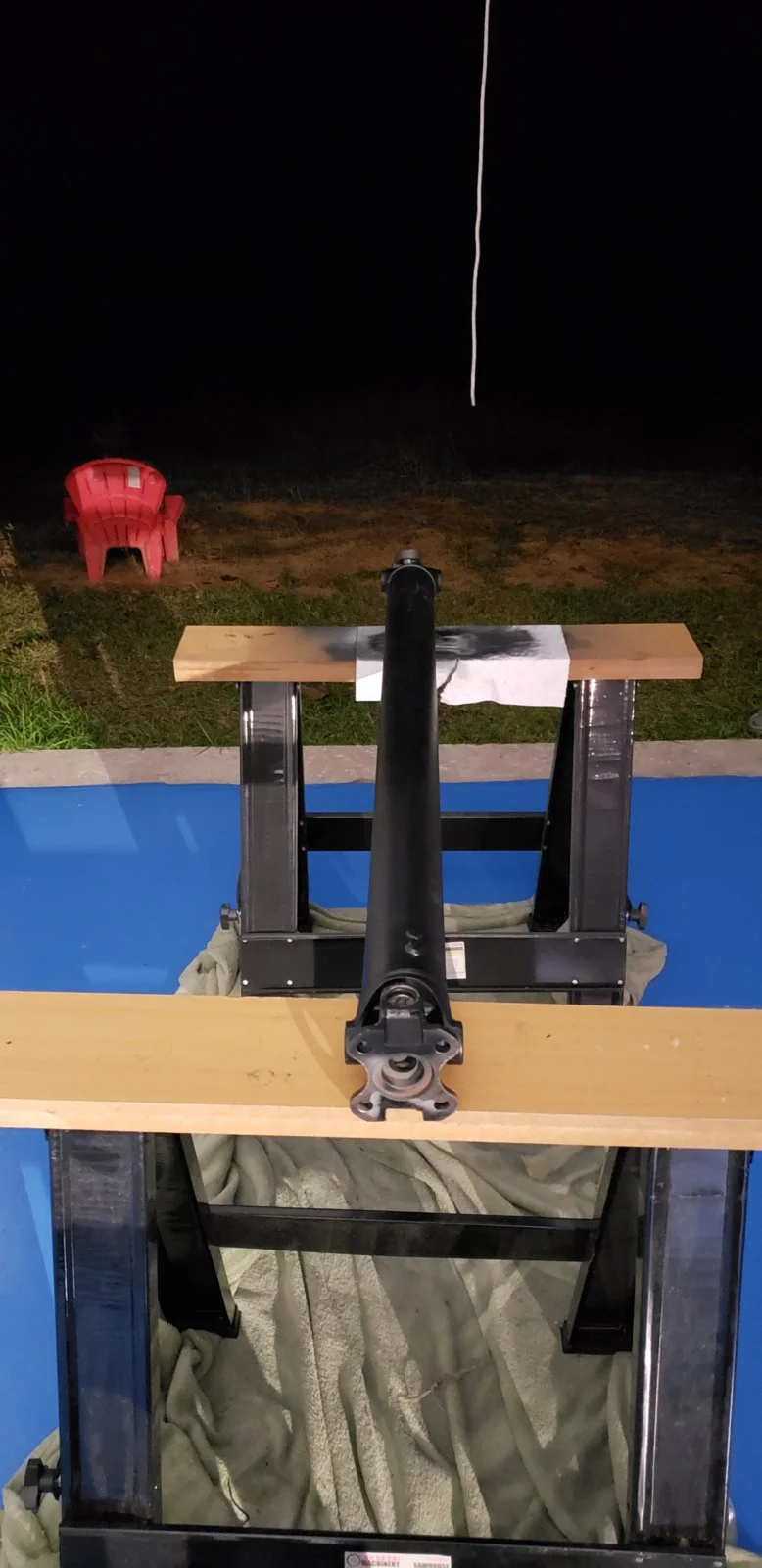

Got to mess around a little bit last night. Finished the driveshaft.
Fedex came through with the new shocks! I went with the AGX because . I've got them on the front and they seem fine for what I'm doing. Figured it would be good to stick with the same style all the way around.

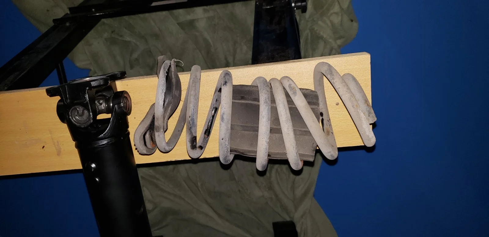

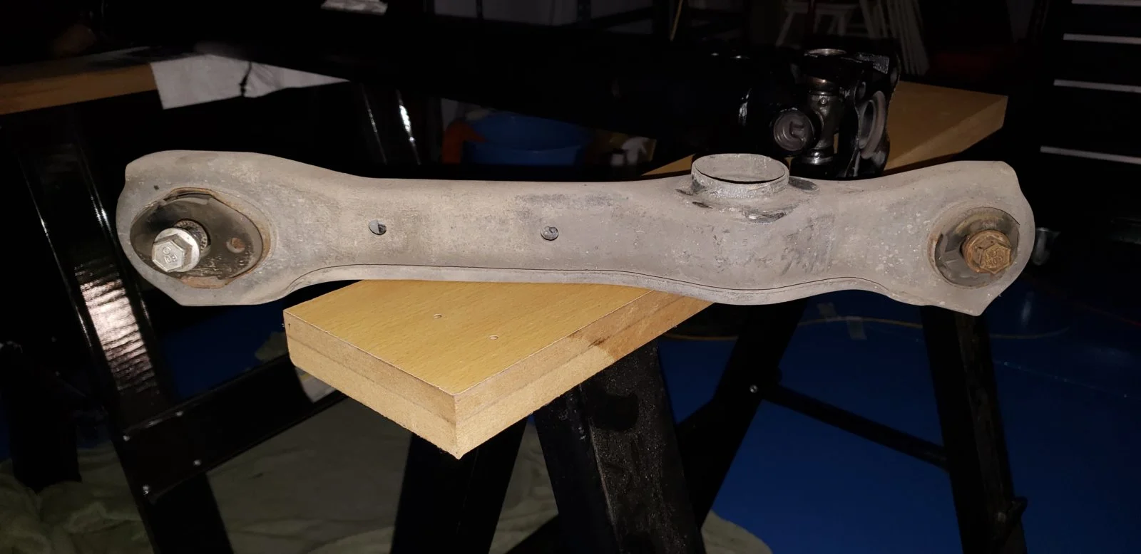

I went ahead and pulled the lower control arm off of the passengers side of the car. It doesn't look so hot!
Do you guys reuse the rubber thing in the middle of the spring? What does it do?

Here's the old control arm. The rubber isn't that bad. Now the uppers. From what I can see of them they are in bad shape.
I'm a pack rat so I'll be stuffing these in a corner somewhere for safe keeping!

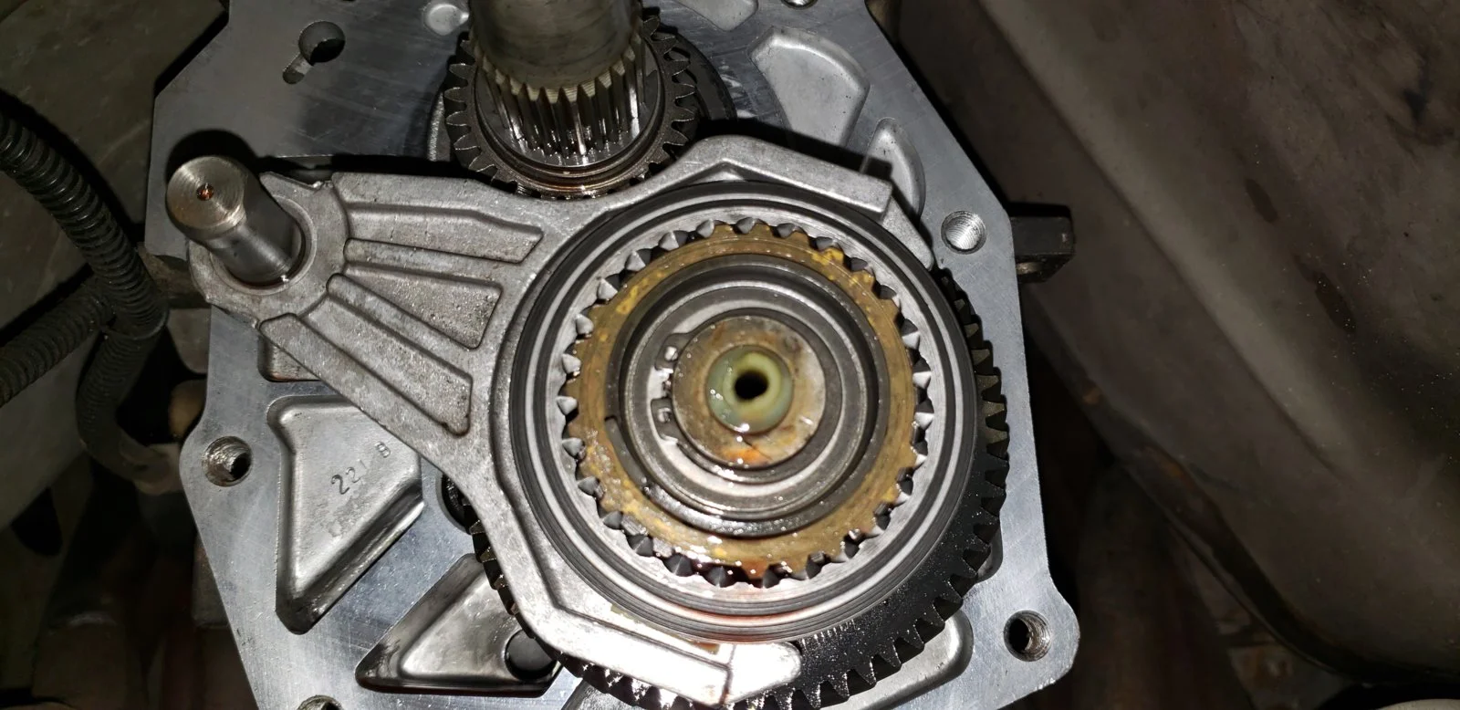

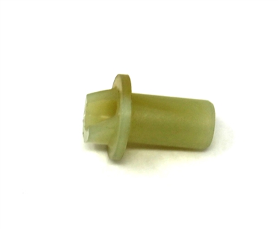

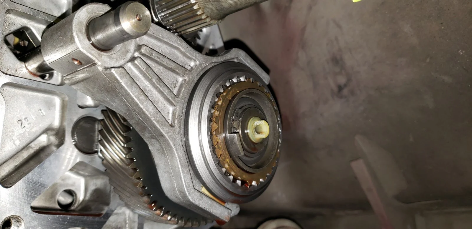

Does anyone know what this is that that seems to be broken of the reverse gear of my transmission, at least I think its reverse. It's a little plastic tip in the center of the gear.

Wow, that spring is terrible.
The little plastic nub on the end of reverse is an oiling funnel. Part number 1352-034-002 (E5ZZ-7L276A)
