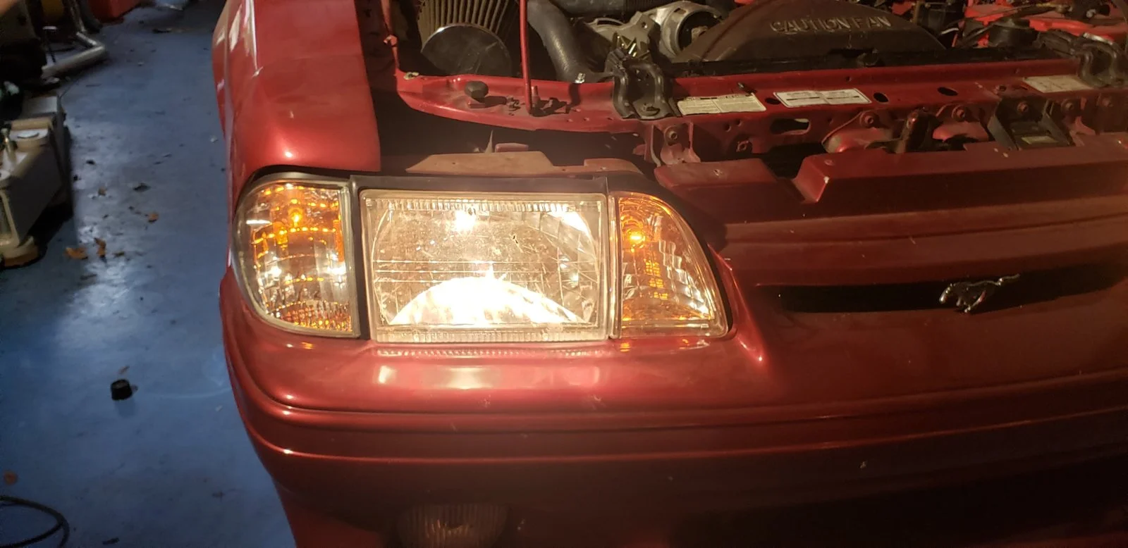

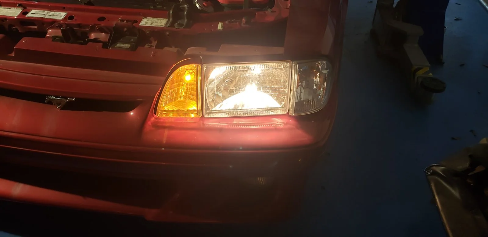

Another quick question. I mentioned that I'm having issues with the dash lights not working. Something else I noticed the other day is that the drivers side headlight and marker lights are reasonably bright, but the passengers side headlight and side markers are pretty dim. Could these two issues be related? I plan to check the connections at the bulbs, but beyond that I'm not sure what to look at next. Just start tracing wiring back?

There are little 9/32nd green bolts on the top of the core support...one on each side. They are ground wires for the headlights. If you have a bad connection it'll make the lights on that side dim. Turn the lights on and jump from the ground terminal on the battery to that wire. If the lights brighten back up you found your problem. I've had them get brighter just from loosening the screw and tightening it back down again.

What he said. Not a bad idea to take both of those off, sand the metal underneath back to bare metal, hit the terminal as well, and put it back on. Dim lights are usually a bad ground.

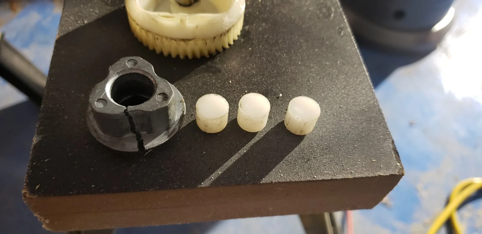

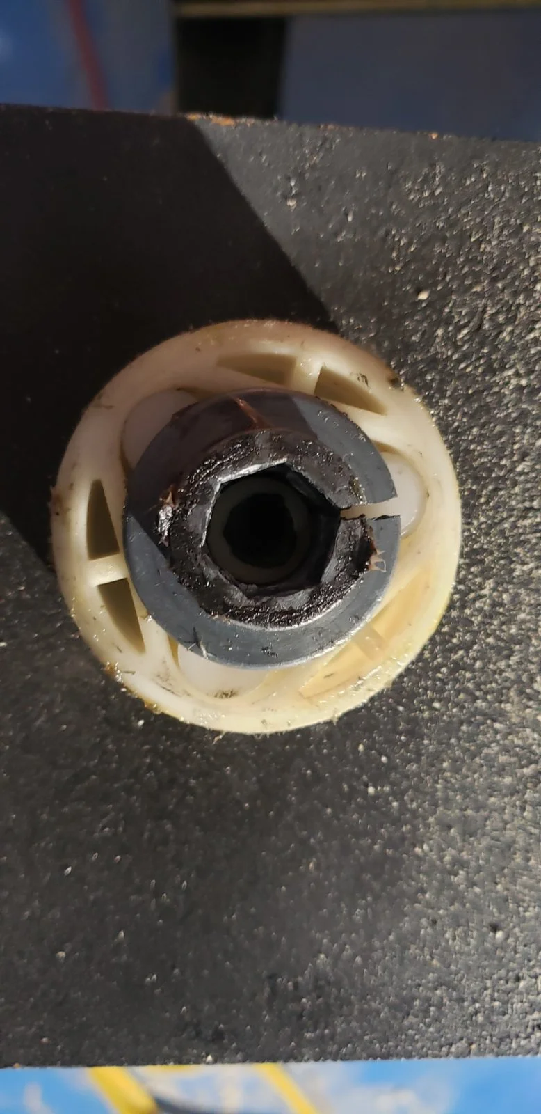

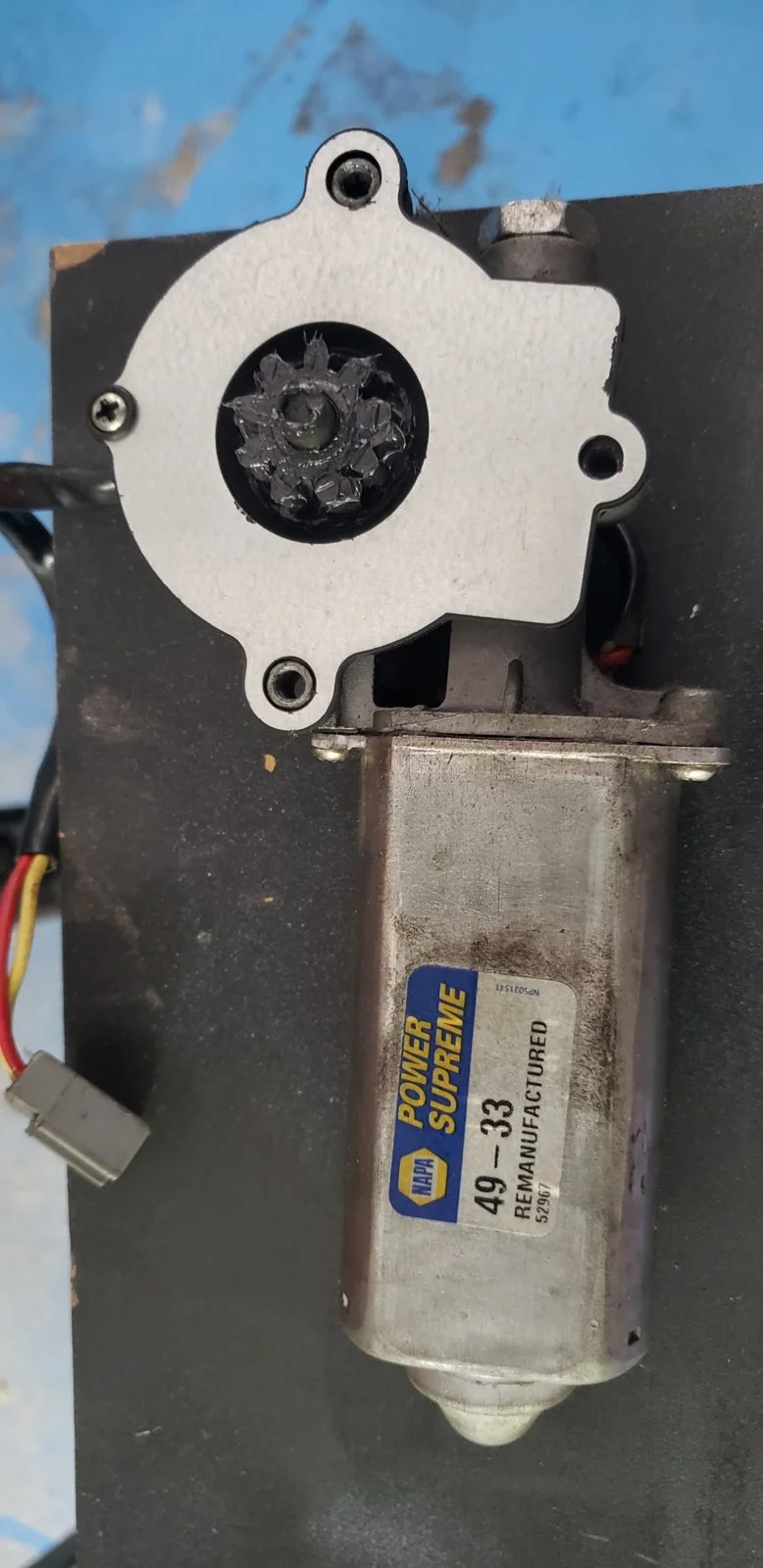

I decided to tackle the faulty drivers side window tonight. It looks like the pucks aren't my problem. Can I get just this piece or do I need a new window regulator motor?

Yeah, LMR sells the gear 'loaded', plastic gear, pucks and the drive gear like fifteen bucks.

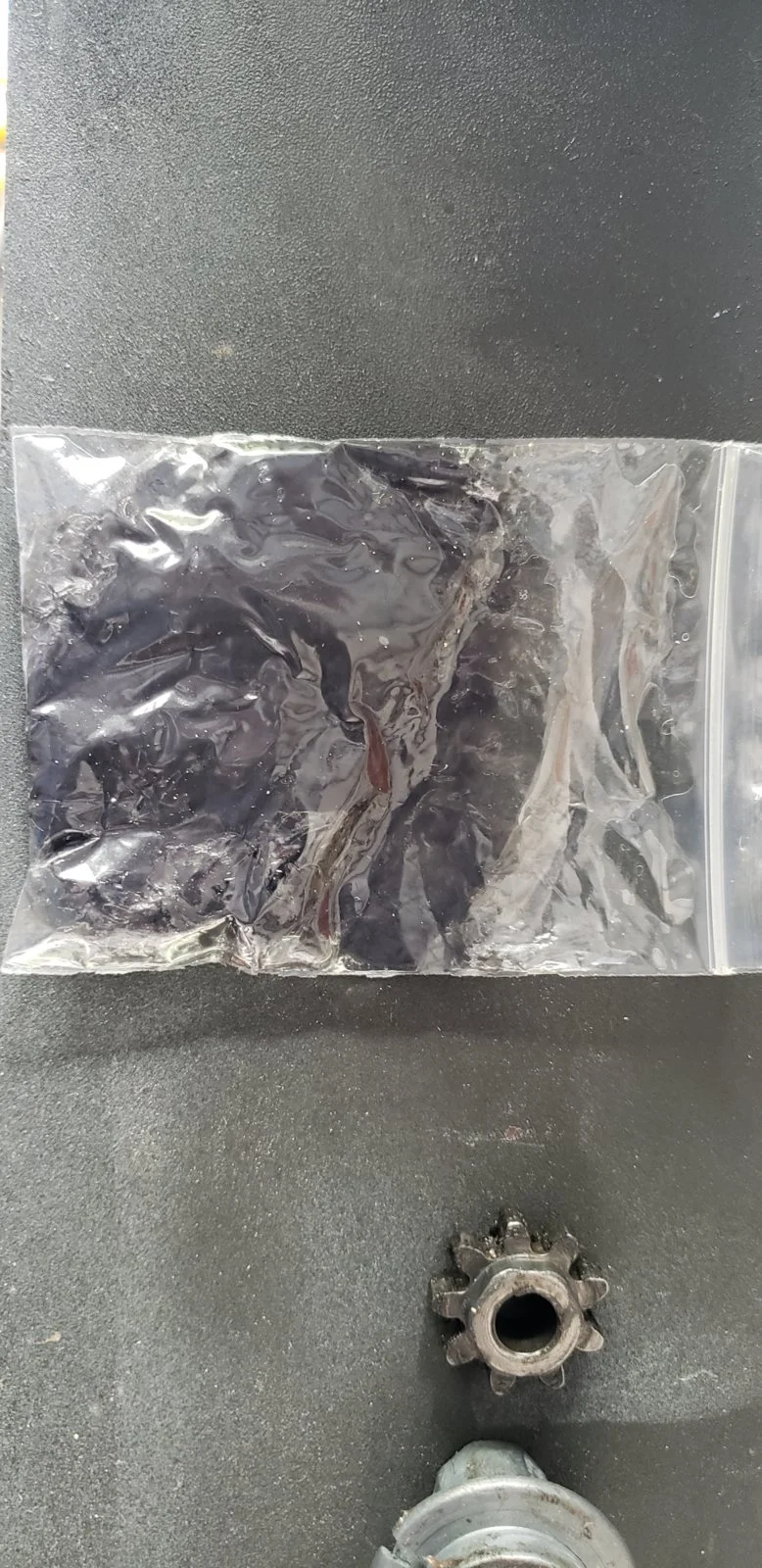

I now have a working drivers side window! I found a Dorman regulator kit at O'reilly's. It was a little more but I was able to get it today. It came with a ziplock bag of grease. I had to reuse the old larger gear. I couldn't get the new gears to go together with the pucks in it.

I pulled the ground wire for the right headlight set off of the core support. Cleaned it up and put it back together. Unfortunately it didnt help. I know I've
Got a light out on the left side. Hopefully you can see the difference in brightness.

Have you tried swapping bulbs side to side ? Check the sockets that the bulbs plug into. Should be some old crusty grease in there but no dark brown burn spots.
