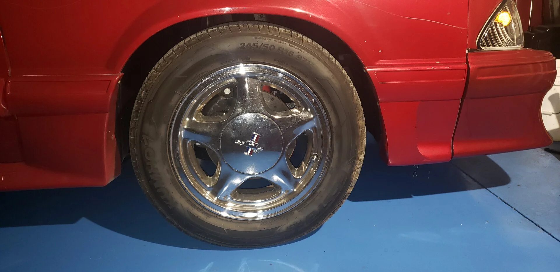

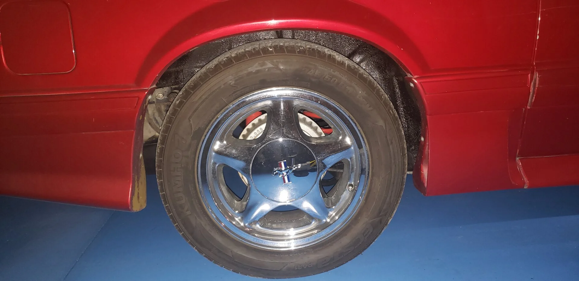

I did this today.

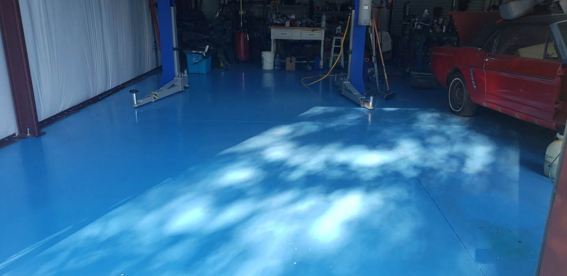

The floor in the shop was getting super dirty. Lots of Simple Green and water later and it looks a lot better.
