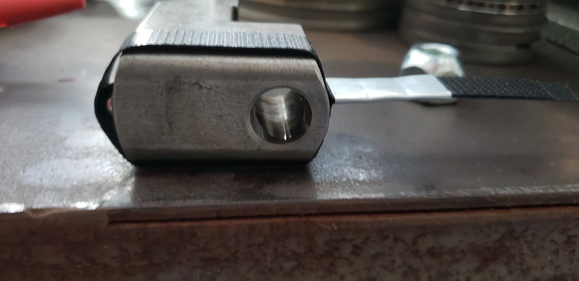

I started taking everything loose to get the tail housing off last night. I'm going to fab up some of the little strap things I made to allow me to put it back together by myself today. It should be an easy fix. Just not easy to get to! The last time I drove the car the speedometer would jump every once in a while. Not much, but it makes me think that something is moving around. I'd hate to trash one of the gears, so getting it fixed is a priority.

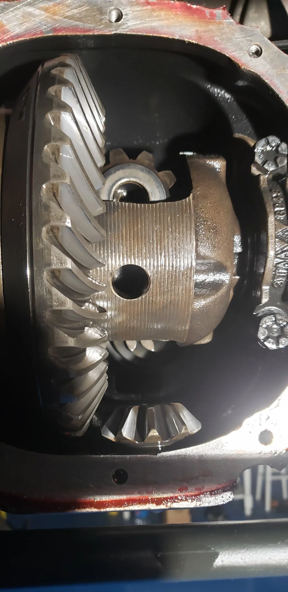

When I took the bolt loose that holds the pin going through the spiders gears in I rotated the wheel the wrong way. The pin rotated down and to the back of the axle housing. As soon as it got past the pinion gear it slid down and wedged against the housing. Pointed away from me. Not going to lie. I panicked for just a sec! I couldn't get my hand in there to move it. Eventually I did get it to move and it was no problem after that.

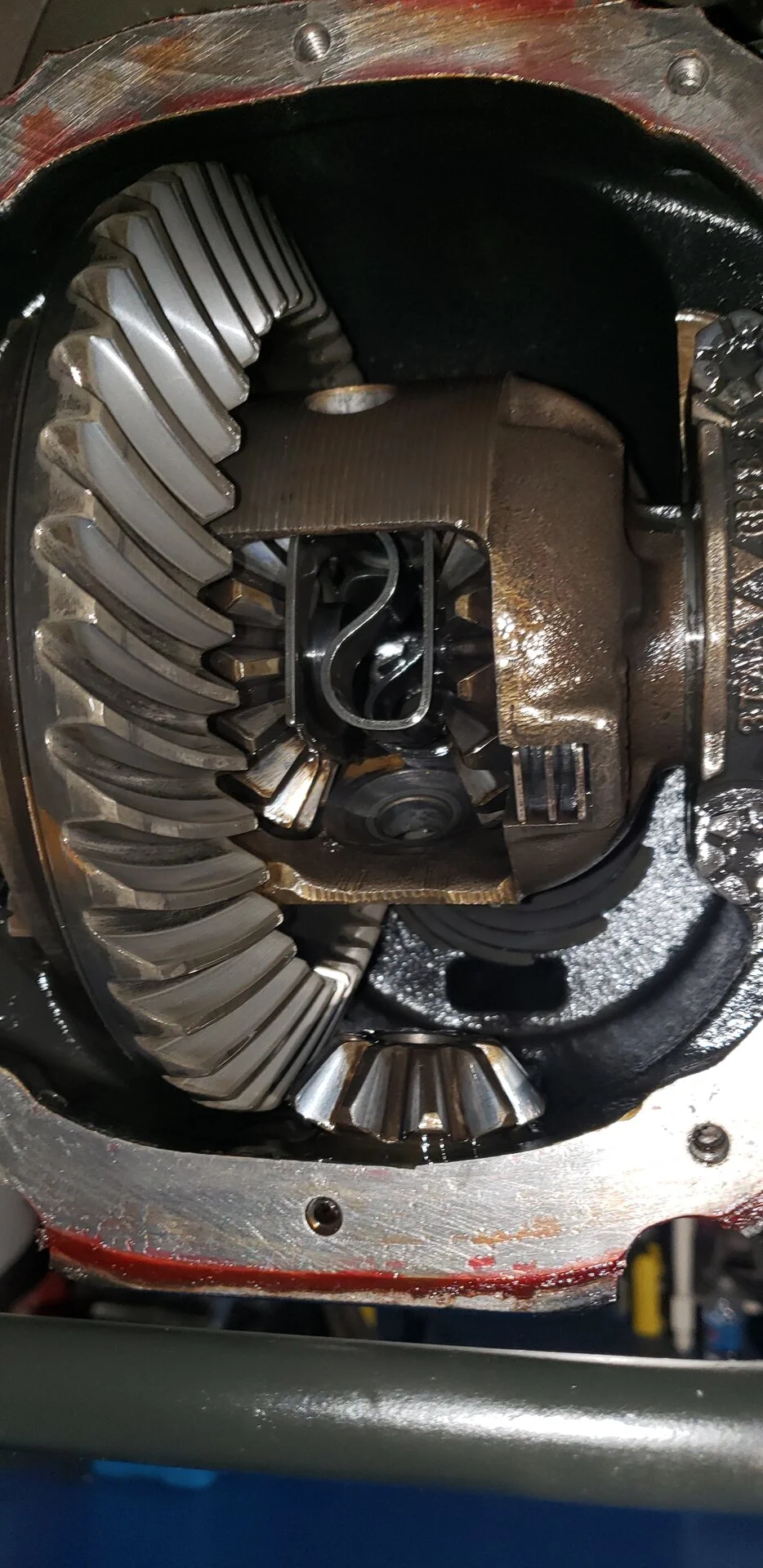

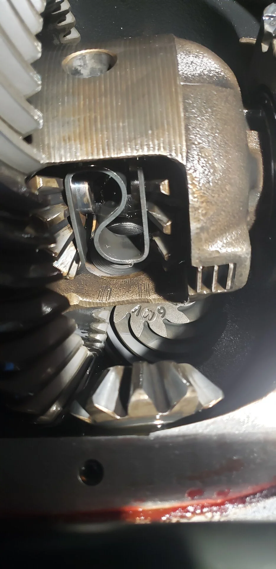

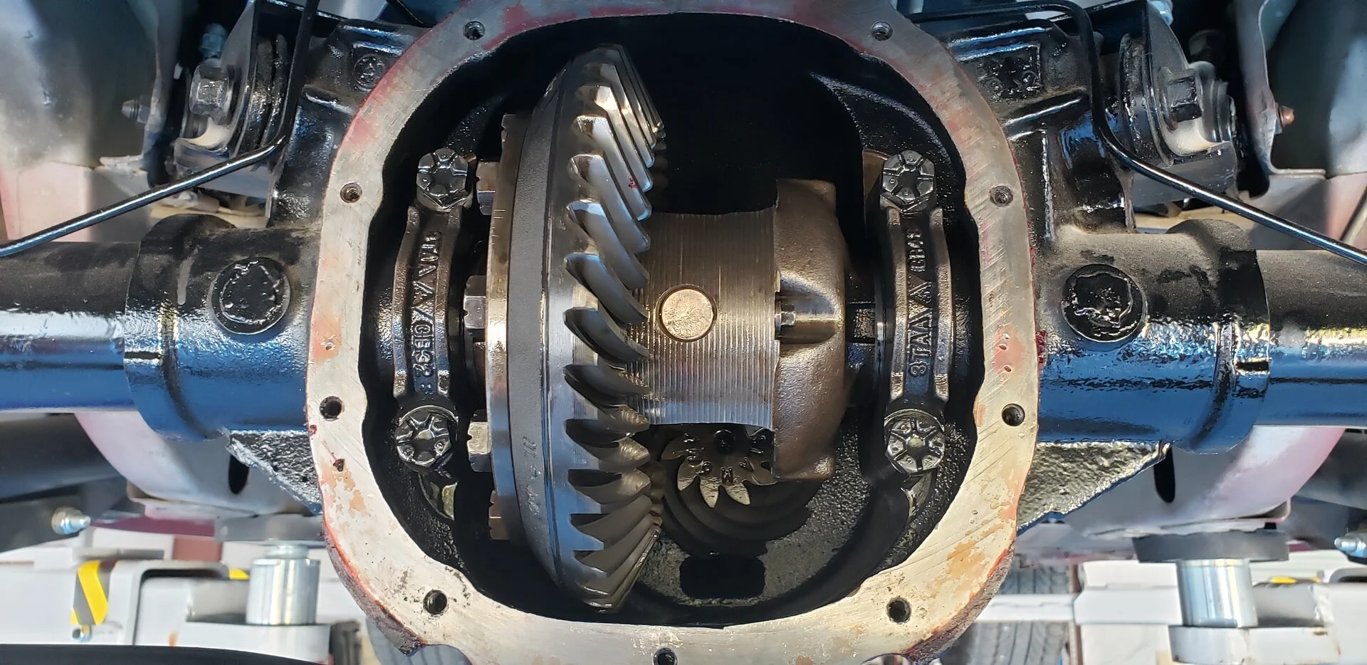

The spider gear didnt just fall out everything shifted. The holes are all out of line. I cant put the gear back in. The other gear is about to fall out. I'm not sure why everything shifted. I cant get it to move back. I'm going to start researching how to fix this. What do I need to do?
Spin the wheel until the windows to the S clip are positioned up and down. Place the spider gear and shim up top....hold the other spacer and gear at the bottom. Slowly rotate the wheel and they should walk themselves in. Do this process slowly making sure the spacers stay on the spider gears. When the holes for the pin lines up install the big pin and the pin bolt.

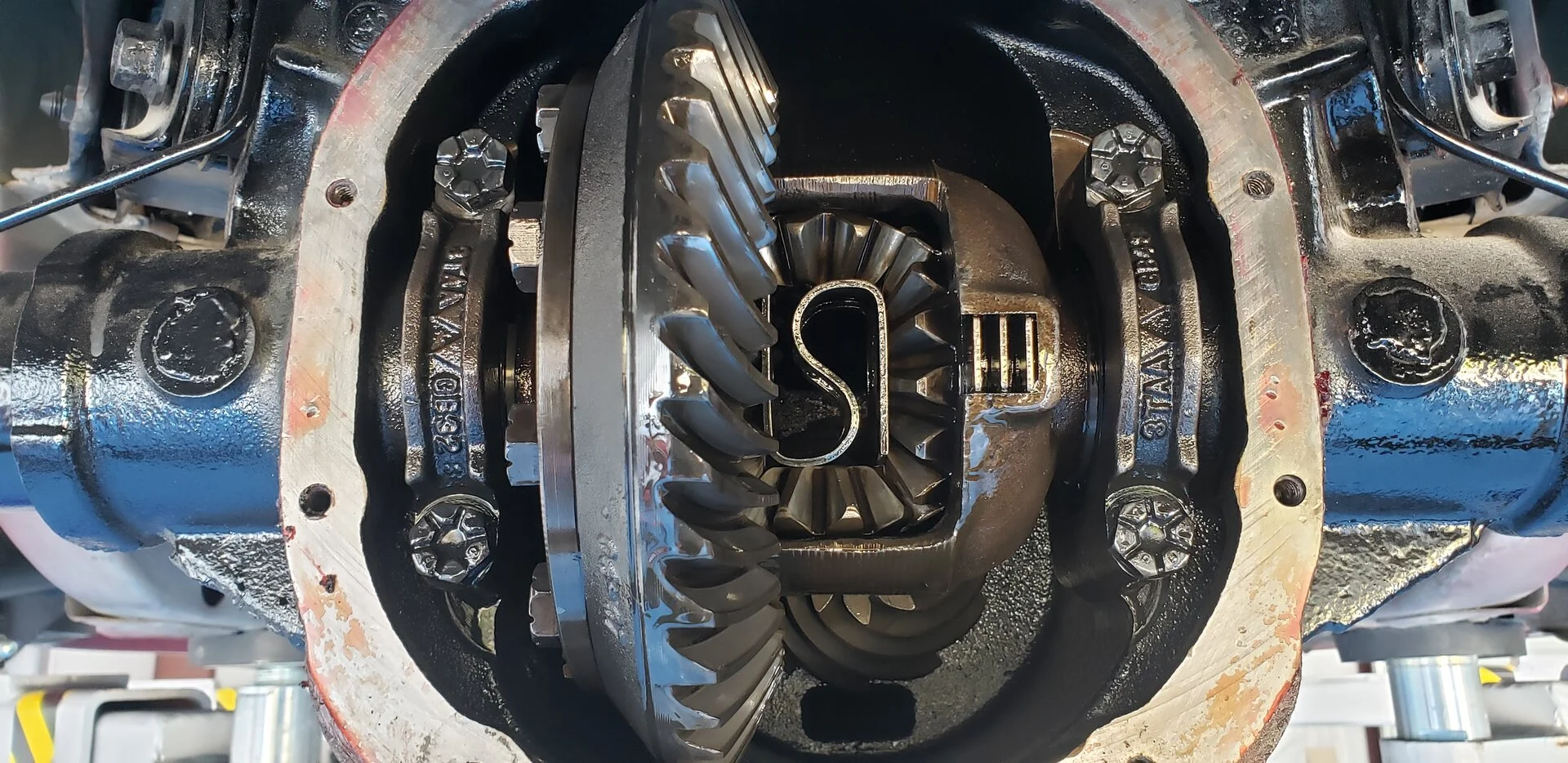

Thanks @90sickfox ! I was looking at some similar videos last night. In that video it seems a bit easier because that diff doesn't have the S spring thing in it. I was trying to get the gears to rotate last night and not having a lot of success. I figured it best to stop while I was ahead and try again today with better light and no beers.

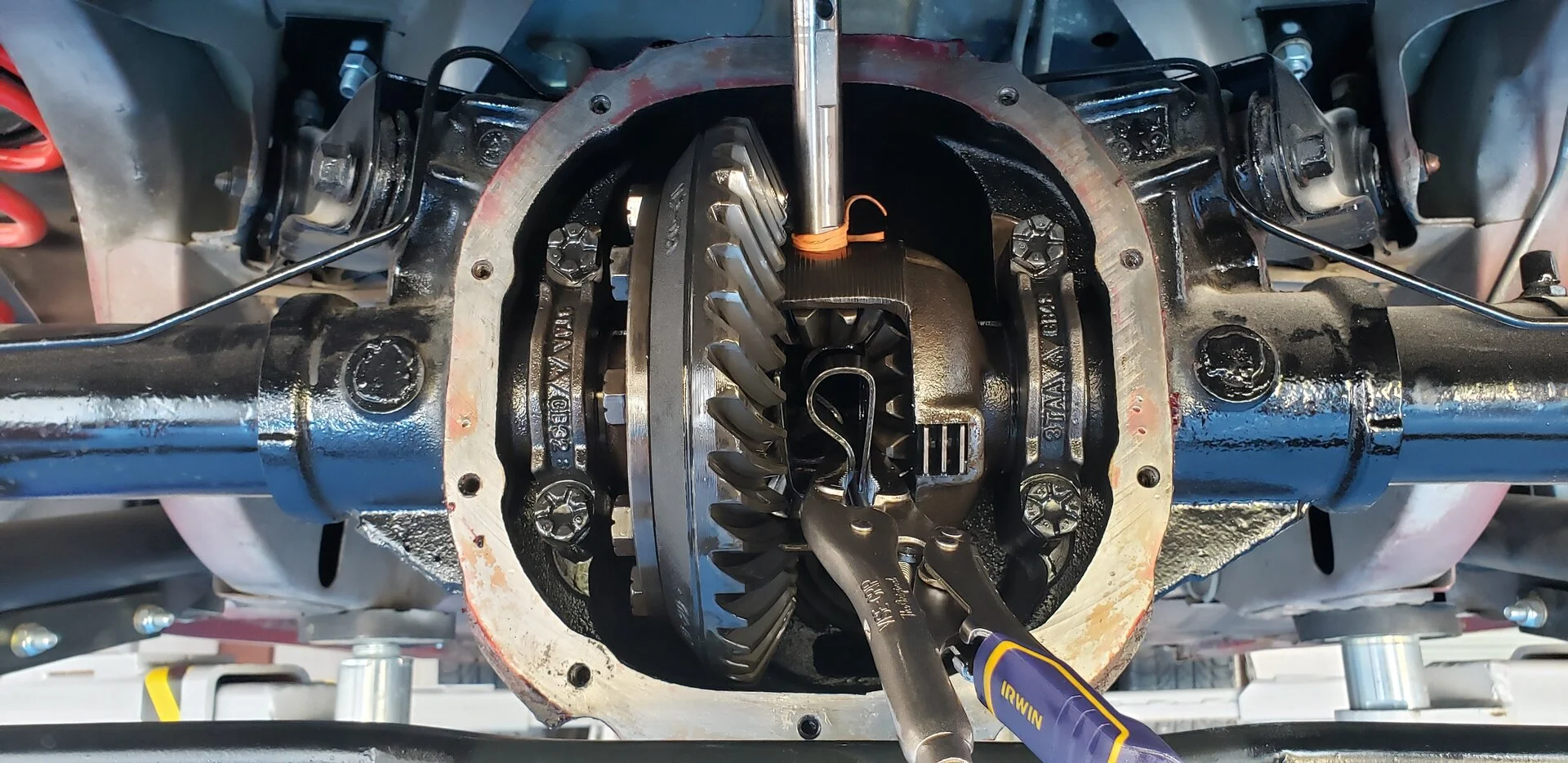

I probably did this the hard way, but it's done now. After removing the S spring I was able to get the spider gears to rotate. Then using some stubborn determination I was able to get the spring back in and everything put back together. Seems like a lot of extra work just to change a wheel stud!

Once I got it apart the hardest part of putting it back together was the S spring. Clamping it with long needle nose pliers helped a lot to get it started. Using a rubber band on the pin through the spider gears was a bit help. If you look at the first pic you will see what I'm talking about. Doing it that way kept the gears from moving while my novice ass beat the S spring into place. Otherwise the pin would just fall through the gears. Doing this made me feel a lot better about the prospect of having to do clutches.

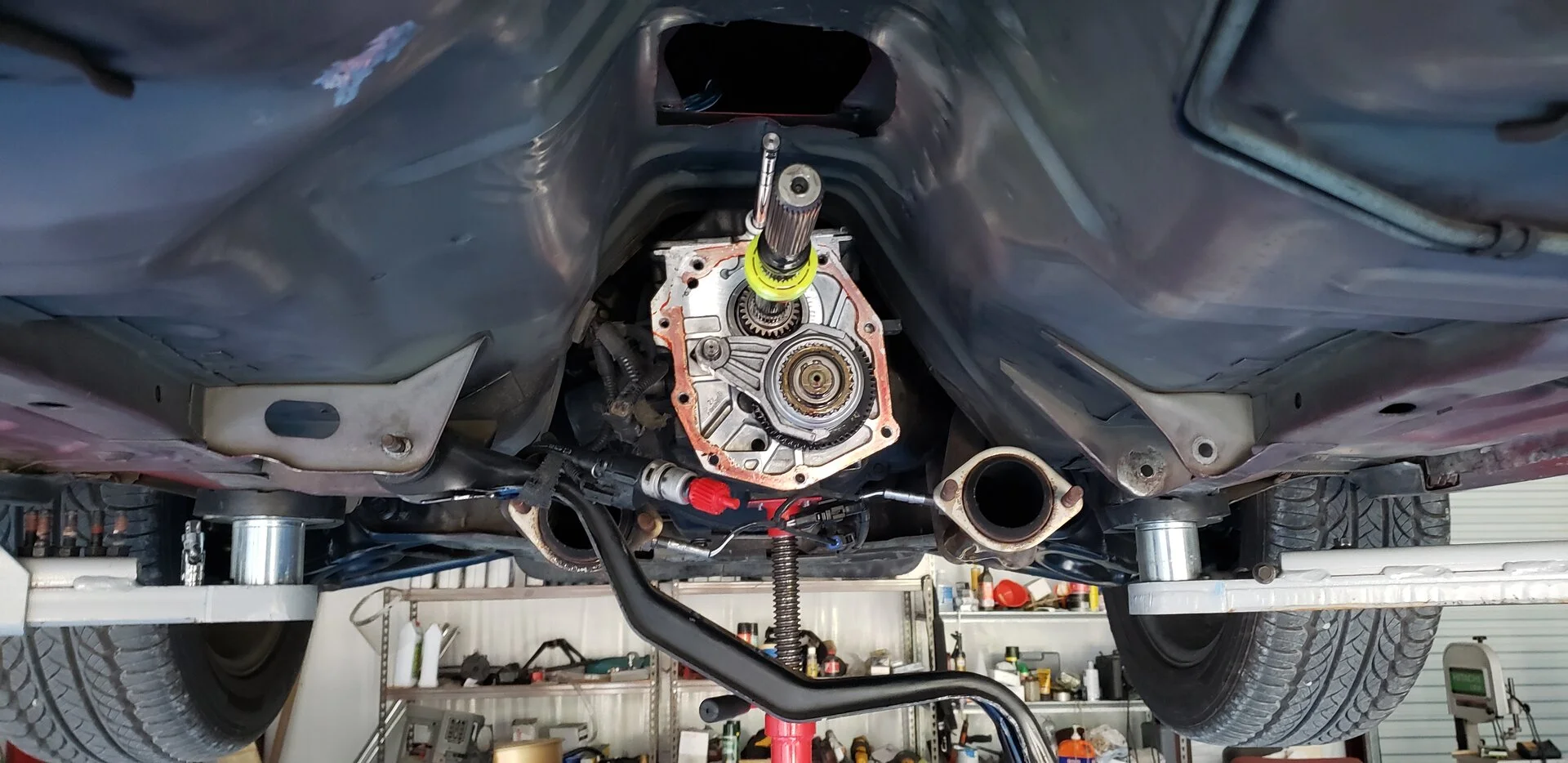

I got the housing off this afternoon. Thus is a familiar sight.

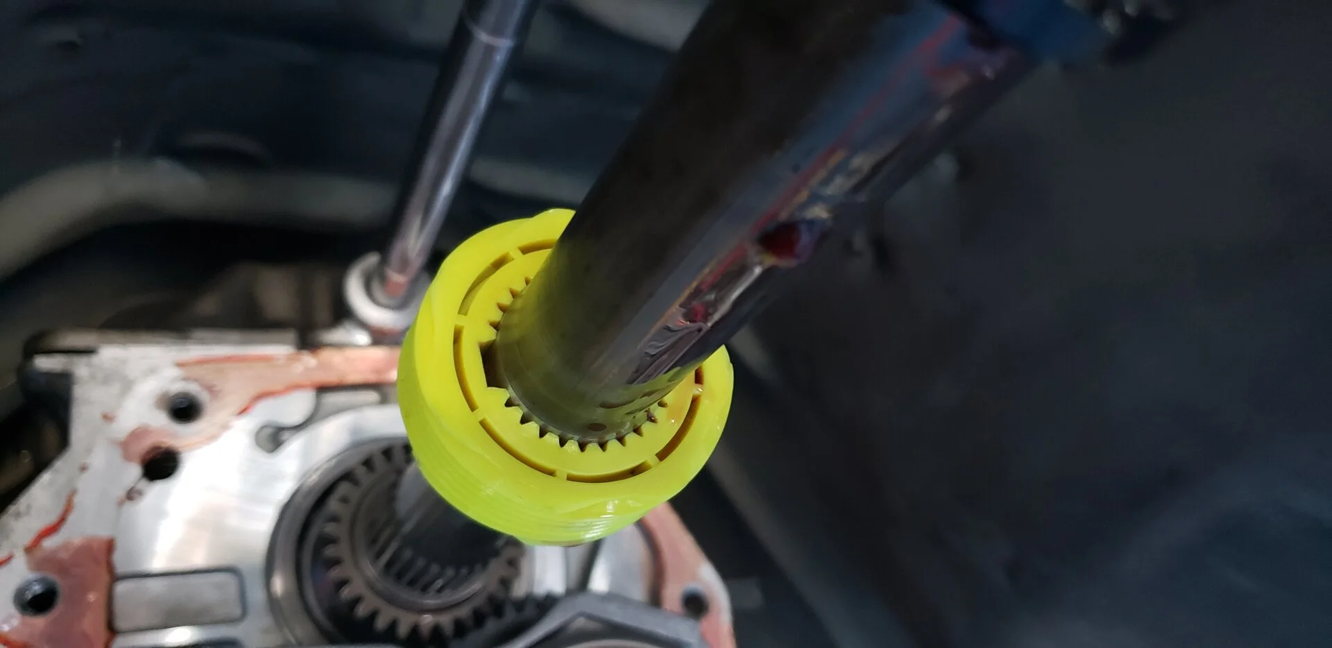

I made another little helper to reinstall the shifter shuttle.
And the issue. It appears that the little spring retainer that holds the speedometer gear on the output shaft is missing.
When I ordered these gears the new retainer was broken so I had to reuse the old one. At least that's the way I remember it. I'm going to contact LMR tomorrow to see if I can get a replacement retainer. Does anyone know a better way or alternative?
Ideally brand new retainer clip for each install. They break easily that usually the act of removing them fatigues them enough.
As a rule. Don’t reused any c-clips or snap rings or clips in a t5. Once you remove them, trash them.
5th gear snap ring is one that typically stretches and fails leaving you with no 5th gear
