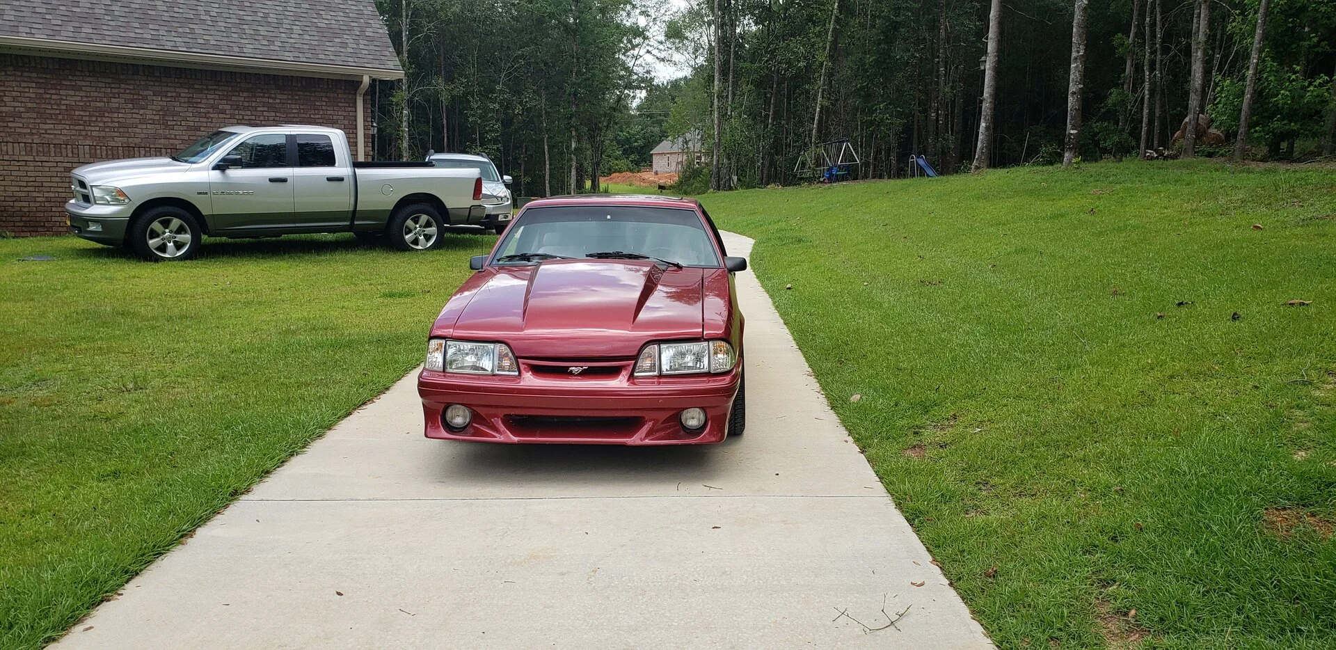

Not a lot to report. Had a busy weekend with friends in for the holidays. I did get the car out a little. The brake noise now only happens when applying the brake. So, there's that. I did take this pic of the car. I think I have brought this up before in this thread. As far as I can tell the car is straight, but the front of the car is crooked as hell! Looking at it from the front all the gaps open up as you get closer to the left side of the car, right side looking at it from the front.
The fenders have a good bit of adjustment to them so maybe someone had it off and didn't put the time in to get it adjusted perfectly like they should have? perhaps that side is lacking a spacer it once had as well. Eitherway poke around and you'll see stuff that will raise a red flag it was hit and not put back together right.
Tell tale signs are
Gaps where fender and cowel meet, are they uneven or one gap wider than the other
look closely at the lower radiator support, is it straight?
Mine took a hit there once (before I got it) so mine is slightly tweeked.
It's hard to really see some damage with the fenders on.
