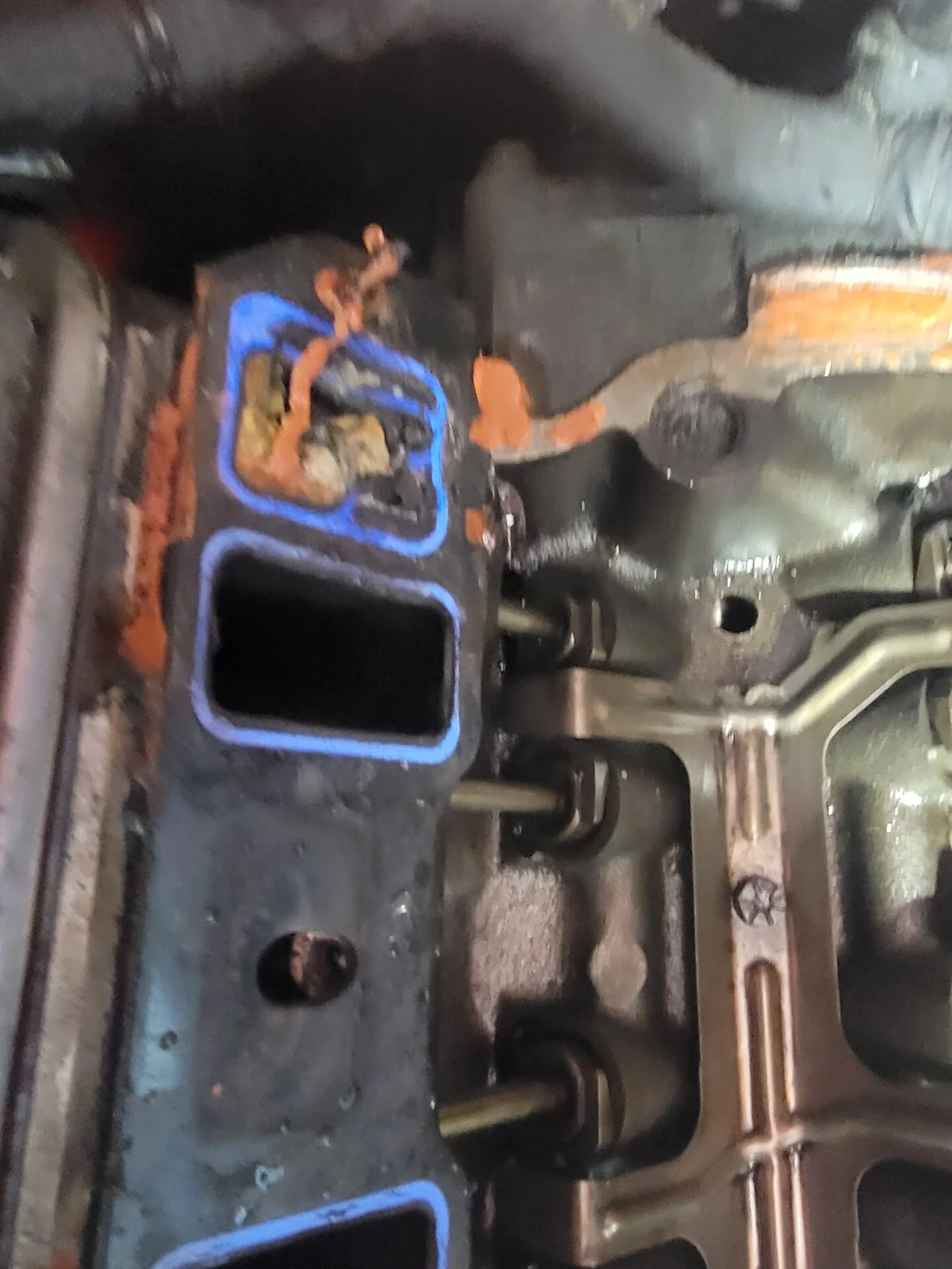

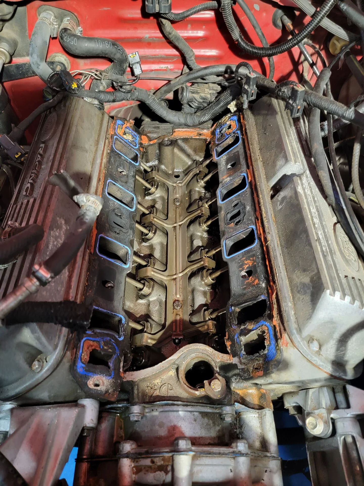

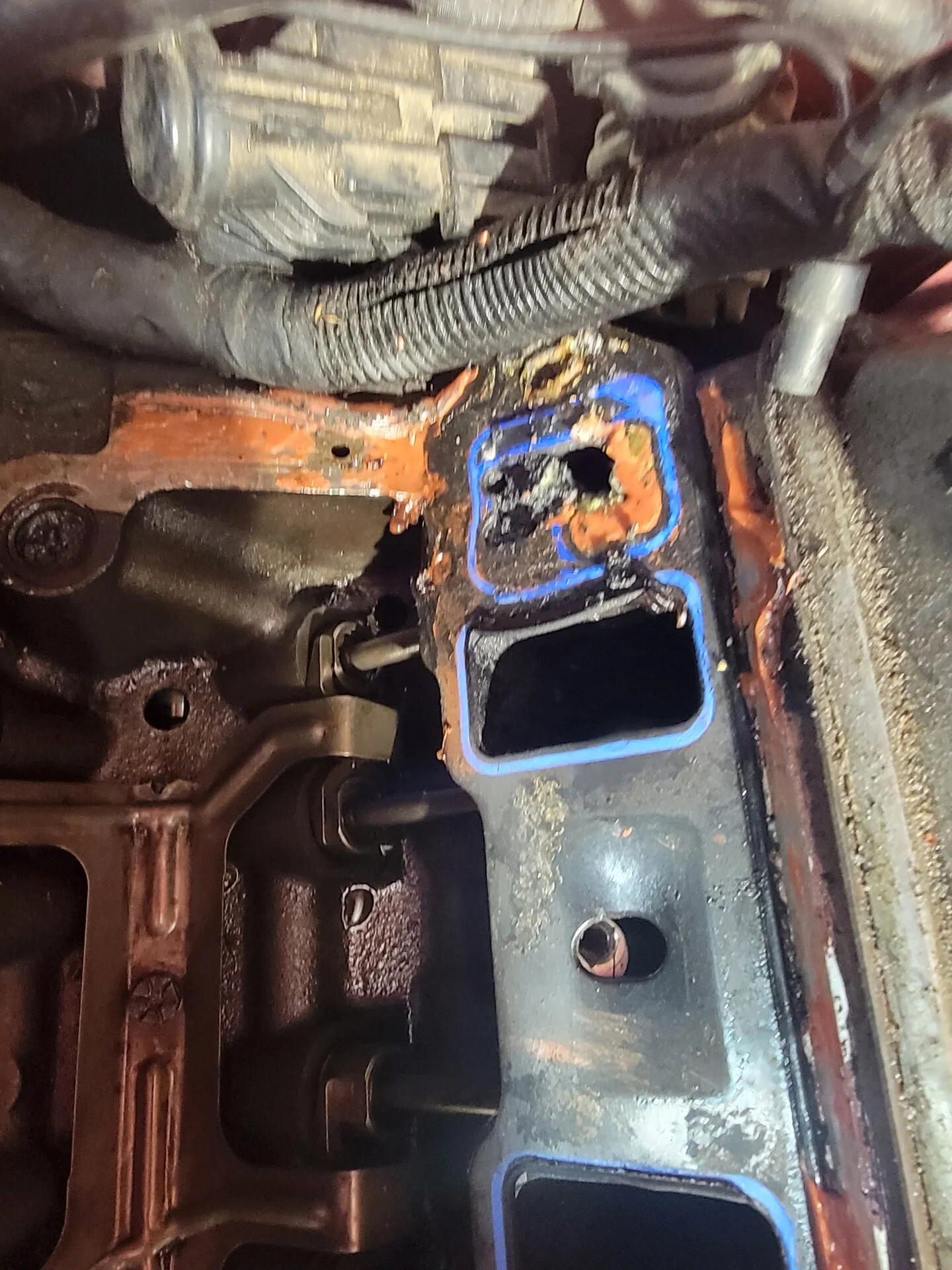

The lower intake is now off. Now that it is off it appears that even if it wasn't the issue the gaskets really did need to be changed regardless. It was only a matter of time. I found a couple of issues along the way as well that I wasn't aware of. First, there was no gasket between the throttle body and the upper intake. Not sure why, but I'll get a new one. Second, the PCV valve has vanished! I installed one back there, but it is gone. I'll have to get a new one of those as well. Also of note is the crud in the block where the water enters the lower intake. I'll do my best to clean that up as well.
I'm guessing I need to do some kind of coolant system flush. The new thermostat housing that I installed is also rusting. I'm not running straight water in this thing. Its the green premixed stuff you get at the parts store. It's currently in the shop with a towel over the motor to keep stuff out of it. How hard is it to replace the wiring harness ends where it plugs into the injectors? All of mine are broke and a few were just barely holding on. In that vain I'll just go ahead and ask if anyone knows where to buy new harness plugs?

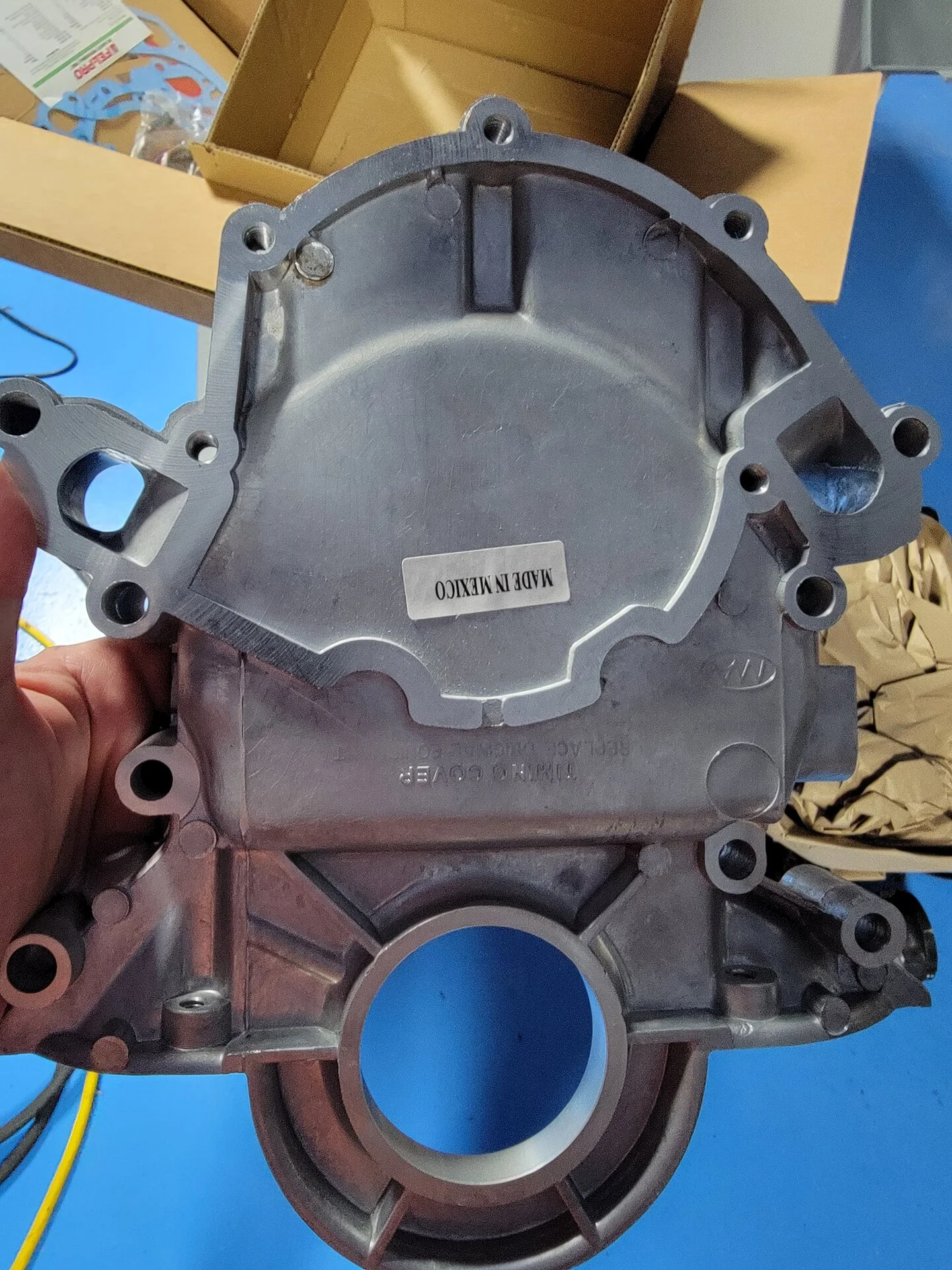

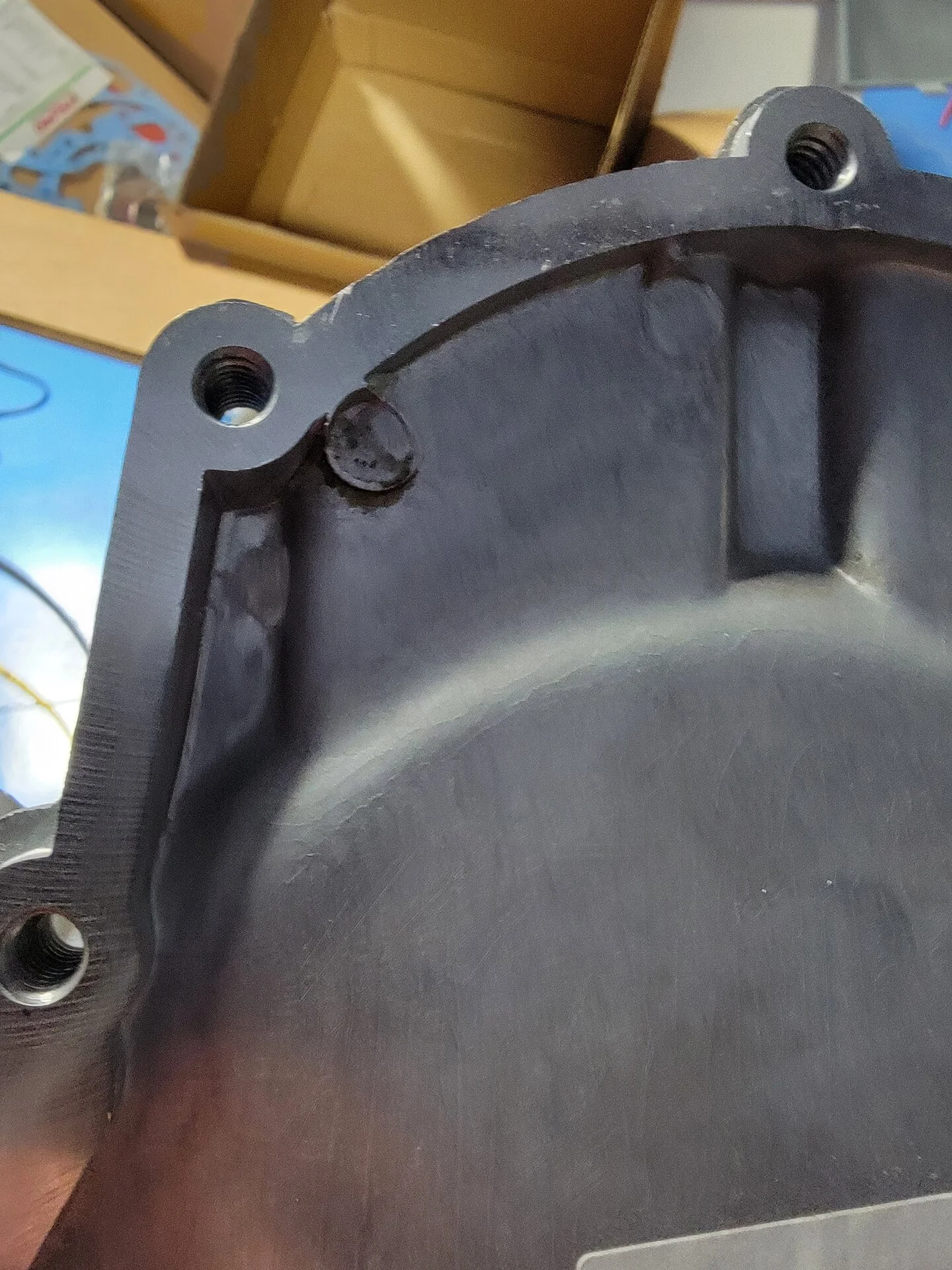

The timing chain cover came in the other day. I'm going to wait to put it on until after I get finished with the intake. If I dont need to change it I'll just put it on the shelf for another project. I though I would share some pics of the new cover. Over all it seems like an alright unit. It is not nearly as nice as an original unit. You tell the casting is done cheaper. There are lots of sharp edges and places where there is extra material from again poor casting. It also says replacement cover on the front of it just in case the next guy was wondering. All of the above is also part of the reason I'm not in a hurry to put it on my car. I think it would work just fine. I just dont like the way it looks.

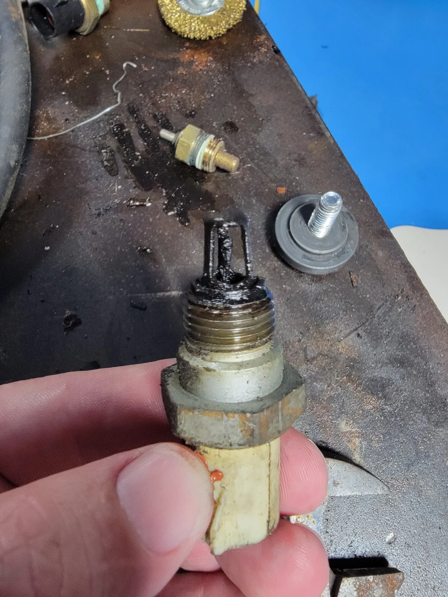

I pulled the sensor off of the lower intake over the weekend, got a big barrel, filled it with water to cover the two halves of the intake and lit a fire under it! Exciting stuff. I put Dawn soap in the water as well. Did a decent job of cleaning everything up. I wanted to share a picture of the inlet air sensor I pulled off of the lower. I replaced it not that many miles ago, and this is what it looked like.
I'm going to clean it up before reinstalling it, but is this normal? I have a mission for the car and need it running at the beginning of next year. After that I plan to start digging into it and trying to figure out if it's just old gaskets and such that need to be replaced to help it run better or if it is just time for a rebuild. If I had to bet money or what I'm going to end up having to do my money would be on a rebuild. That wouldn't be the end of the world. Just time and money.

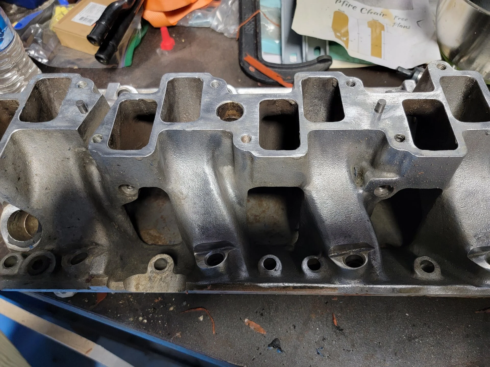

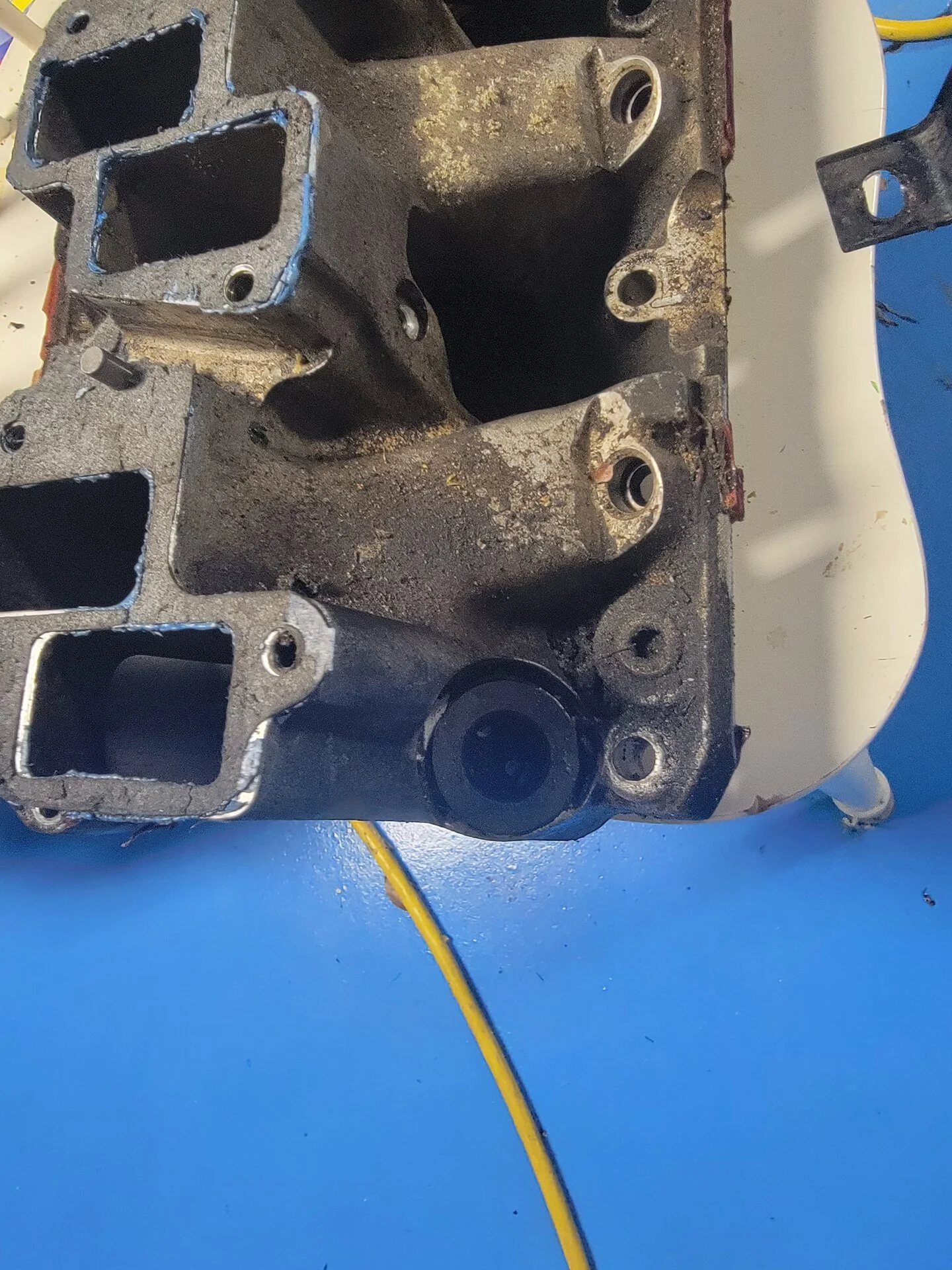

I'm slowly getting the lower half of the intake cleaned up. I think its coming along nice.
I'm using a wire wheel to get to the easy stuff. I'm thinking about ordering some of these to clean between the runners.
The plan would be to cut the loop off of the end of the brush and use the drill to spin it. I'm not trying to make it look new. Just better than it is. If/when I pull the motor to freshen it up I'll take the time to clean the whole bay. I probably wont even put this intake back on the motor at that point. As a matter of fact how do you guys think this intake compares to an Elelbrock intake? There is a guy in town that might do some horse trading with me with this intake. He sells Fox body parts. Just a thought.

What intake is this? If it is a stock one, (the lower looks wrong to me), one of the Edelbrock intakes will flow better at a higher RPM range. But if they are imported stock heads. The gain will not be that great. A ported stock one (that someone is looking to get rid of an extra), or ported Explorer will be a better power range match.
This is a BBK SSI intake. I found a thread earlier about how this intake has an issue with the poorly designed fuel crossover line. My intake doesn't seem to have that issue. This intake will stay on the car until the car until it does a thing, more on that next year. At a later date I do want to change it to something else.
