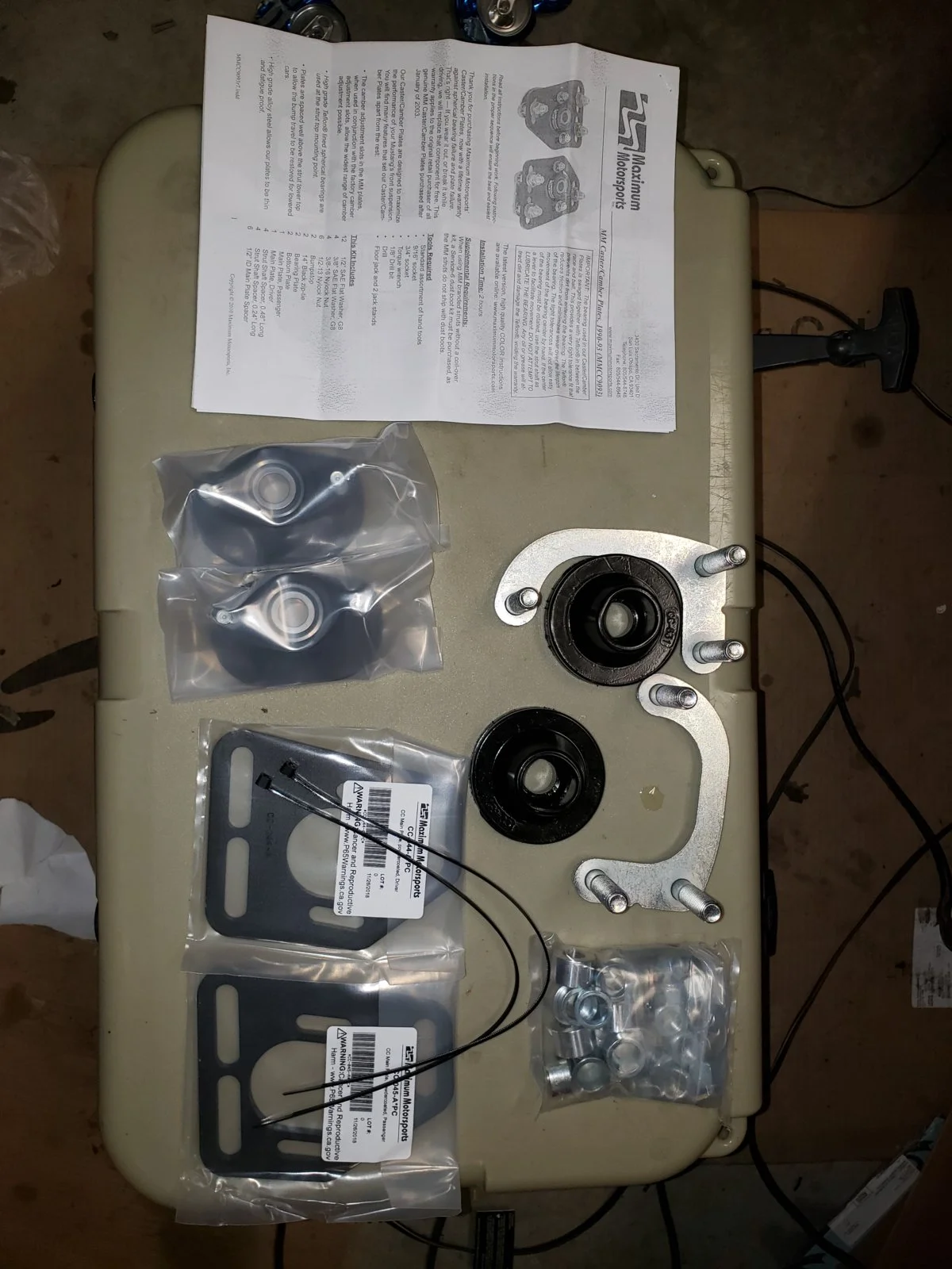

CC plates came in today!

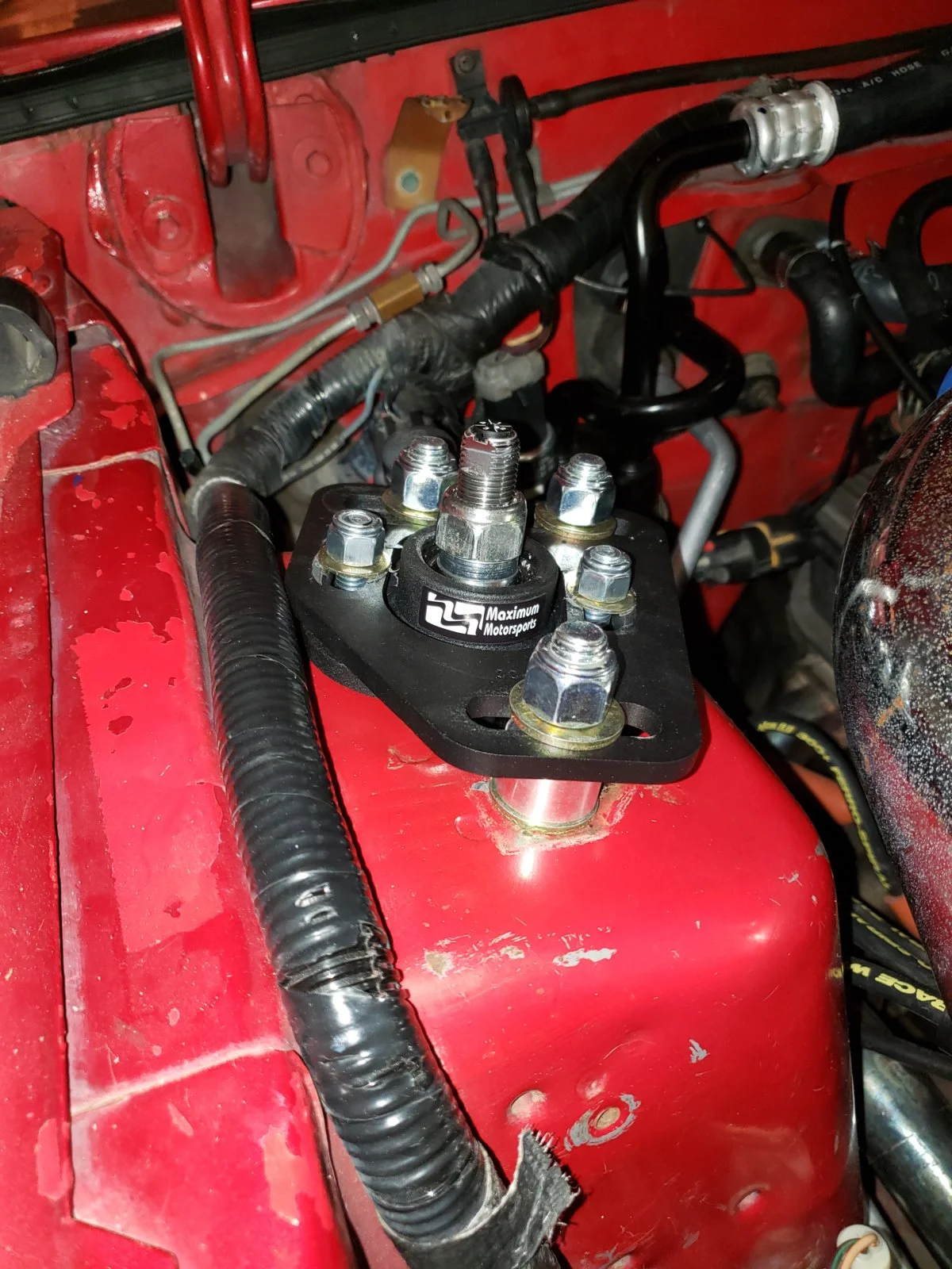

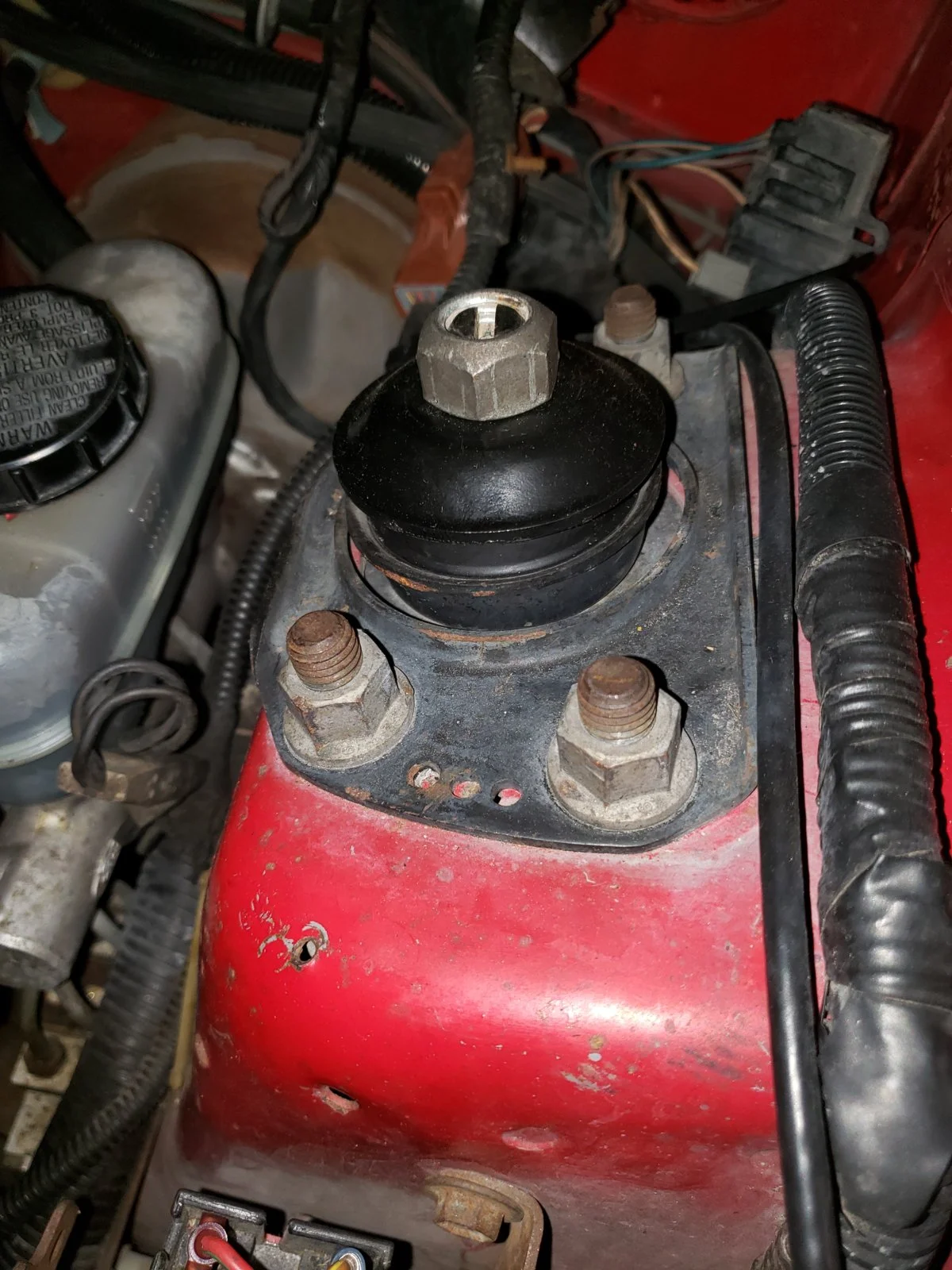

Started installing the Maximum CC plates tonight. I bought a set of Monroe struts off of Rock Auto to replace the old units that came on the car. They were inexpensive. Anyway, they fit fine but not with the CC plates. This is what the factory CC plate looks like with Monroe strut.

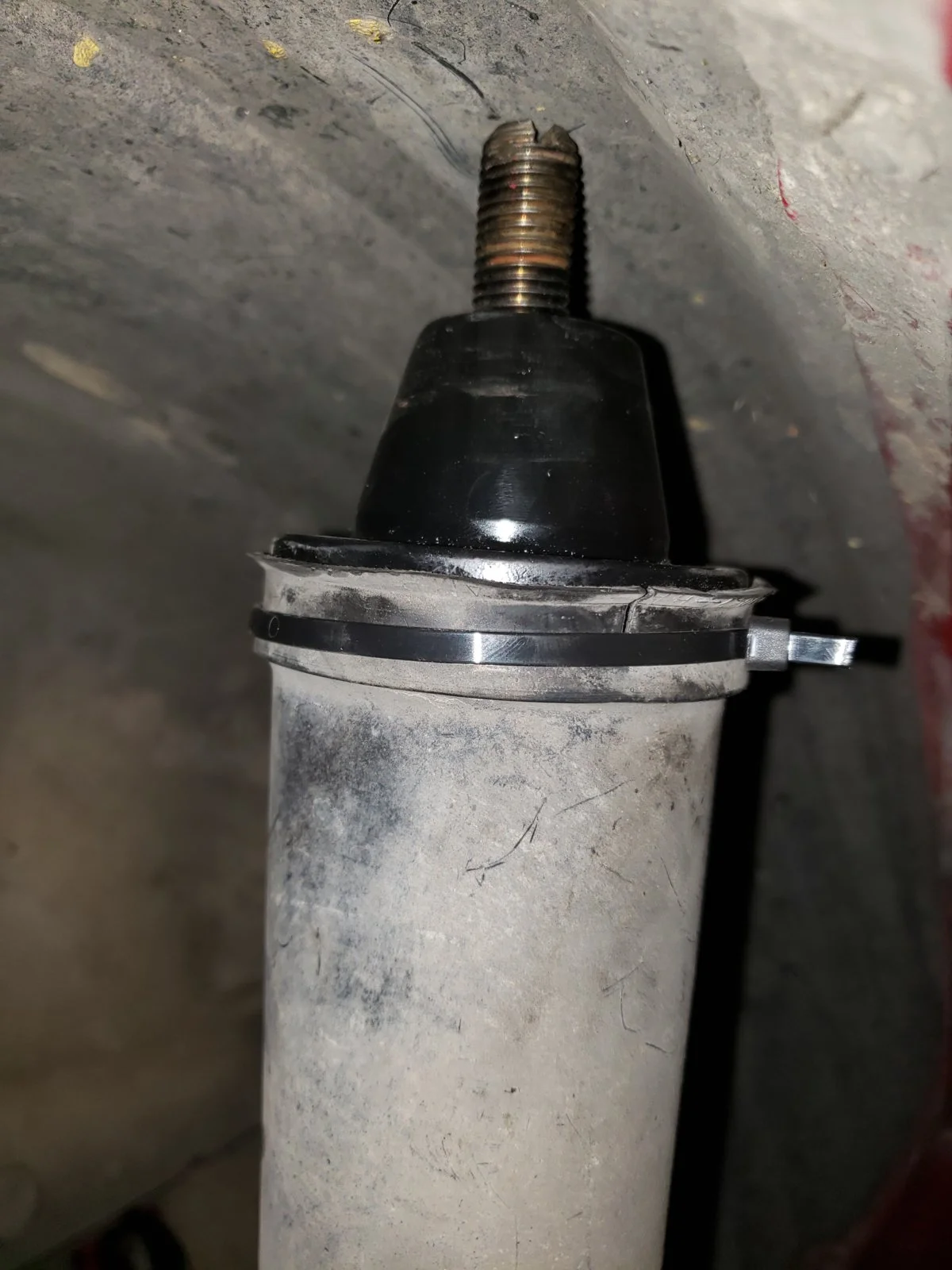

When I put the MM plate on this is what i ended up with.
I tried thaking a spacer out but it was still to short. Has anyone else had this problem? What front struts would you guys suggest?

Called MM today. Super nice guys by the way! They said I wasn't the first person to run into this issue using Monroe struts. They suggest KYB as a decent strut for my application. I really dont want to spend $500 on struts right now.
I ordered two KYB 734013 AXG manually adjustable struts from Rock Auto.

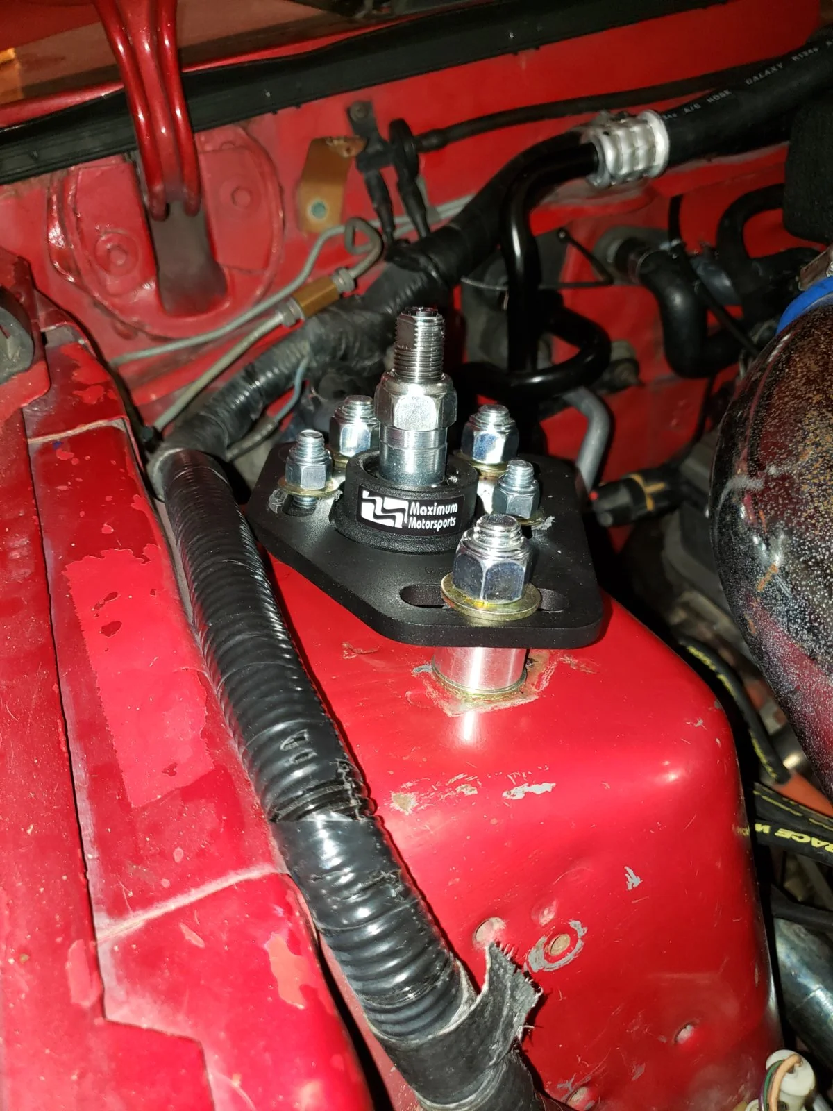

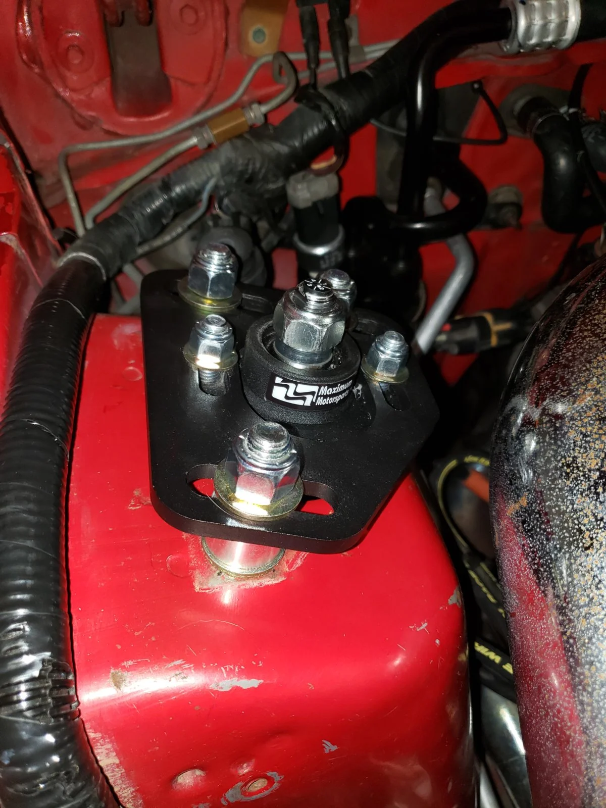

They seem to be cut down to where they let the car sit lower. I'm also installing the camber plates. Does this look right?
I'm thinking about moving the .5 inch bushing from the top of the camber plate to the bottom of the plate. I need to get the other side on along with wheels so I can drop the car and see how it sits.
I always put the 1/2 spacer on the bottom...looks neater to me. The technical thing is to compensate for suspension drop at the strut mount. As the suspension goes down that rod goes further into the strut....so technically....the spacer would go on the top. With stiffer lowering springs I doubt you'll ever reach the internal limits of the strut. I never have and neither have my customers. I always put the spacer on the bottom to avoid hood clearance issues and the look of that nut sitting on top the spacer.

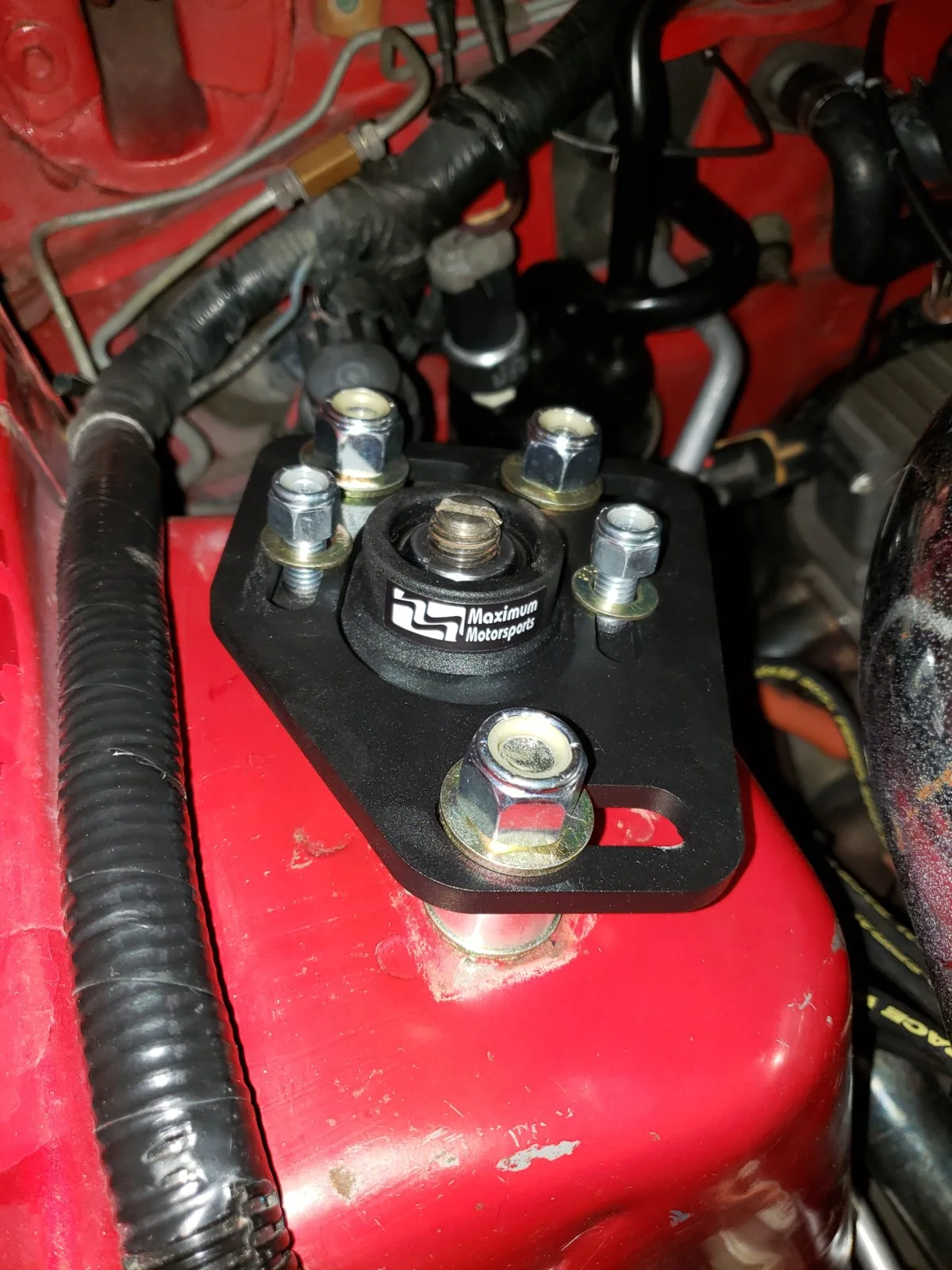

Both CC plates are in. Most importantly they are installed correctly. In the last pic the plat was upside down!
