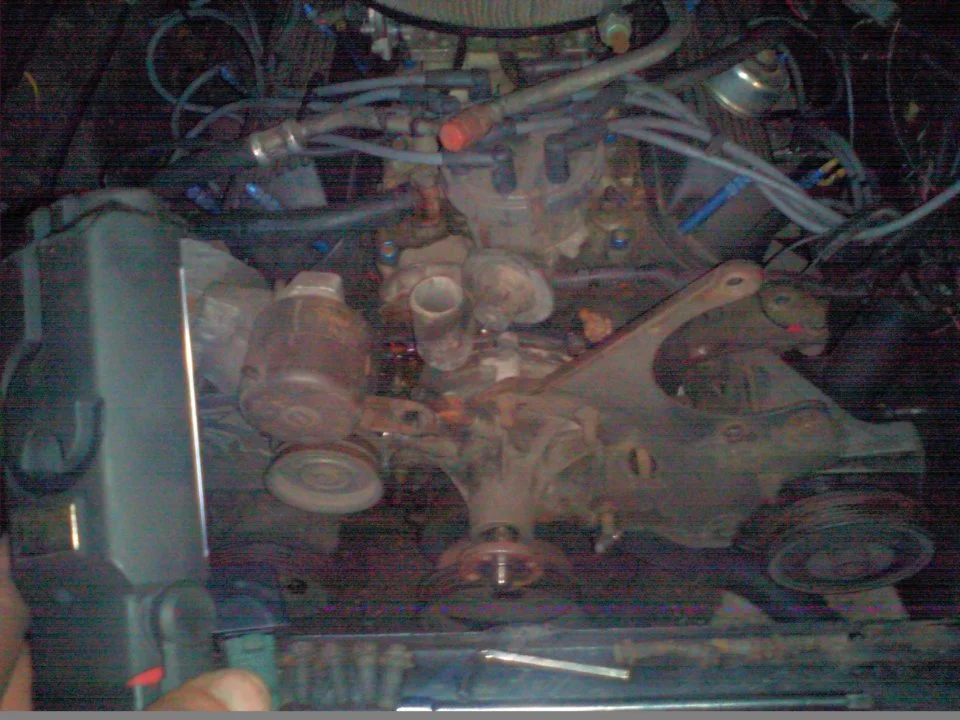

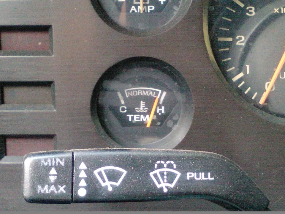

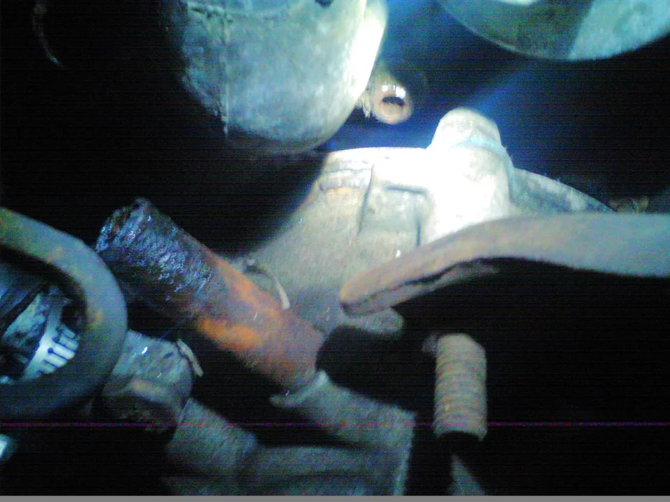

I an currently mid project. And yes at 10pm outside. Hince the bad pictures. Anyone else ever have to deal with the Allan key bolt holding the thermostat housing on? I am having difficulties getting that off. Allen key stripped it which didn't surprise me. Vise grips keep slipping when their as tight as I could get them. Which as you can tell the ac compresser is removed for access from the side. (Compresser is froze up and no freon so no big deal. A later project that isn't necessary until the car can be driven) the car has approx 40 miles on it in the last month. Otherwise the last mike was in December 2003. It's day awhile. It didn't have any issues overheating in 03. To the best of my knowledge there's no thermostat right now. Otherwise it froze open. My issue at the moment keeping it from being driven is it doesn't stop heating up. With the motor almost running right finally it's Gotton better. It. Stays in the n in normal for a little while then rises somewhat quickly to between r and m. Still good, right where I imagine it's good. It status for a little bit then rises again. The hottest it's got is the a. My hope for fixing this was to put a new thermostat in and back flush it.. My dilemma at the moment is how can I get that Allen key bolt out? Any suggestions, its on there tight. Thank you in advance for any advice.. Oh yeah I put some white paint on the bolt to make sure it wasn't turning. It also helps with the pic from low light

I was afraid the drill would come up lol. The water pump is in the way to get straight with a drill bit. Other then that the radiator could come out and there is room for the drill. I question the punch and a hammer to knock it around to take the bolt out if I can find somewhere it could grab that I can get to. I have up about 20 minutes ago. Put tools up and I sprayed it with wd40
Did not mean to submit that quite yet. I did soak it in wd40 which is all I have at the moment. My roommate used my pb blaster awhile ago to start a fire since he doesn't know how to start a fire. Im hoping it will help loosen it up some by tomorrow
Get a propane torch and heat the aluminum around the bolt...not red hot but hot. Thats not the original bolt...I don't think. Never seen a factory allen there. I've used a torx head bit just a little bigger than the allen head and a quarter inch wrench to remove by stubborn bolts...tap the bit in with a hammer... Put the wrench on the torx bit and pull lol. Sometimes it works. A little heat some wd40 and some taps with a hammer go a long way.
Is there a chance that if I put it back together and flush the system that it will run like it did before with no thermostat and not overheat. I know there's no 100% answer to that. I don't have a heat source or any more paitience left with the car right now. No willing help nearby. No more money left and no shop that I can trust. That's the only thing I have left that I can do is flush it. That I can think of. It's got flow and pressure in the system. Only one small leak that's I may be able to fix. It just flows all the time and doesn't stop warming up

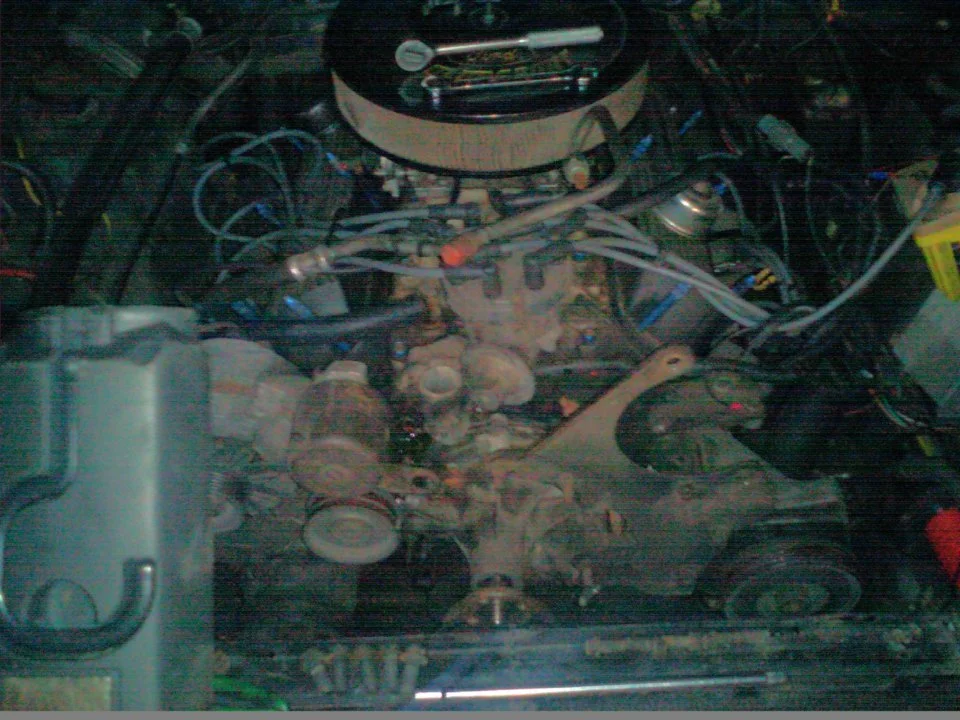

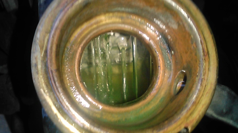

Just a update. I couldn't get any luck with the bolt so I put it all back together and went ahead and back flushed the system. Took it for a ride and all seems to be good. Still want to put a thermostat in but for now it's drivable. Im gonna keep a close eye on the gauge and and maybe this weekend get to my buddies house. He knows how to weld alote better then me. Until he looks at it he thinks he can weld a nut onto the end to get it out. And put a new normal hex bolt in. I had the other bolt started to come out the other day before I realized the 2nd bolt was a Allen key and decided I didn't have the time to get that deep. So I know that was properly tightenedand will come out eeasily. I plan to wake the neighborhood tomorrow morning just before 6am and bring it to work tomorrow. Hope that goes well lol. Thank you again for your assistance. If I get the time and motivation i will mess with it further this week. Now seeing that as the only problem aside from a dirty carburetor I've regained the motivation I lost earlier
