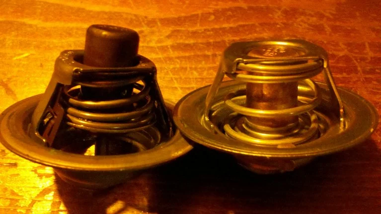

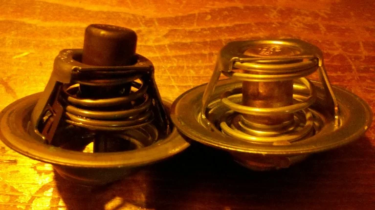

I think that kind of explains itself...
The old one was a 160*, ditched that for a 180* Murray.
Now I can have my windows defrosted on my way to school!
:poo:
:poo:

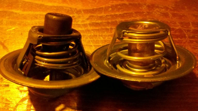

if u didnt put it in yet drill a couple small 1/8 inch holes in flange. I had my therm freez shut it wouldnt open so it built pressure and popped my upper rad line off and dumped coolant all over my new 333 stroker that had only 750 miles on engine. Also put a little crack in my hood, only downside to drilling a couple holes is it will take a little longer to get heat but atleast some coolant goes into motor if therm wont open and it makes coolant flow better
