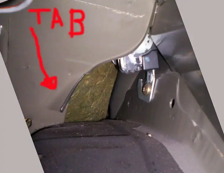

it sounds like i have 2 birds in my trunk yapping away at each other. one it seems to be only during accel or over bumps, its a squeeking/vibrating noise. the other im leaning towards a suspension (control arm-ish) squeek because its only when i hit bumps. the 2nd one i will try and narrow down when i get it up on a lift at work, but the first one sounds like its definitely inside the vehicle.
any particular areas i should be looking at? MACH 460 amp racks? seat mounts?

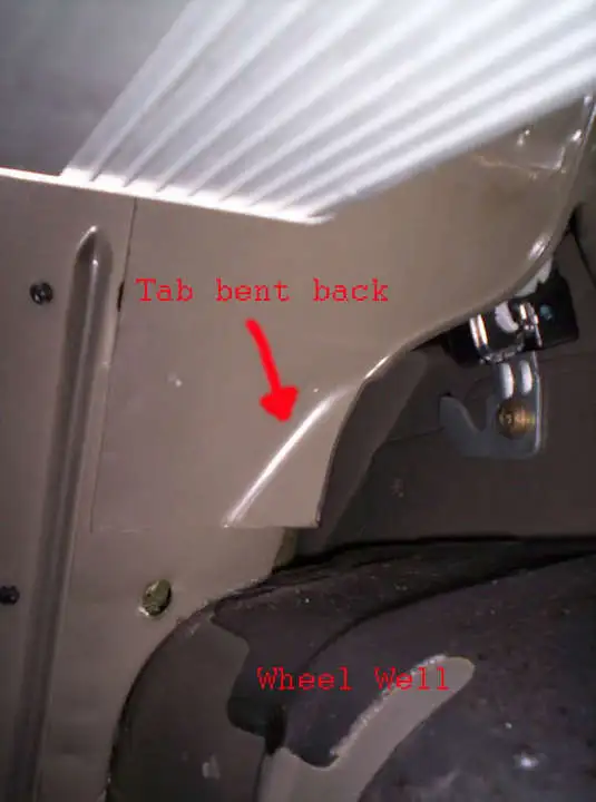

I think I've got this one!!!! OK put your back seats down and lay down while someone drives your car and listen for the noise. If your like me, nobody drives my car, so have someone else listen while you drive. Anyways, there are these little metal tabs around the part where the inside wheel wells meets the metal that holds up your back seat. Sorry about the description, I'm no mechanic. Take a screwdriver and bend those tabs away/back a little bit until you find the one that is squeaking. I think they were supposed to be welded better or something but they rub together as your car moves and makes a bad squeak noise.
A couple of years ago I was tracking down a squeak noise and I replaced all kinds of stuff in the rear end until someone on one of the forums helped me out with the bending tabs advise. Try this before you buy anything. Unless your looking for an excuse to upgrade your rear suspension. Worked for me. :)

That doesn't mean it shouldn't be annoying. Thank you VERY much 03GT, the tab bending trick helped a TON for me. Having noises like that really affect how you feel about your car, and how you drive it. It's almost like "The nicer you treat me, the nicer I'll treat you." Now I have to get creative and find a way to make my Mac catback not rattle against the pretend frame rail in the back.
