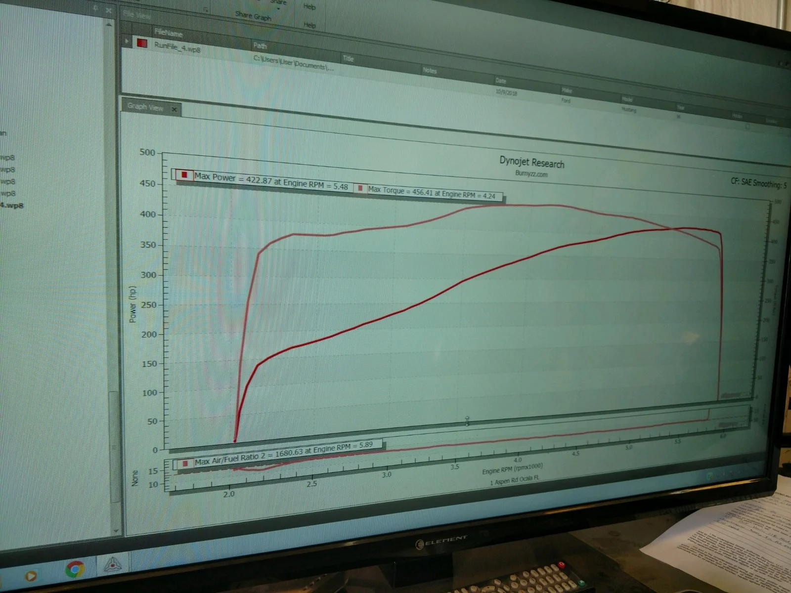

I need to hit the dyno and see what my 347 makes. Based on feel, I would say the torque is under 400 at the wheels, but I’m betting my HP is over that mark. It’s a Fordstrokers 347 in a stock block, TFS 170s, GT40 tubular upper with a ported lower, and custom cam. Comes on at about 2700-2900 RPMs and screams from there.
Edit: This thread just motivated me to hit the dyno. I called a local shop that was recommended by my tuner and am waiting to hear back on an available spot time.

Idk I’d say the box r is pretty good as far as torque curve goes ;)
