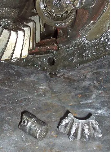

Well, I was right about the problem being with the spider gears. After pulling the axles with a slide hammer my neighbor made for stubborn axles (works awesome) and dropping the third member, this fell out....
attachment.php

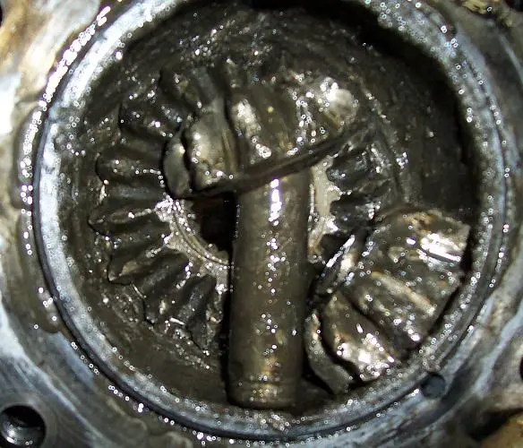

Then I got the spool apart this morning at my shop and found this...
attachment.php
I have no idea how this thing even moved forward. Anyway, the spider gear shaft ovalled the holes in the spool, so it is useless. I can keep my gear set though which are 3.50's. How much cash am I looking at for a spool for a 28 spline 9"?

krash kendall said:
this fell out....

Beautiful pictures, BTW. There's something pretty cool about spent machinery.
