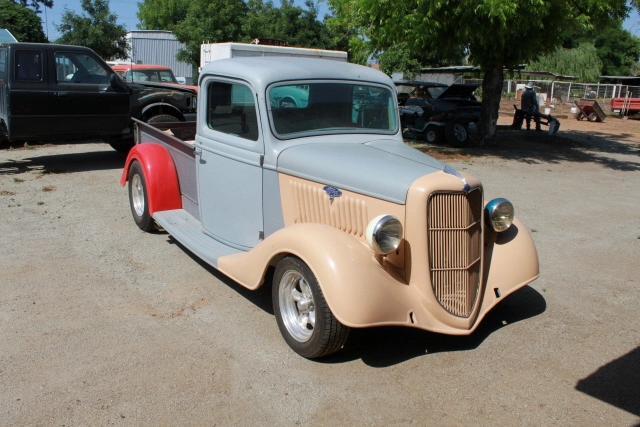

i went out to start my 35 ford pick up today, its been parked for about
3 months, turned the motor over it fired one time then nothing. then i
smelled rotten gass.opened the hood just in time to see gass spraying out
the side of the fuel pump. the gass had eaten a hole in the pump diaphragm
decided to pull the pump off ,grabed the fuel line it stretched like a slimmy
black worm coating my hands with black goo. it melted all the rubber fuel lines
can only imagine what the inside of my brand new gass tank looks like. took the
holly apart it was pluged up sollid, the eccelerator pumps were hard as a rock the
paint on my frame was blistered and peeling were the gass had been dripping on it.
now i know i should have used a fuel stabalizer,but to get this much dammage
in three months is crazy.lately i have noticed the gass turns yellow very quickly
seems like to me we are now paying tripple price for gass that is more costic and

Ive had braided line leak the same way yours did.It gets expensive replacing that stuff.
just a question, but did you use the fuel injection type hose for your gas line?
no it is the high presure fuel line that i have always used, but the fact is it
is ruining more than the fuel lines , atleast i ran metal lines from the tank
up to the fuel pump and there is only about 6 inches of ruber line conecting
at the pump, but the eccelerator pumps and the fuel pumps are getting ruened
as well, i have put three new fuel pumps on my sand blaster this year alone
all with the same problem ,holes rotted in the rubber parts and fuel squirting
out the sides of them, guess i am going to have to change over to alcahol fuel
pumps and us holly guys ,change the eccelerator pumps to the green alcahol
ones, and the fuel lines i guess were going to have to change to the plastic type
but remember we were told that this new fuel shouldnt cause any damage to
our classic cars. more bull ,cant wait to see what it does to the internals of the

just changed all the fuel lines today i forgot the two short lines at
the fuel filter ,going to make the fuel filter bolt in as well had a hard
time finding the same fuel pump but i did for all the good it will do
the carb is next, the alcahol pumps arnt cheap and none of the shops
cary them around here ,looks like summit again,afraid to even check the
fuel tank and sender unit, fingers and toes crossed,just cant believe the
dammage in just three months sitting, yes the hose has green printing on it

i removed the fuel sender,and just what i was afraid of the plastic filter on the
suction tube was black and melted, the tank seems to be ok. going to un bolt the
fuel lines and flush them and the tank with chem tool and change the fuel filter
