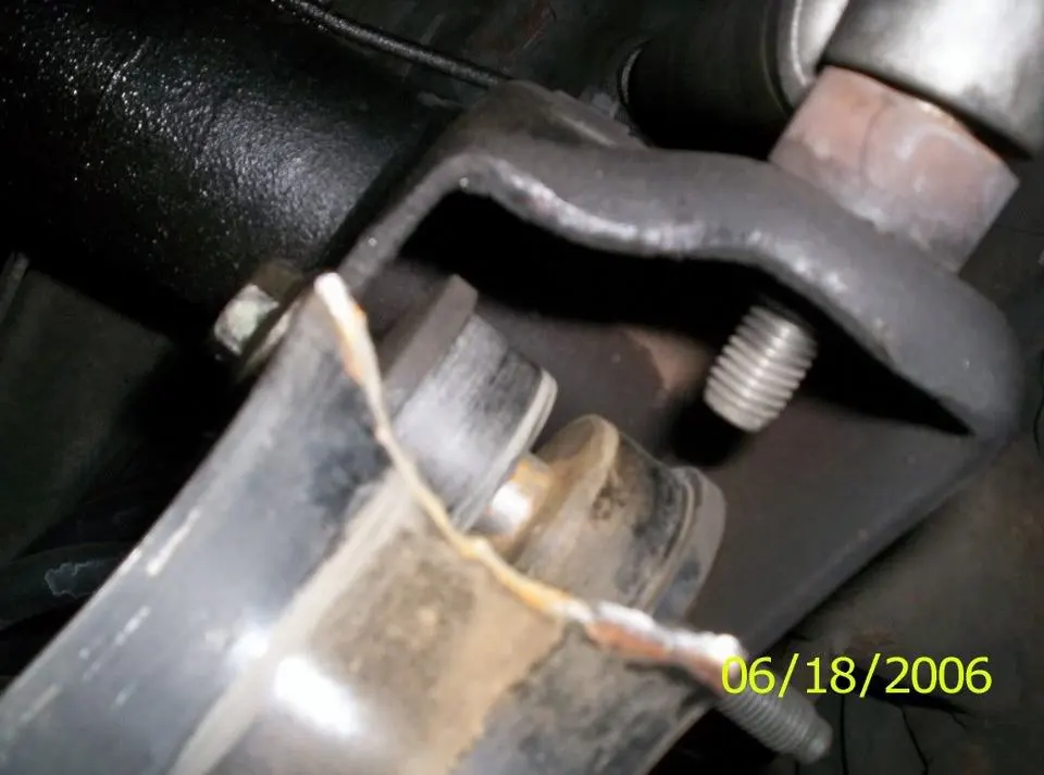

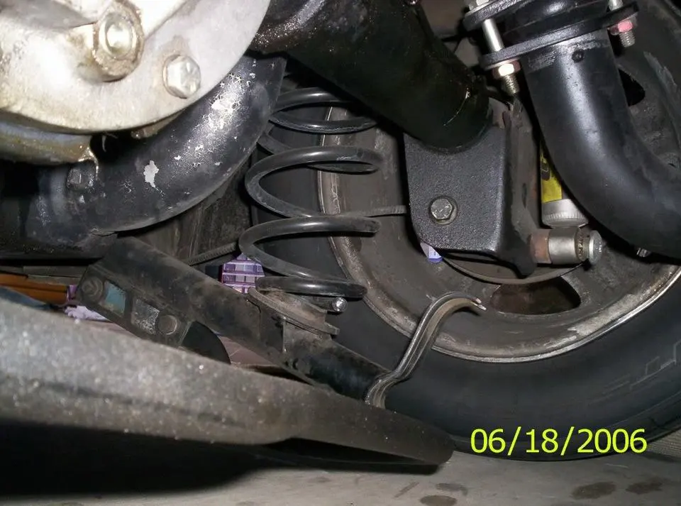

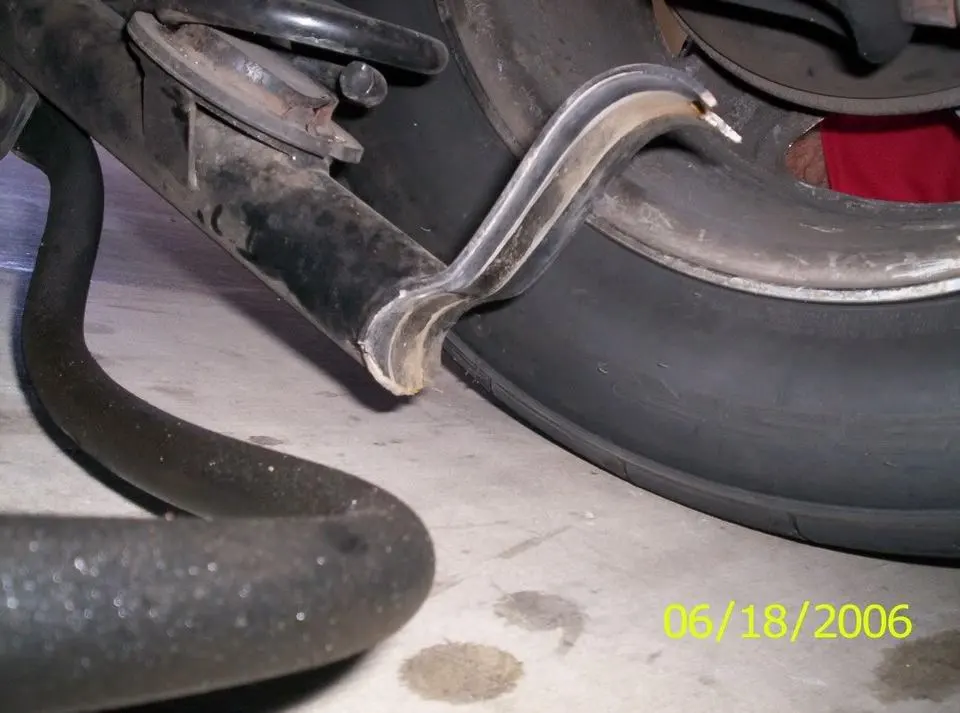

347 here..10.5:1 comp, tko600 trans, mcloud clutch, aluminum flywheel, and d.s. rebuilt trac lock moser axles and 4.10's, ran 12.34@ 114 mph na....and 11.72 with a 75 shot with a 2.0 60'.....and untuned at the time....now its tuned havent ran it yet picked up 15 rwhp and 25 ft rwtrq..in na form with the tune....this is in a vert that weighs well over 3700 lbs without me in it which is y the times are soo poor, car puts down 337 rwhp and 379 rwtrq...na and 397 rwhp with the 75 shot and 455 rwtq currently have 100 shot jets in right now...car currently down cause of the torque...this is what torque does to evem aftermarkets control arms
