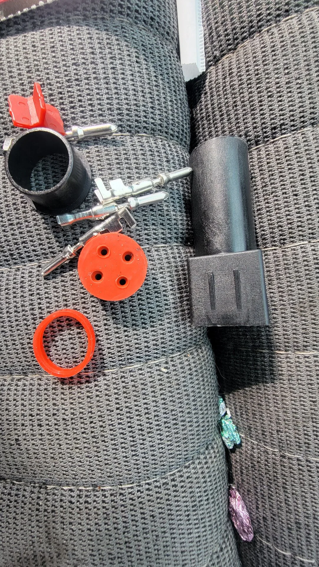

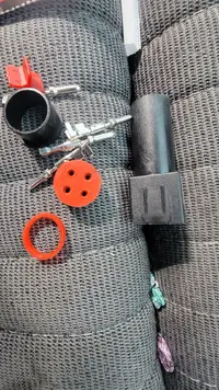

I have done the block off plate with the ebay false sensor. I don't seem to have any drivability issues due to that. BUT, I wish I never had removed it as it is proving to be difficult to get it hooked back up now.
how do I put together this sensor
