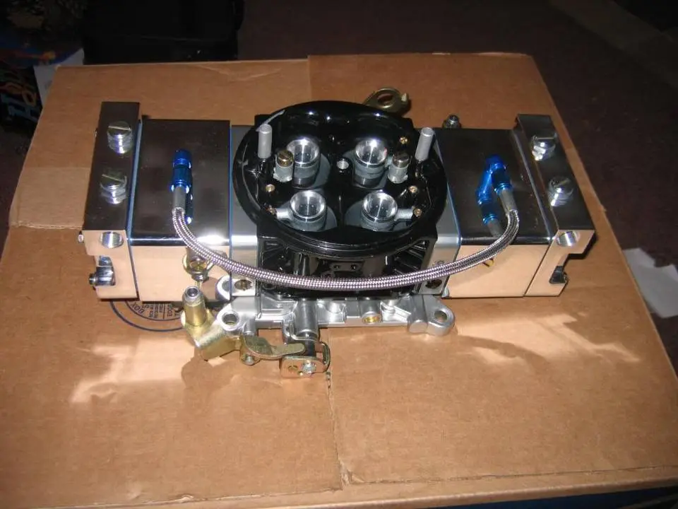

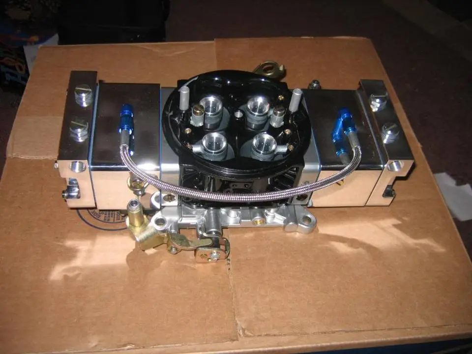

my boss just got one of these, a little overkill,but cool
what the hell is it? i like those big ass annular boosters, i bet they make HUGE power. annular boosters are the way to go, especially on a street motor. but i doubt this thing is going on a street motor, then again mybe that's why it's so overkill. :nice:
