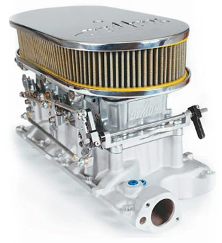

We have sold several hundred of them since they were released. I have one myself on a 65 fastback. They are priced higher than the stock stuff but they are also far superior. The original stuff has what I call the coat hanger looking linkage for one where ours has all nice stainless rod with rod ends and joints. Throttle works a lot smoother and it's safer. Our carbs also have billet metering blocks and baseplates and flow better than the original Holleys do.
Not sure about the original linkages, but the repop stuff is trouble free. As for flow, it's got enough for the 331 it's feeding. A $1000 price difference is far and away, way too much to ever let me think about switching.:rolleyes: "billet" never did impress me.
The billet isn't really for "looks" but rather because you get a better quality part. Our metering blocks are hidden by the fuel bowls so you dont really see them. A nice advantage of the billet parts though is that you dont have to worry about porosity in the castings. Our carburetors have other benefits as well like clear sight glasses for adjusting float levels and screw in air bleeds for tuning if needed. I am not sure on the factory Ford vs our but I do know when we tested our carbs against the Pontiac factory tri-power stuff it was good for 65 hp on a little over 400 inch motor. I forgot to mention earlier but our Mustangs Unlimited does sell our package as well as the one you mentioned. What did you end up using for an air cleaner on yours?
Here's a pic so you can get an idea of what the linkage looks like.

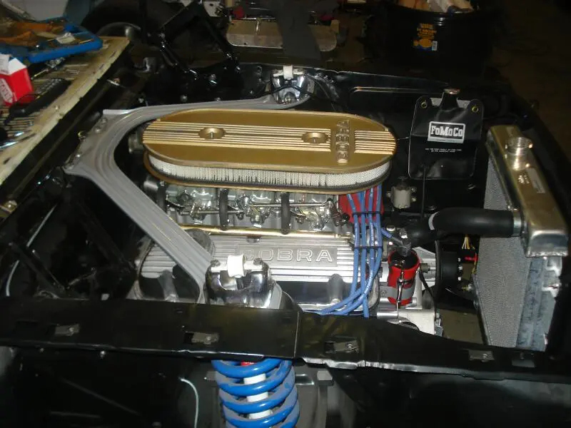

Here's the one on mine with a few small changes for the nostalgic look. The air cleaner top looks all gold but all of the ribbing and lettering[raised area] has been polished. It's in a GT350 Hertz clone so wanted to tie the top in with the gold stripes on the car.

I've used a K&N filter in it, both with the stock height (1.8") and a taller 3" K&N. To use the 3" I fabricated a reversed base to move the filter forward for firewall clearance. That was when the motor was in my 89 Ranger. I now have the motor in a 77 Comet and was thinking on doing the same thing. The setup fits under the hood with the shorter filter, but I'll have to reverse it again to clear the rear bracing at the rear of the hood, then cut the hood to allow the filter to poke thru. Going to cover it with a Comet GT scoop. Hard to tell, but your's looks like the air cleaner assembly is also reversed as compared to mine. It's covering the distributor more like when I reverse mine. The 1.8 K&N is p/n E-1960, the 3" is E-1963

The bottom is a factory Thunderbird 3-2 bottom which sets the air cleaner further forward than the one we supply with the kit in the other pic. The top is a Cobra 2-4 with a pair of fabricated studs. Car is under construction right now as you can tell but I'll post some pics of it later with the air cleaner as shown in the other pic. In addition to the one pictured with the oval billet air cleaner we offer a "old school" version too which has 3 individual air cleaners, red fuel lines going to a chrome distrubution block and the carburetors are more of a traditional "gold" color. A lot of guys are using that version on the street rod stuff.
