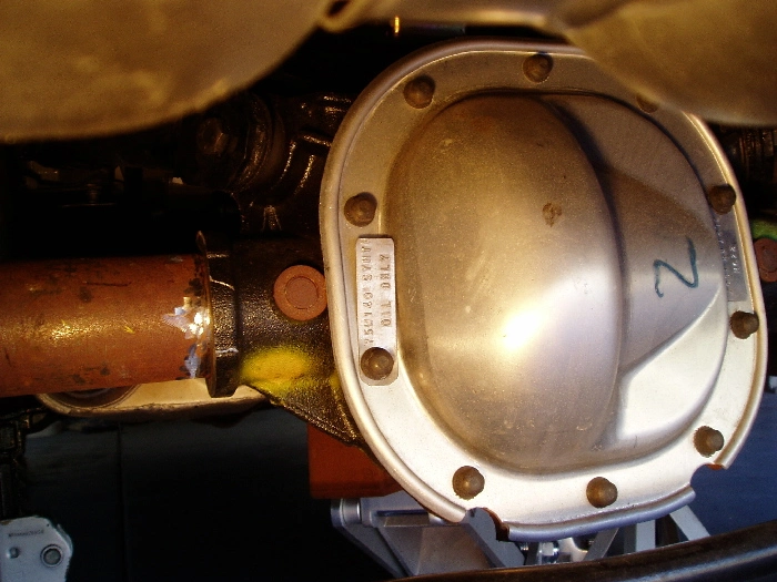

1) I'm about to schedule the install of my FRPP 3.73s. I purchased some 80W90 gear oil (along with everything else needed for the install) but read later in my Shop Manual that Ford calls for 75W140. Can the 80W90 be used or should I stick with a 75W140?
The 80W90 came from SHM. I read an article in a late 5.0 or MM&FF magazine (can't recall which) where they did some fluid changes and put what I believe was 80W90 in the axle. I'm leaning toward going with the 75W140 but I'd like to hear what others think.

1) Use 75W-140, do not forget the friction modifier
Yep, got the little bottle of FM. I'll see if they can give me a deal on the oil...I give them my bottles of 80W90 and they use 75W140 and give me some credit. Might work.
