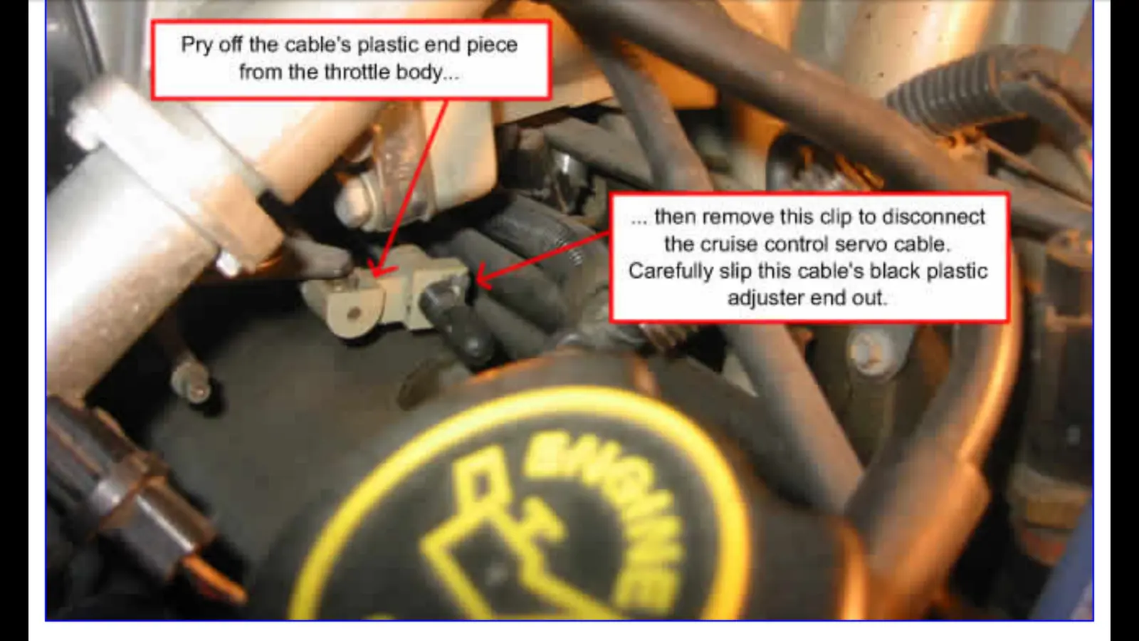

I just need advice on how to remove the 2 throttle cables from under the intake so i can remove it. I can remove the bracket but theyre still obviously attached.
On an 86 ? It’s just a snap that snaps on to a pivot ball . Flat head screwdriver and pry it will come right off
Photo courtesy of LMR
