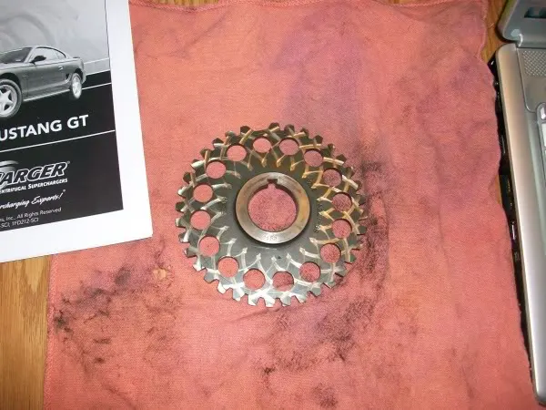

What could have made this pattern?? This can't be good.

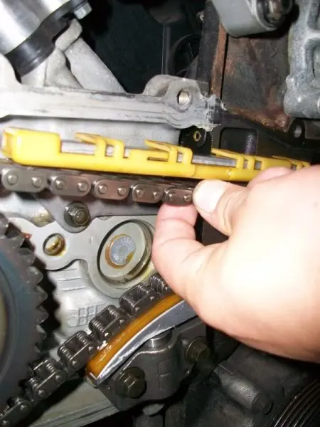

The passenger side timing chain has alot more slack than the driver's side. This means the tensioner is not fully engaging right??
Did I install these gears the right way??

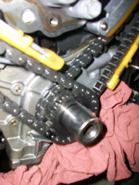

Also when I pulled the crankshaft sensor gear off, one chain link pin was half way out, is this normal???
Thanks
no it is not normal, i suggest putting new chains on and taking the others back due to defective link. in saying that, the pin that was half way out is what made the marks, which is a neat design by the way. the reason i say this is because the chain doest meet the same place everytime. it takes 52 rotations of the crank for the timing marks to line up. once you turn it. thats why the phsycodelic design

The weird thing is I did a head/cam/intake swap last year and replaced all the timing stuff with a timing kit from Bumper to bumper. I'm going to take this **** back and try to get my money back.

Well I called the bumper to bumper and the timing set i bought from CLOYES has a lifetime warranty and I'm getting a whole new set Thursday. Reassembling this weekend and starting to install the D1. I ordered the aeromotive 1:1 fuel pressure regulator and a Diablosport for Anderson to use for tuning the following weekend. I'm excited!!!!!!!!!!! I'm almost getting blown:) HAHA
