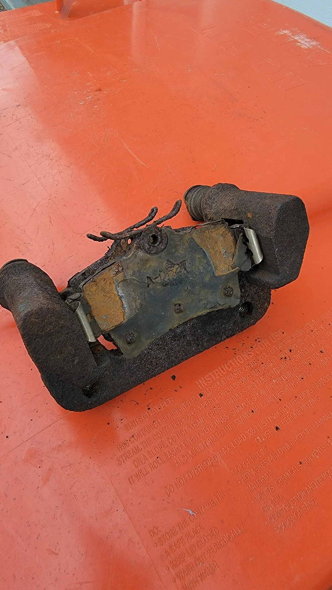

Not aware of a spring behind the pads. What side of the caliper were they on, piston or outward side?
On top, not on sides.
Do you mean the clip that some calipers have in the top slot of the caliper? I am not sure what it does, if my calipers had them I am pretty sure I don't have them now.
New pads have them installed. They are not removable. If they come off I would pitch the pad.
Got it, thanks.
Makes me a bit nervous now though seeing that it doesn't look like the pads that come with the kits have the springs. Maybe they are just general photos and not model specific though
