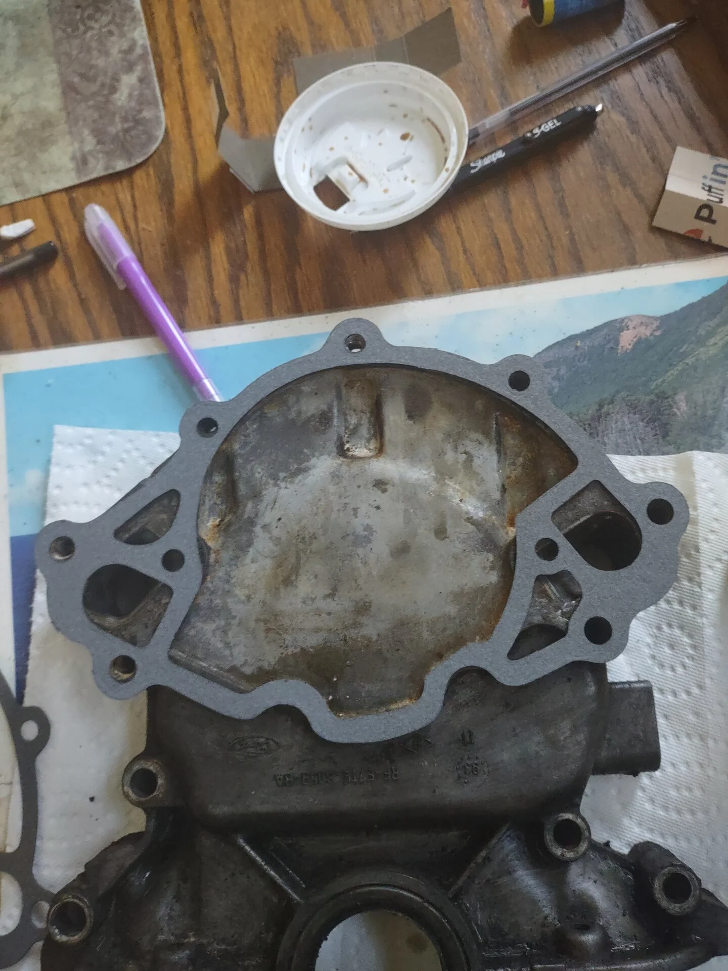

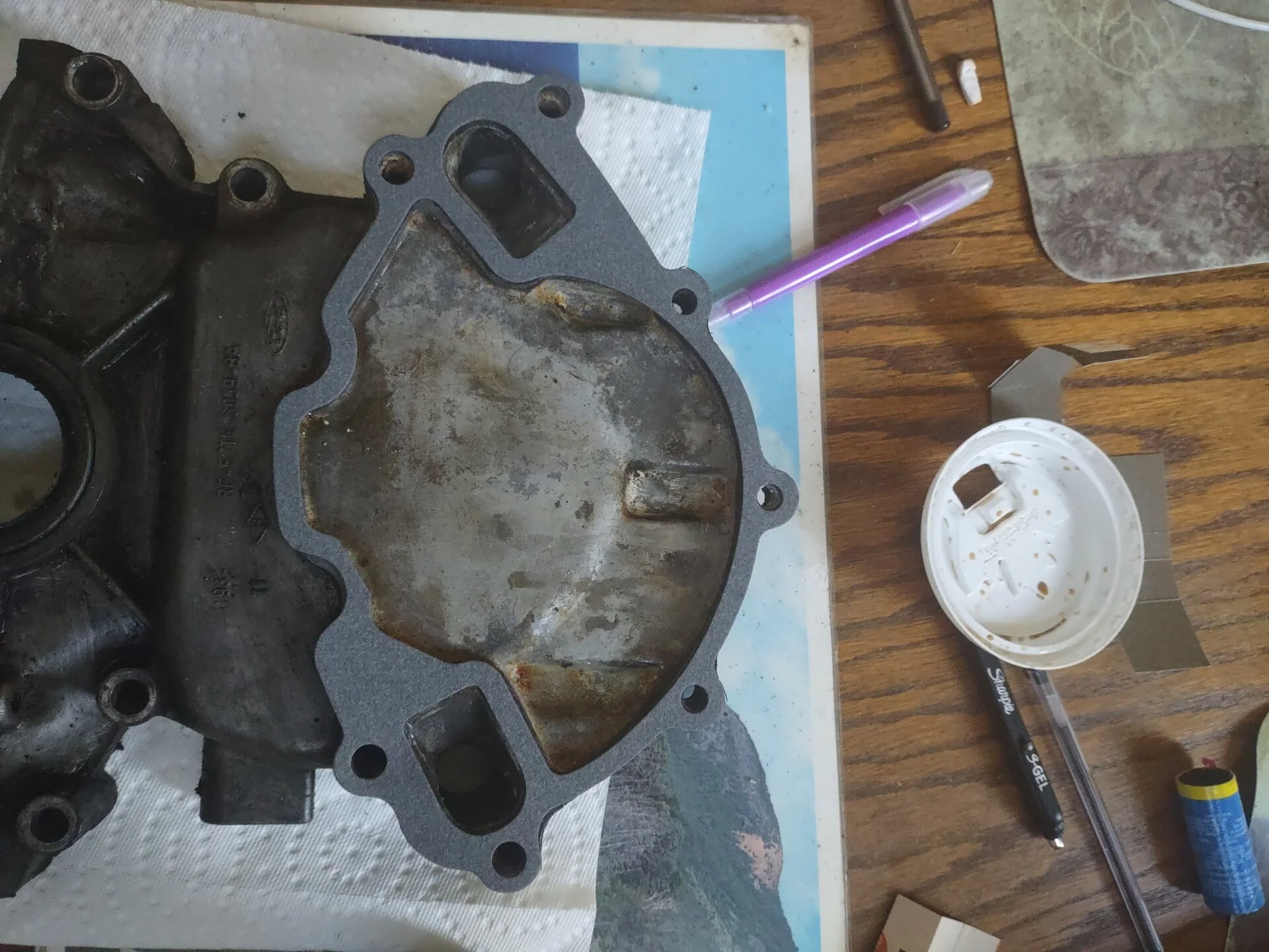

Can I use this timing chain cover off a fuel injection 302 from this 92-96 f150 on my 89 302ho???

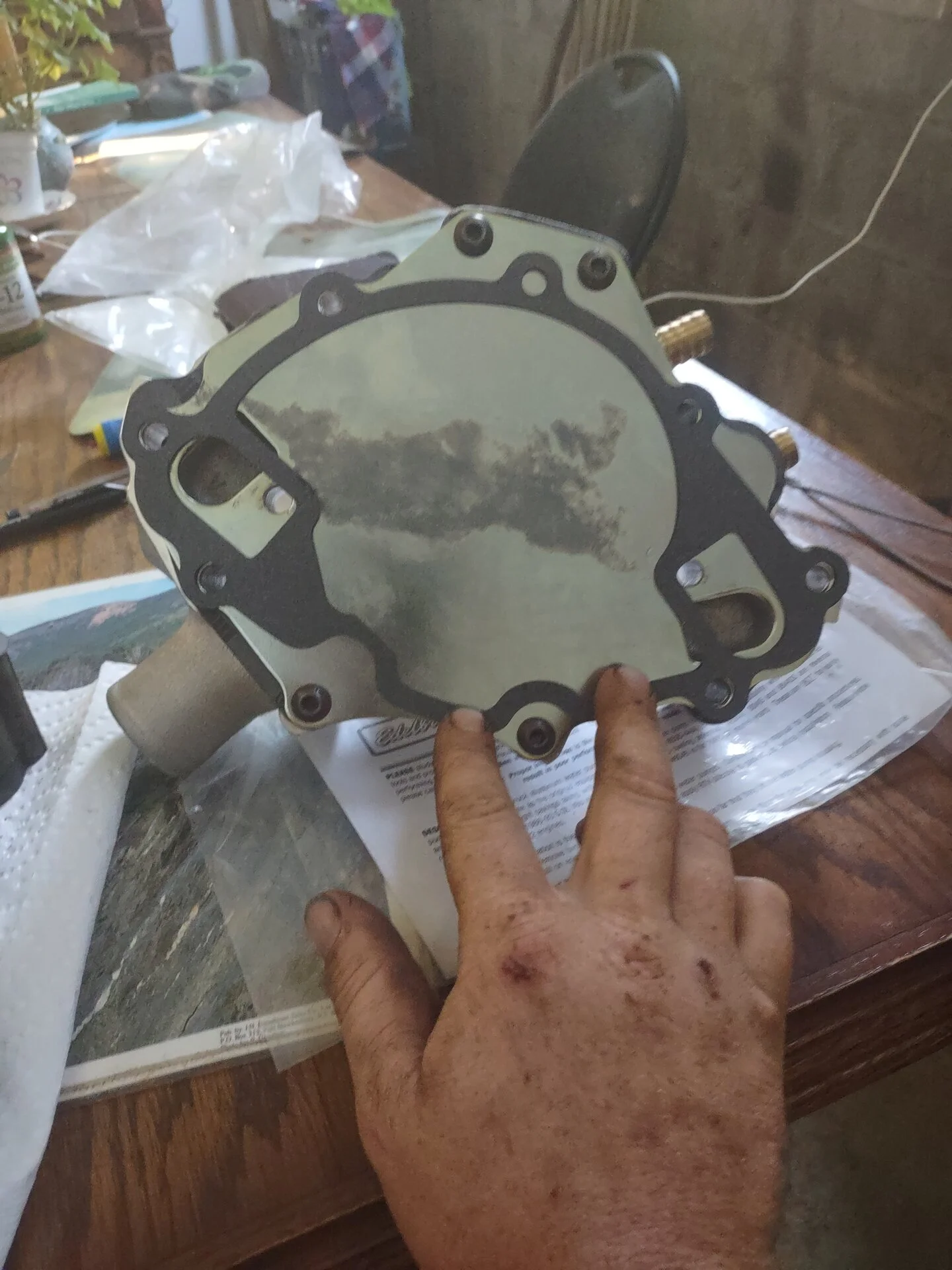

The serpentine trucks all have reverse rotation pumps.The truck WP usually turns the opposite direction. The coolant holes in that timing cover look like they are angled wrong for a fox WP. Definitely compare them to each other.
