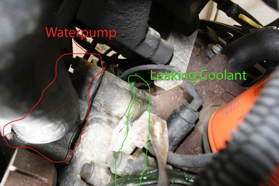

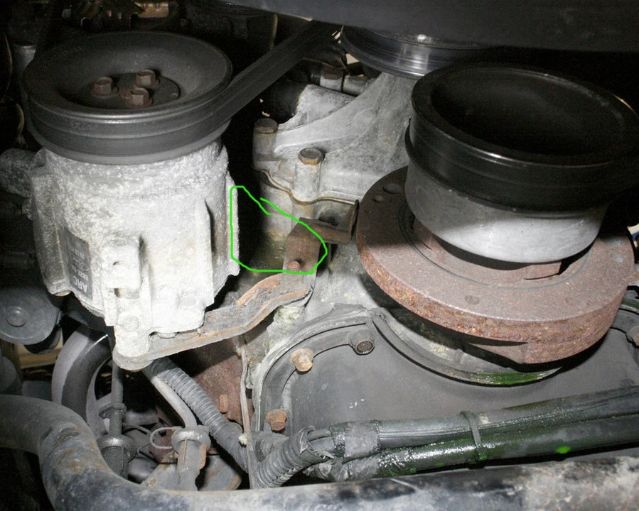

Leaking coolant from what looks like the timing cover. Should I just try to replace that gasket and the water pump one at the same time? Is this a common problem?
I just bought the vehicle and the previous owner said it was coolant spilled from a recent thermostat change. Obviously not. Anything else I should be looking for on a new (to me) 5.0?
From the pics you shown, does look like the timing cover to me.
Just a heads up, to remove the cover, you will need to pull the harmonic balancer off..so you'll need the tool for that. Also, i beleive you need a 15/16" socket for the bolt. Make sure you have these ready to go before you start along with the gaskets and some anti-seize for the bolts.
Is the water pump leaking from the lower weep holes? If not, you may not need to replace it..unless it's old and you want to while you are there.
Be careful removing the bolts. When covers leak, coolant tends to seep into the bolt passages and corrode them. As a result, many people have snapped bolts off in the block. If you remove the cover, you can sometimes get the rest of the bolt out with a pipe wrench.
When you reinstall, use anti-seize!
do a pressure test. you can rent one from most auto part stores. it could be coming from the lower intake, a hose, the coolant pipe, t-stat housing ( too name a few areas) and running down the front of the motor. when removing the water pump bolts back them out then turn them back in doing this over & over, it sometimes helps to clear the threads and keep them from snapping.

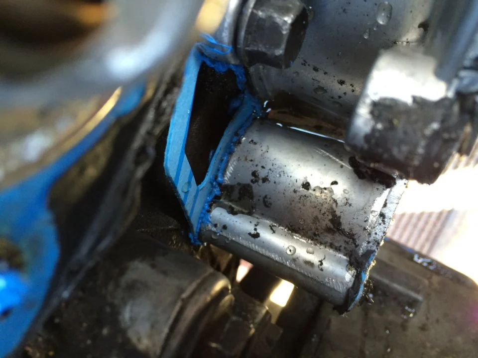

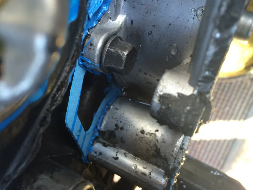

Hello I have a 90 mustang 5.o LX having the same problem went to replace my water pump the bolt that goes through the water pump timing cover and into the block broke I got it out ended up replacing the water pump and timing cover still leaks I've taking it apart 3 times cleaned the hell out of the block timing cover and water pump still leaking on me have no idea what to do now
