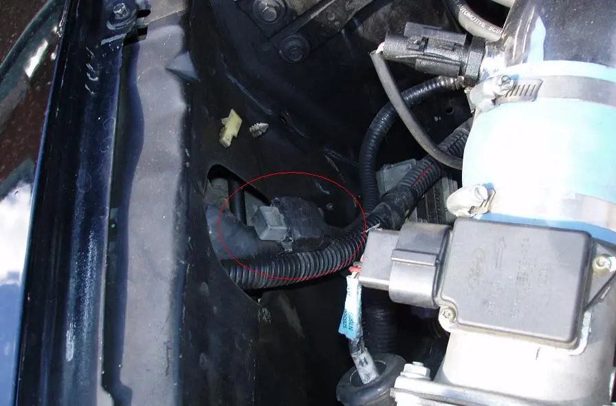

is the spout connecter a little grey box?two prongs?on the pass fenderwall?its the only yhting i see?two wires and a little box that connectcs them that you can pull out??????
here is a pic of the SPOUT

enough to get someone real upset man
