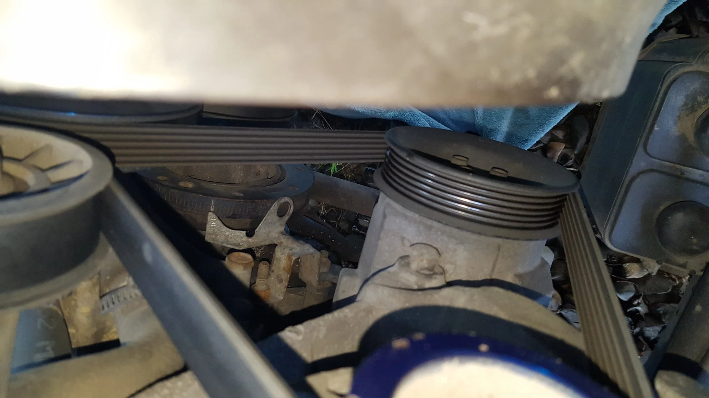

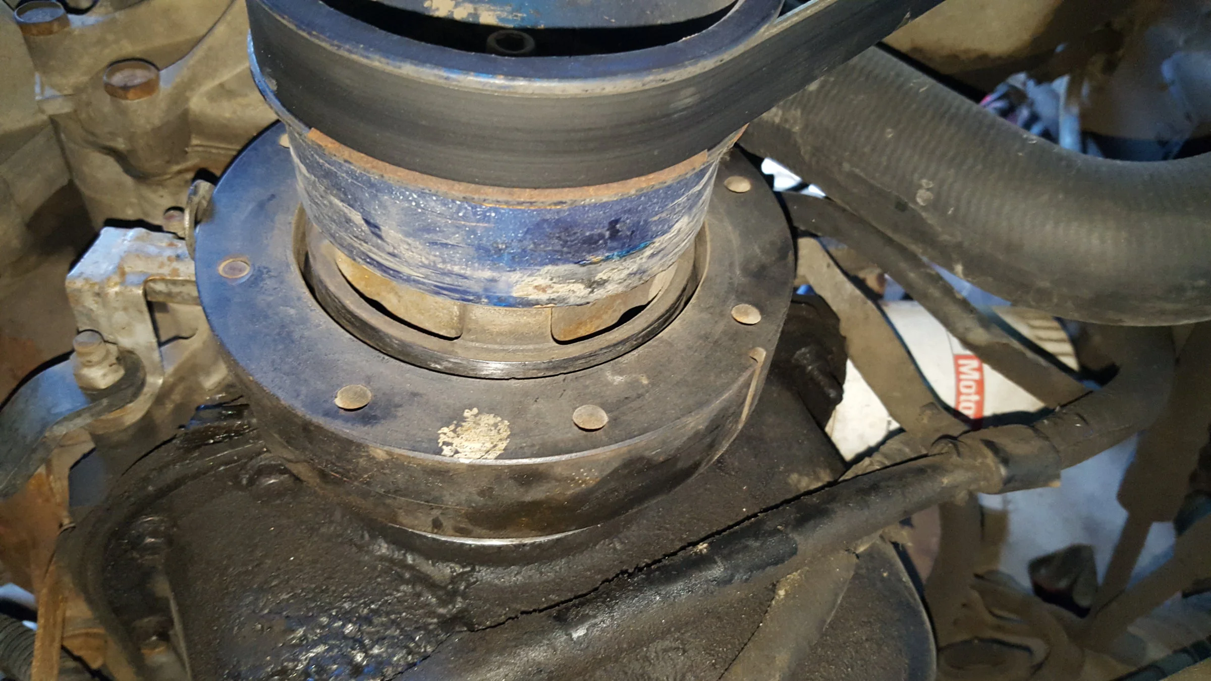

Hello from the cold north of Alaska. So I have been working on a 92 GT. After coming back from a drive, I heard some rattling in the engine bay. Fearing the worst, I checked everything out. The rattling was actually coming from the metal wheel that has the notches for the timing indicator. It is completely loose and banging around as the crank spins. I have no clue what holds this in place and what I need to fix it. Any help is greatly appreciated. Thanks.
That is the harmonic balancer. Do not run the engine, because it may cause damage to the engine internal parts because the engine now has a serious out of balance condition.
