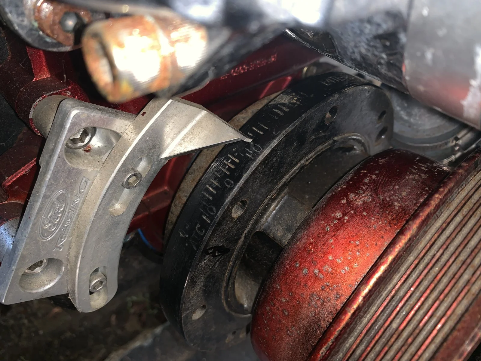

Real quick, at the very top of the piston on compression stroke this is where I’m at. Is this right?

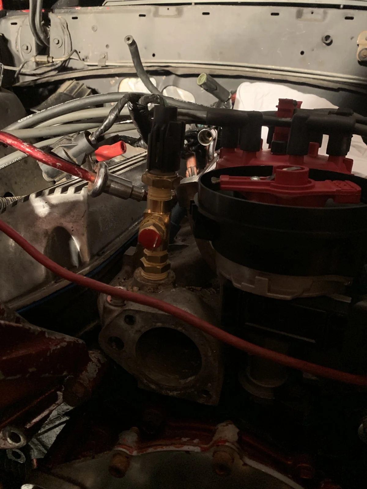

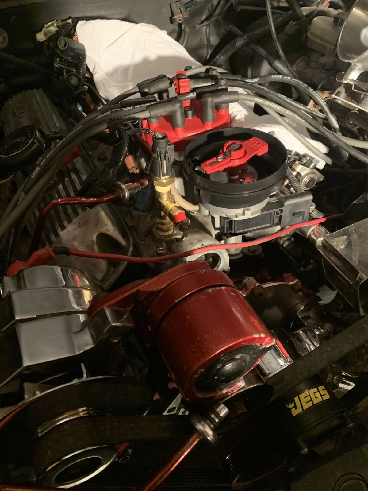

Thanks a lot for your time General, unfortunately I got mixed up in a few other things I wanted to do. I figured as long as I have the upper intake off (found a oil leak on drivers side coming from valve cover, got twisted up somehow) I got rid of the heater tubes and hooked up the relay for electric fans. It’s all back together now and set to TDC (I moved the pointer) but it’s now 11:30 and although I own the building I live in, I have 4 apartments and don’t wanna tick anyone off, so I’ll get back to it tomorrow morning. I’ll see where I’m at timing wise and see if moving it to where it is did anything.
I also tested the IAC with a 9 volt battery, it works and I’m getting around 25psi at the Schrader valve. Like I said we’ll see where I’m at in the am and if nothings changed, I’ll run down that list.
Let me know what you think of my heater tube delete, was thinking of using another T to run a small hose to the back of the intake to keep the water moving so I get a good read on the temp, what do you think?
Thanks again

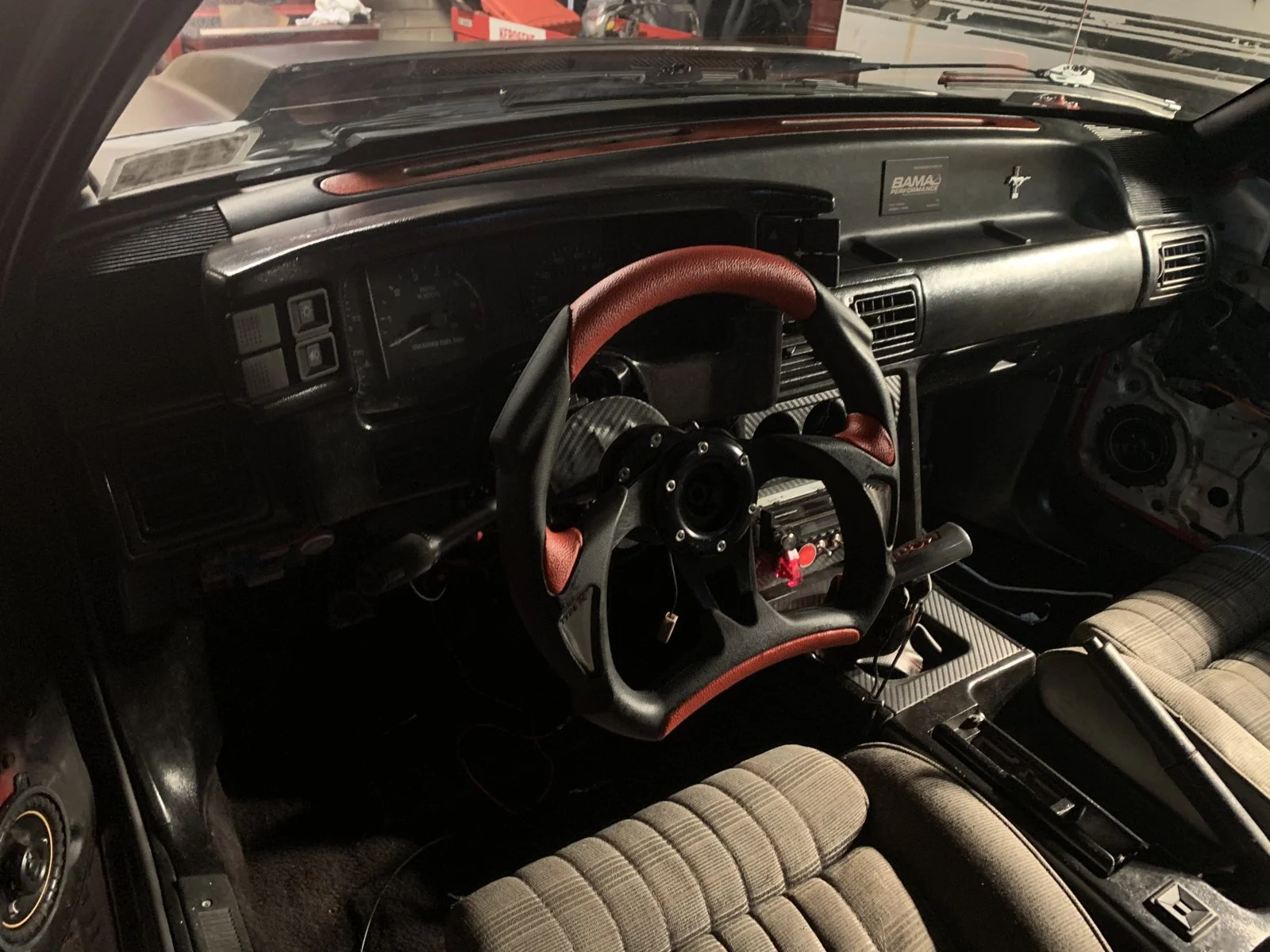

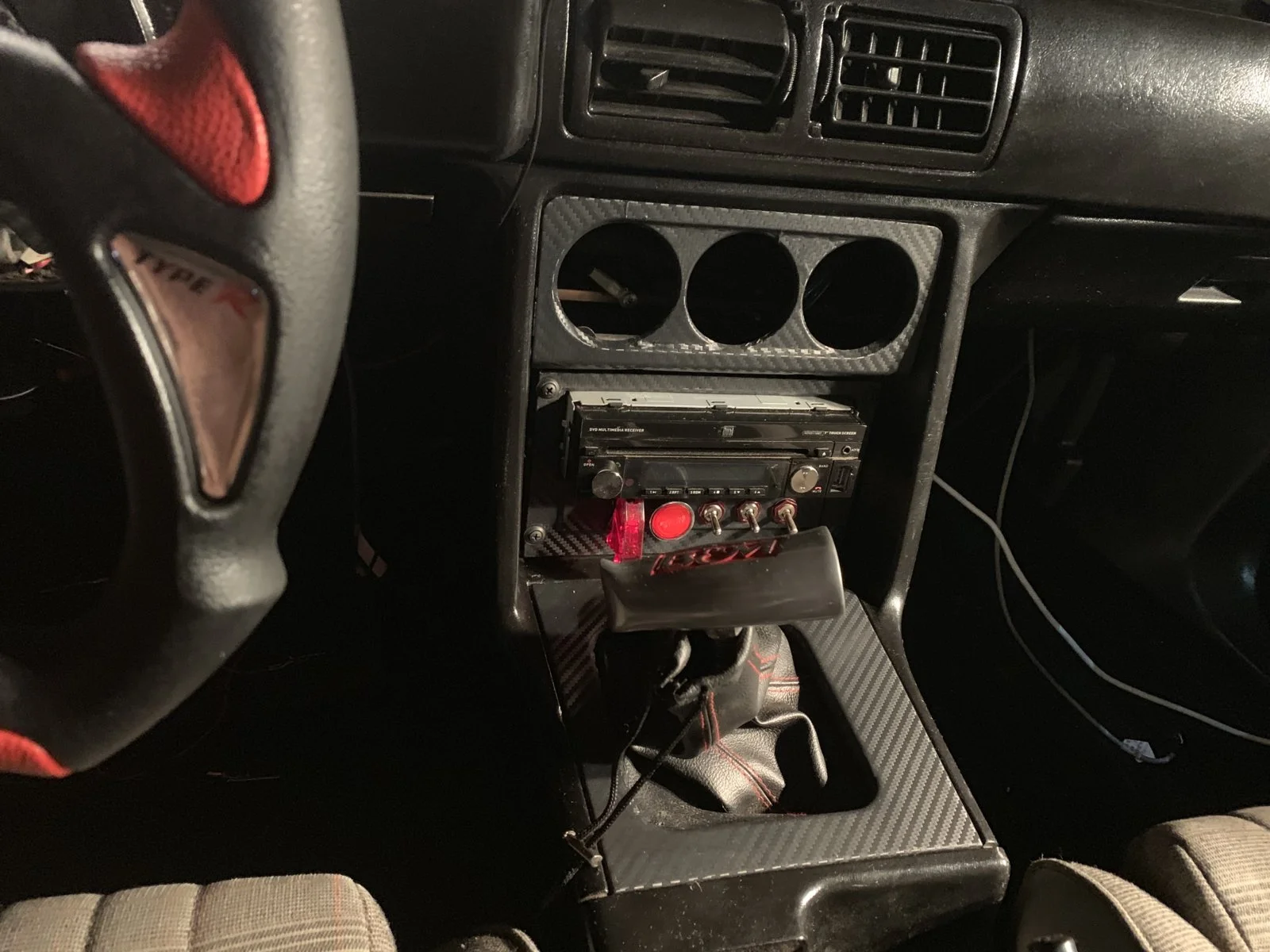

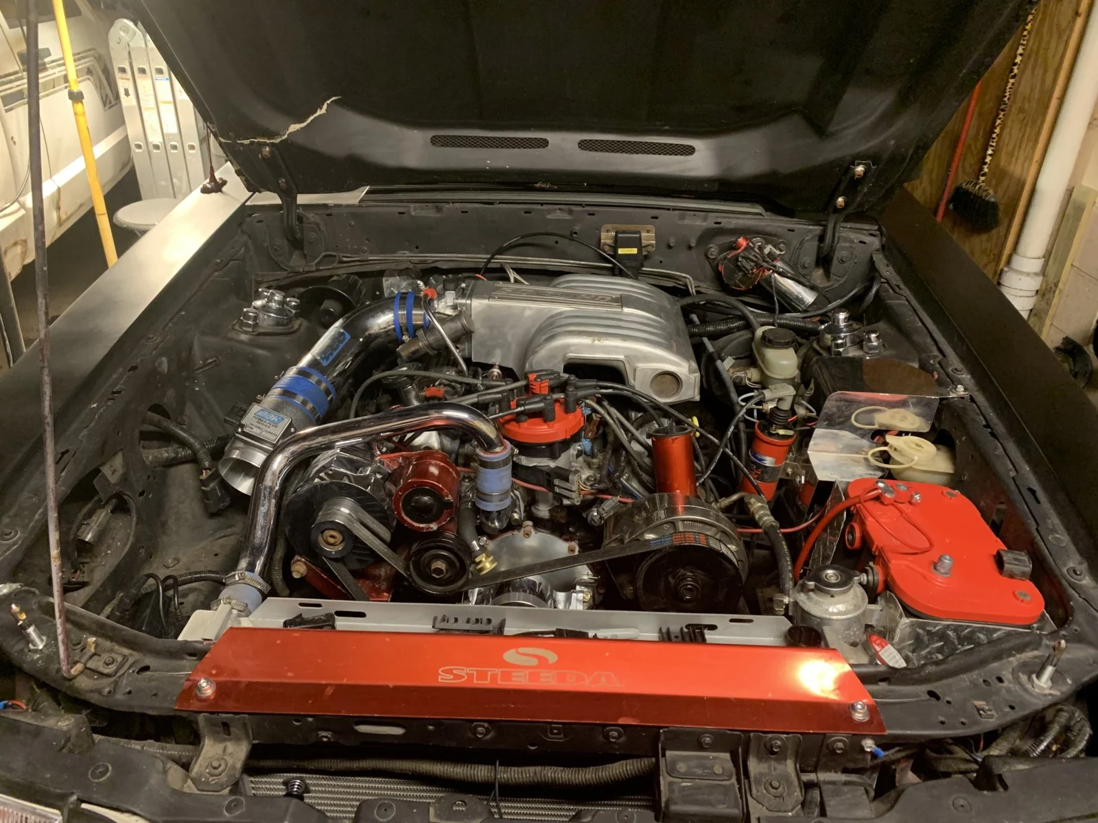

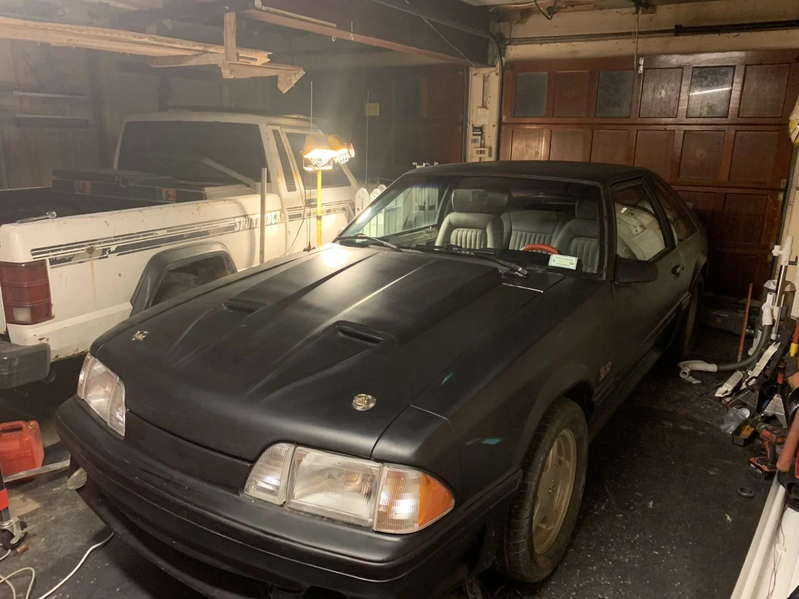

So she’s all back together. For :poo:s and giggles I used the non HO firing order and she started right up. When I hooked up the maf she died, unplug runs good. Funny thing I 1 went back to the HO firing order just to see and she still runs, but the maf still makes her stall. When I leave it plugged in but take off the cai, she continues to run all in all she runs and that’s good, took her down the road and she would stall out every once in a while but she goes sideways no problem. Next I need to tackle some wiring issues I’m having and need to get all new door locking mechanisms, the locks are jammed up for some reason. Well she ain’t beautiful, but here’s some photos of how she’s looking. Thanks for yalls input!!
Is that an aftermarket maf sensor of just a sticker? And that stack of sensors and senders behind the alternator?
you still got some stuff to work out, have you checked for codes since putting it back together?
What injector size?
you also need some space between the maf and the filter like 5 or 6" of pipe, if you can find a stock air box they work better than people think.

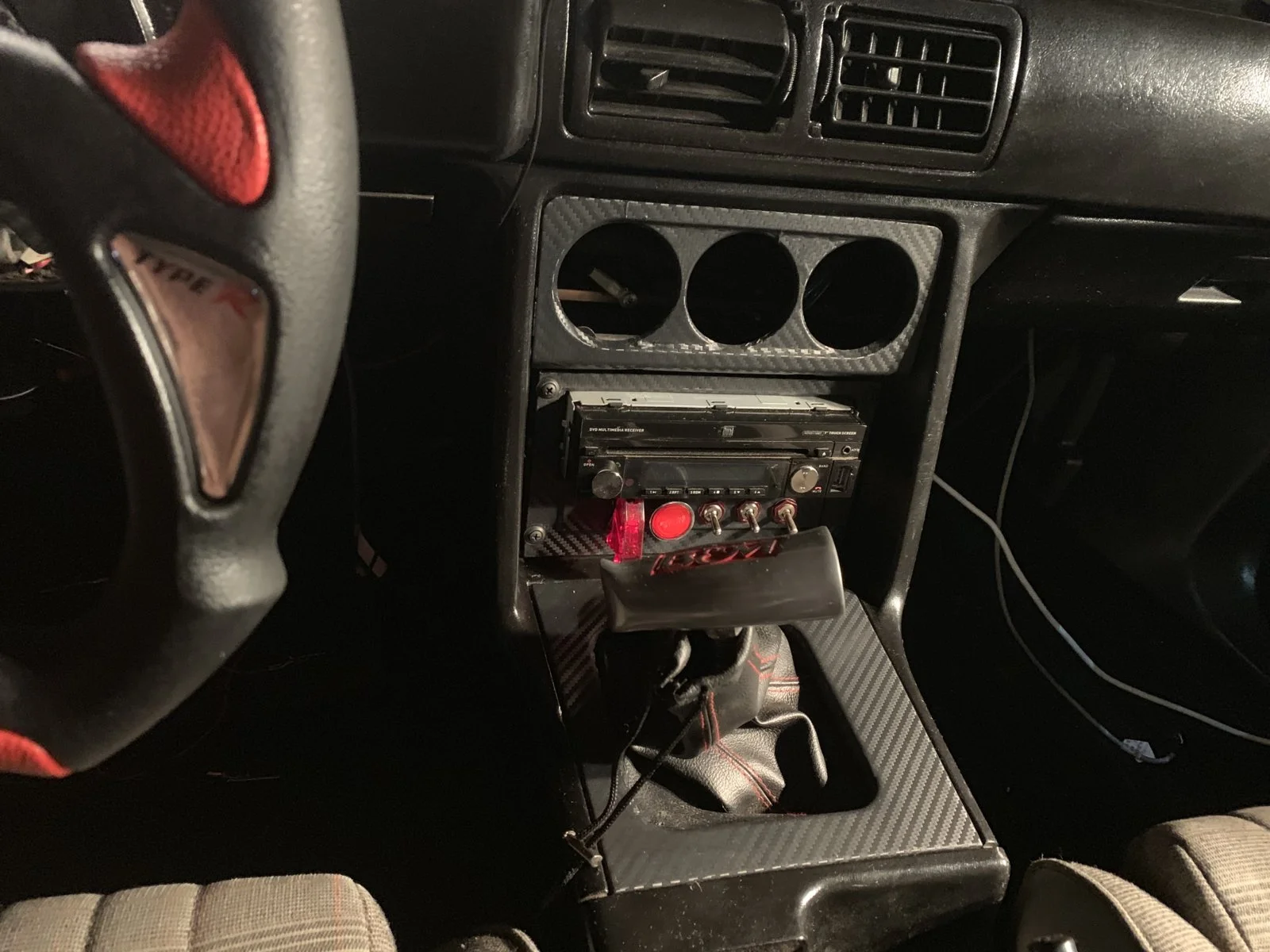

you need to fix the fuel pump switch thing, why do you have it on a switch?
Yes all egr stuff is gone. The fuel pump is wired to a switch on my console along with electric fan and water pump. My fuel pressure is at 38-40psi, tested it tonight.
