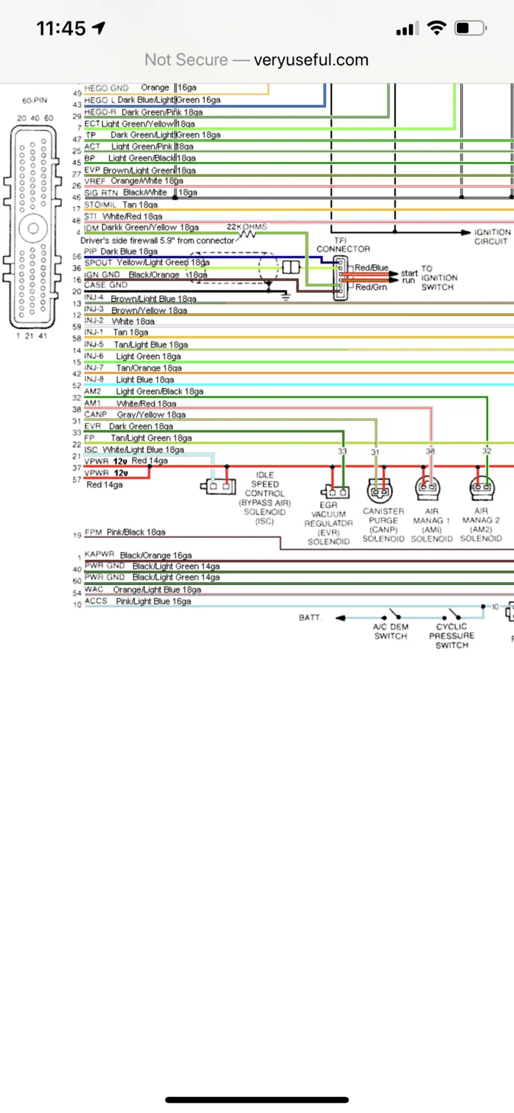

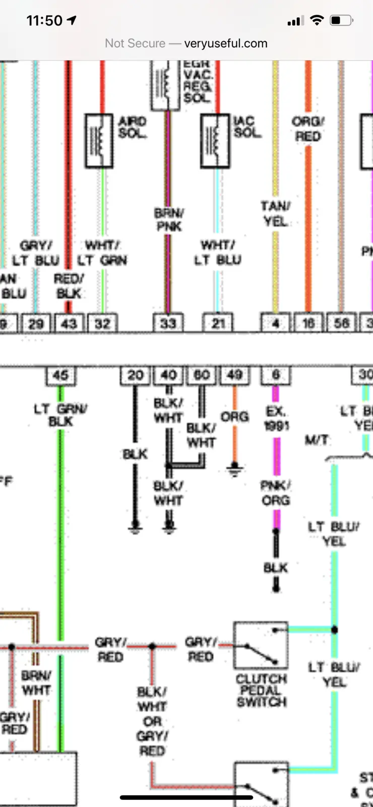

Ok so I found that on 88-91 there is a black/orange ignition ground and a black case ground. Then on 91-93 there is a black, black/white and an orange ground. Doesn’t say if it’s a case ground or not but maybe the brown is actually orange?
