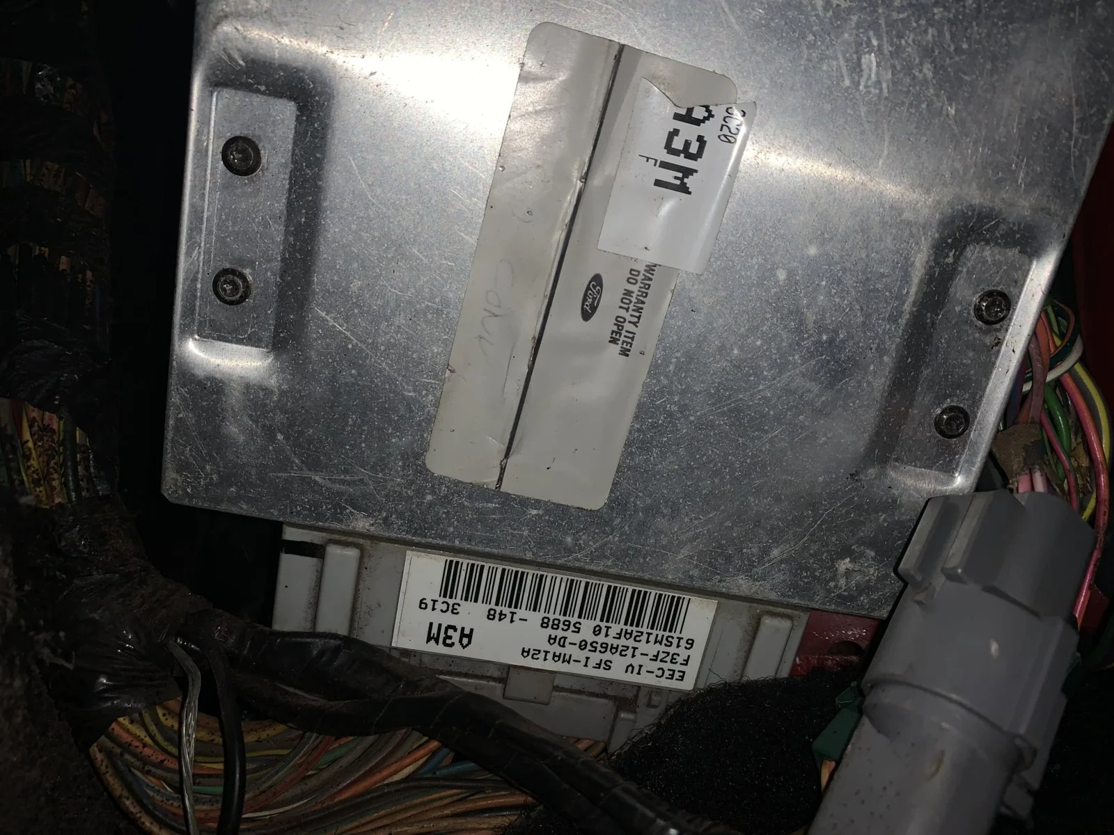

I’m not sure of the alternator, it came with the car. It has no stickers or anything.

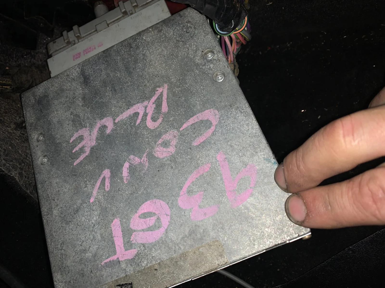

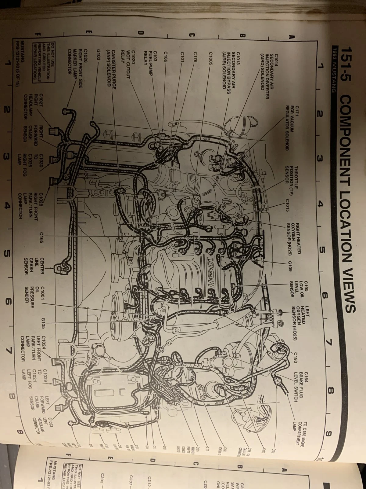

Attached are photos of the computer. As you see it’s out of a 93 convertible. Also a book that’s beat up but all there. I’ll check the grounds

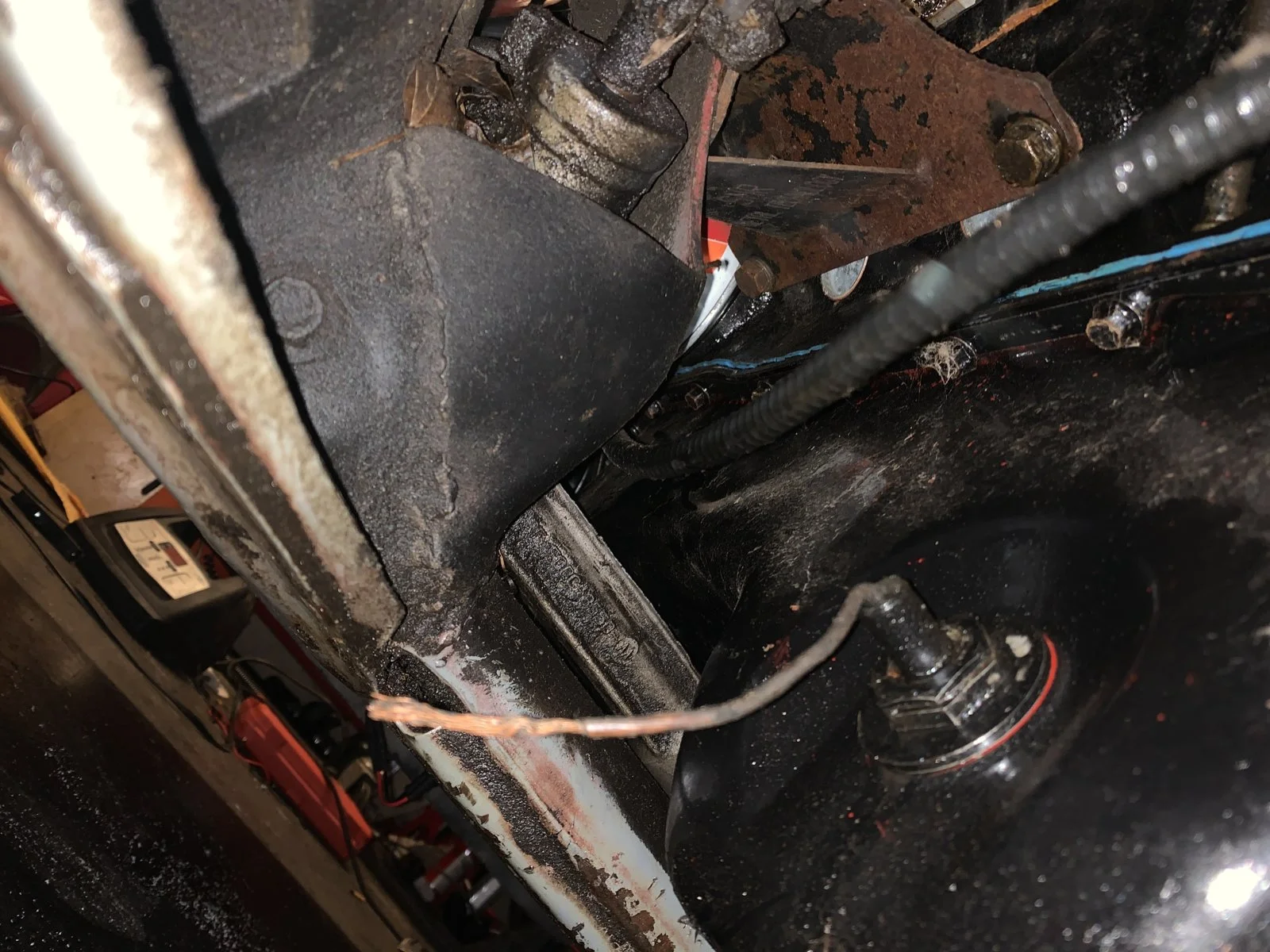

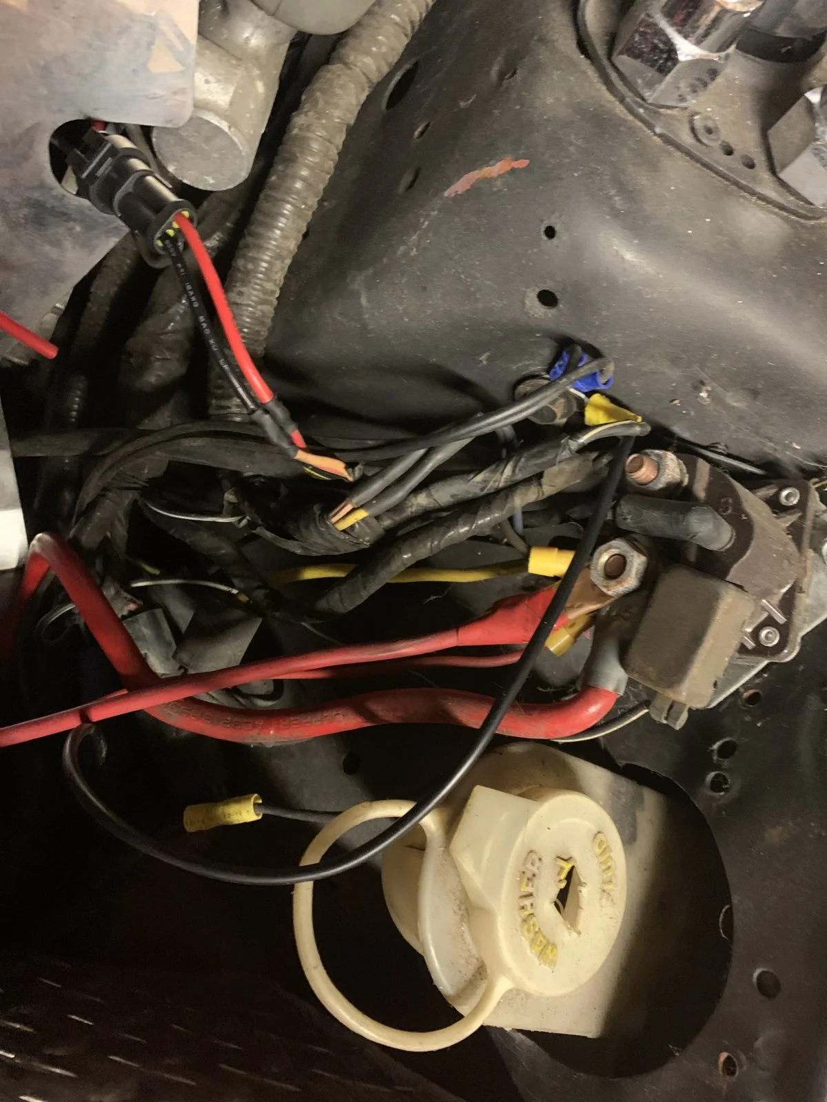

Ok, so I’m not seeing any ground wires behind drivers head or passengers head. There is a ground from battery to fender. It’s a mess!!! 24# injectors. And I got the egr delete spacer with the plug to “trick the computer”. image.webp image.webp image.webp image.webp

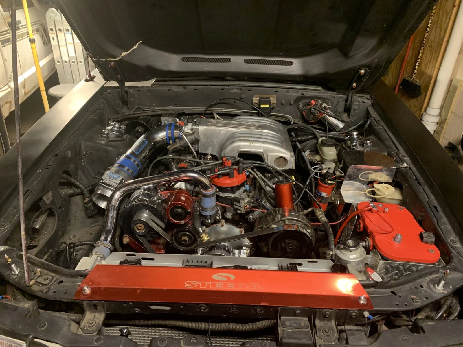

Also, I wanted the race car feel so I used the switches to control fuel, air and water. I used electric fans and water pump to free up horsepower.
my biggest problem here is that pre Windsor heads the car ran great!!!! No issues. I changed the heads, that’s it. Well to be honest, I attached the heads to the block, but before I could adjust the lash on the push rods, my wife passed away and so she sat for 6 years. One would think, you pick up where you left off, reassemble and it should run just as good if not better than before. I may have forgotten the grounds though I don’t see any unhooked dangling wires anywhere. I’ve changed the gas, fuel filter, injectors, distributor, spark plugs and oil.

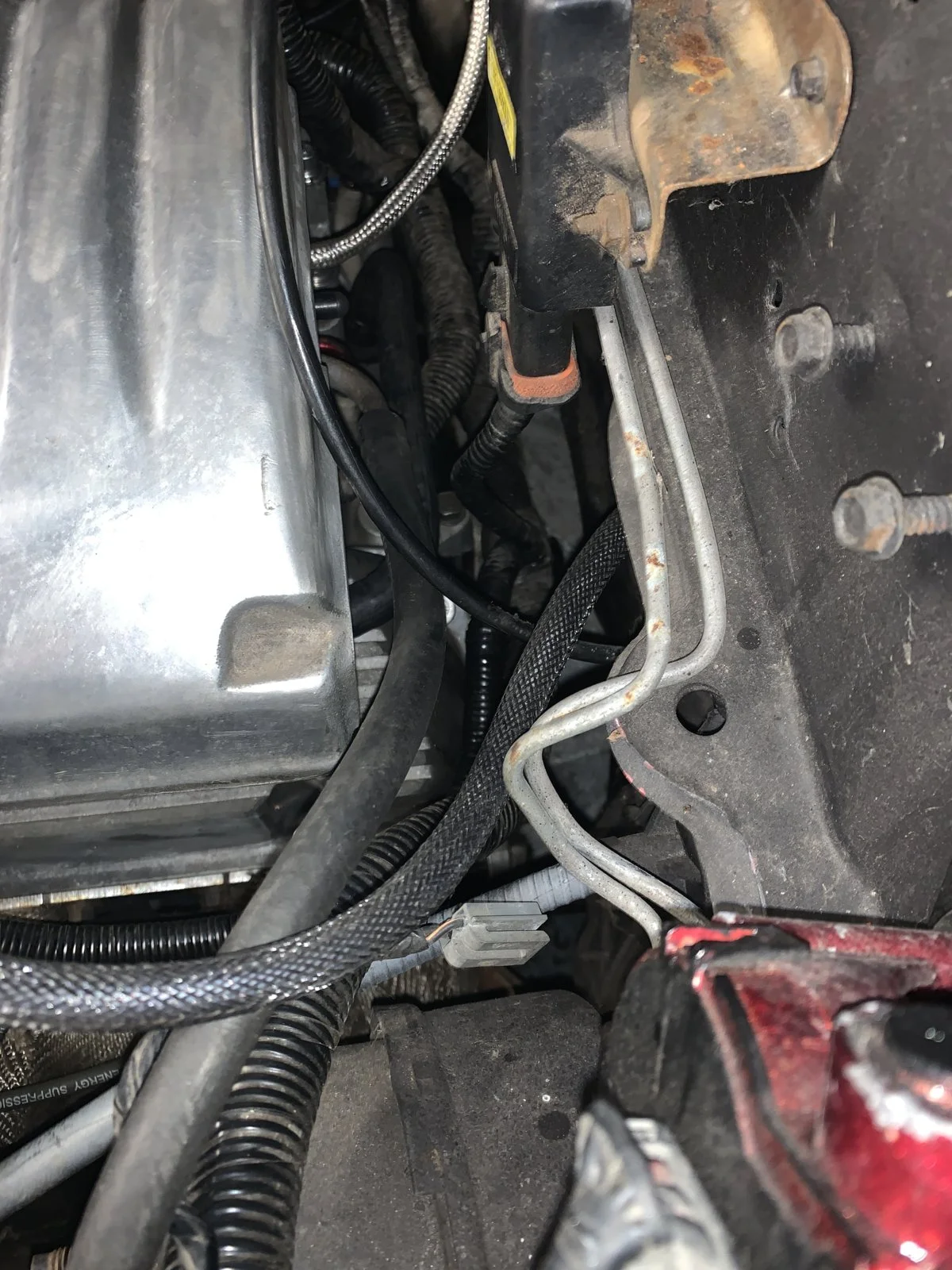

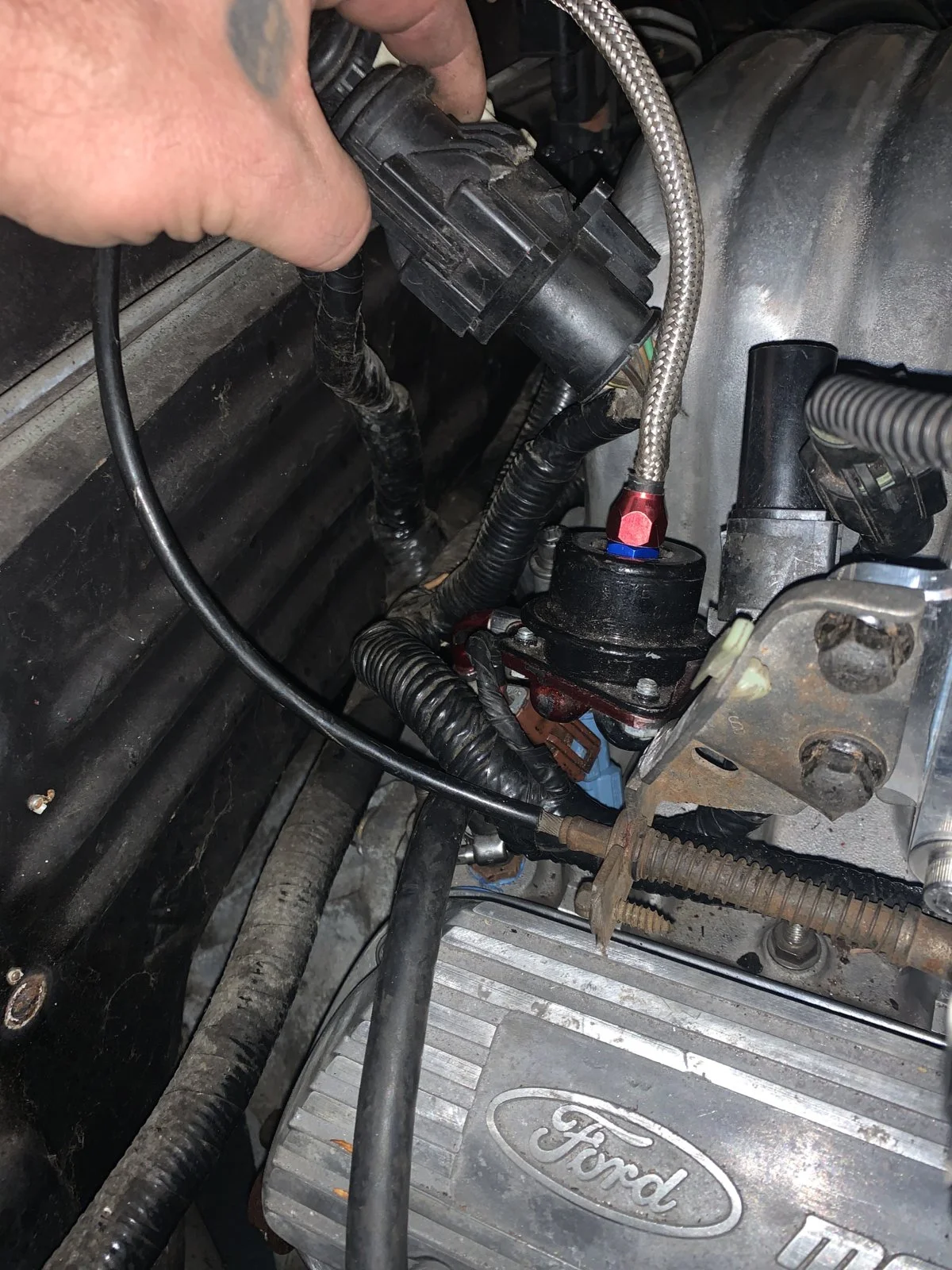

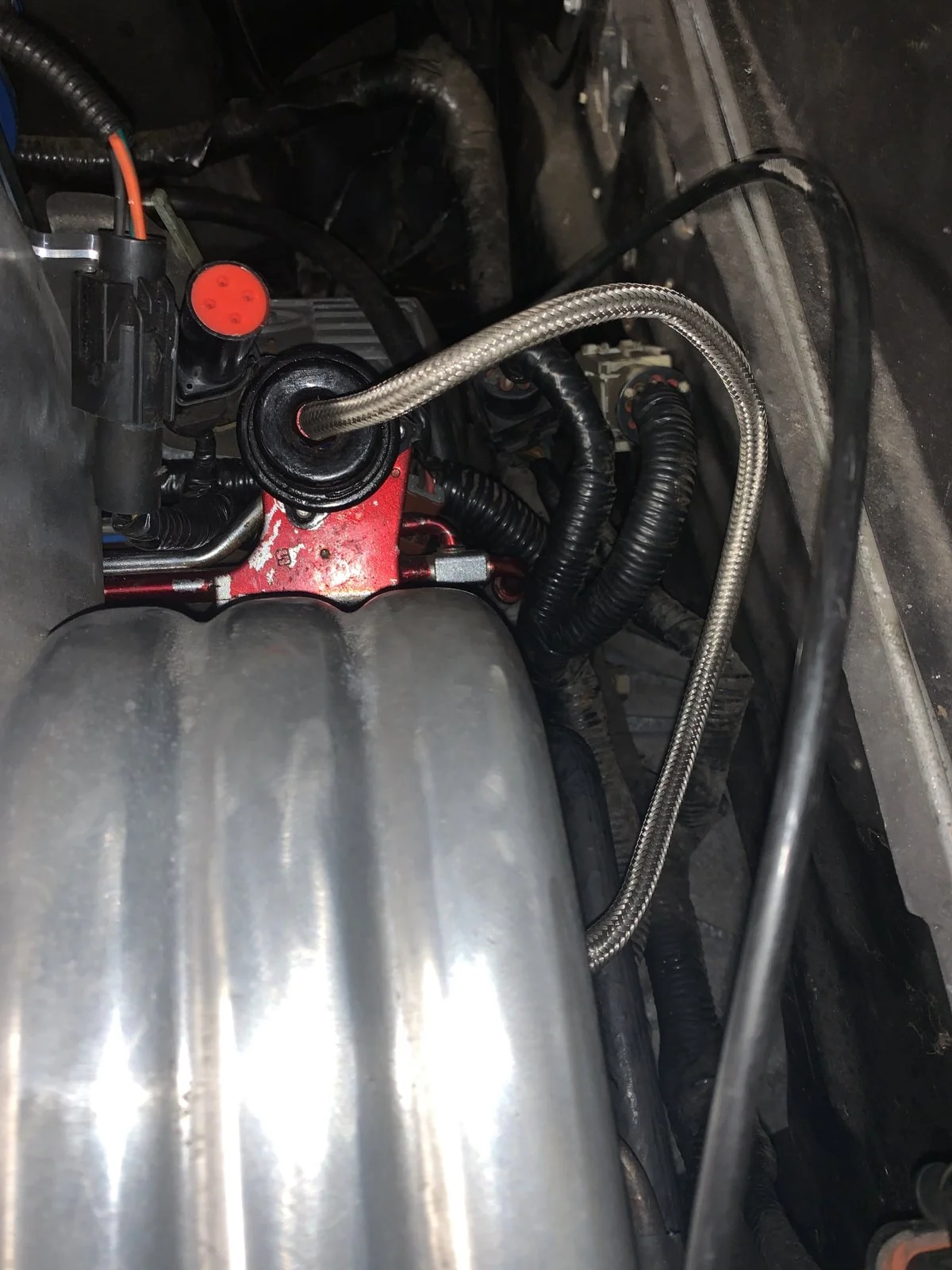

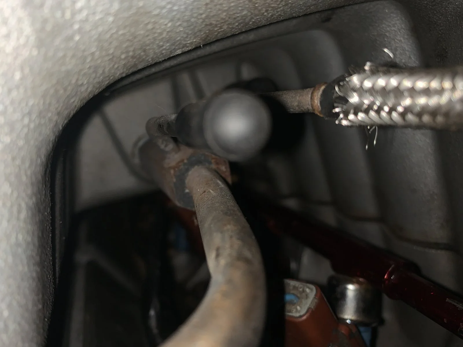

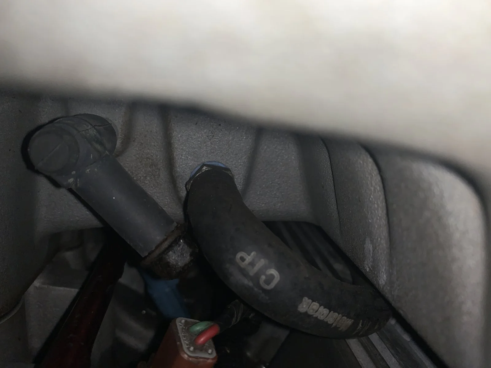

the only thing I can see that’s not hooked up is in the picture. Not sure where it goes either.
My vacuum lines are what’s shown in picture as well. Brake booster to intake, intake to pcv, fuel rail to intake. That’s it.

That one pic with the sender in the oil pan and cut wire is the oil level sender, ignore it.

Anyway, my coil is on the fender next to solenoid, the rockers are the ones that came with the jr Windsor heads1.6 I believe. They are rollers. I wish I could send a video of when the car was running good. I think it may be the computer gone bad because it’s the only thing that makes sense at this point with the maf not working and the car running when it’s unplugged. Idk. Thankfully it’s a project car to fill my boring days and I’m not in a hurry to have it perfect now that winter is approaching. Not to mention there are a lot of other things I can work on while I wait for parts or that moment of clarity when the problem reveals itself in a dream haha. I really do appreciate your time, help and patience in all this.
I was looking at the harness by the heads and I don’t see any ground wires at all. I know I pulled the old harness out of the car way back when because the guy before me butchered it. I remember bitching about it, but then I went and butchered this one. Plugs were broken so I just soldiered and or crimped the wires together and being it was so long ago, I forgot.
you can see the blaster coil in this photo.

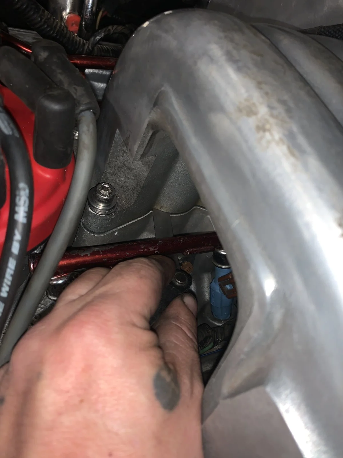

When you take the upper intake off look for a orange wire with a round terminal end, thats a ground, needs to be bolted to the head or intake bolt. It's usually under the fuel pump regulator area coming from the injector harness.

Man I can not find any ground wires. In the book it shows 109 on the location views but it doesn’t show them on the grounds pages. I have 100, 102, 103 and 104. I’m missing 105 and 109

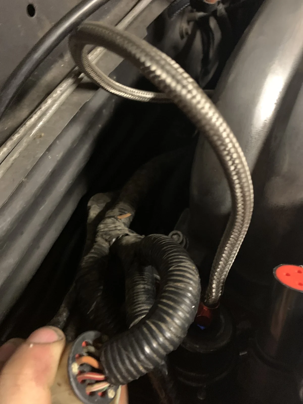

Well the big problem with the o2 sensors is that the holes for them are welded shut with a bolt in them:chin:chinand I figured out what evtm was when I looked at the book hahaha. Yes I’m a dummy
That light brown wire is likely the g109, I'm going from memory, it may be a different color on your year, I have a 89. That g105 is battery ground I think. They changed some wire colors in 91 and 92-3.
If that brown wire is in the injector harness then I bet that is the missing ground, that and you need a ground from the drivers side head to the firewall.
