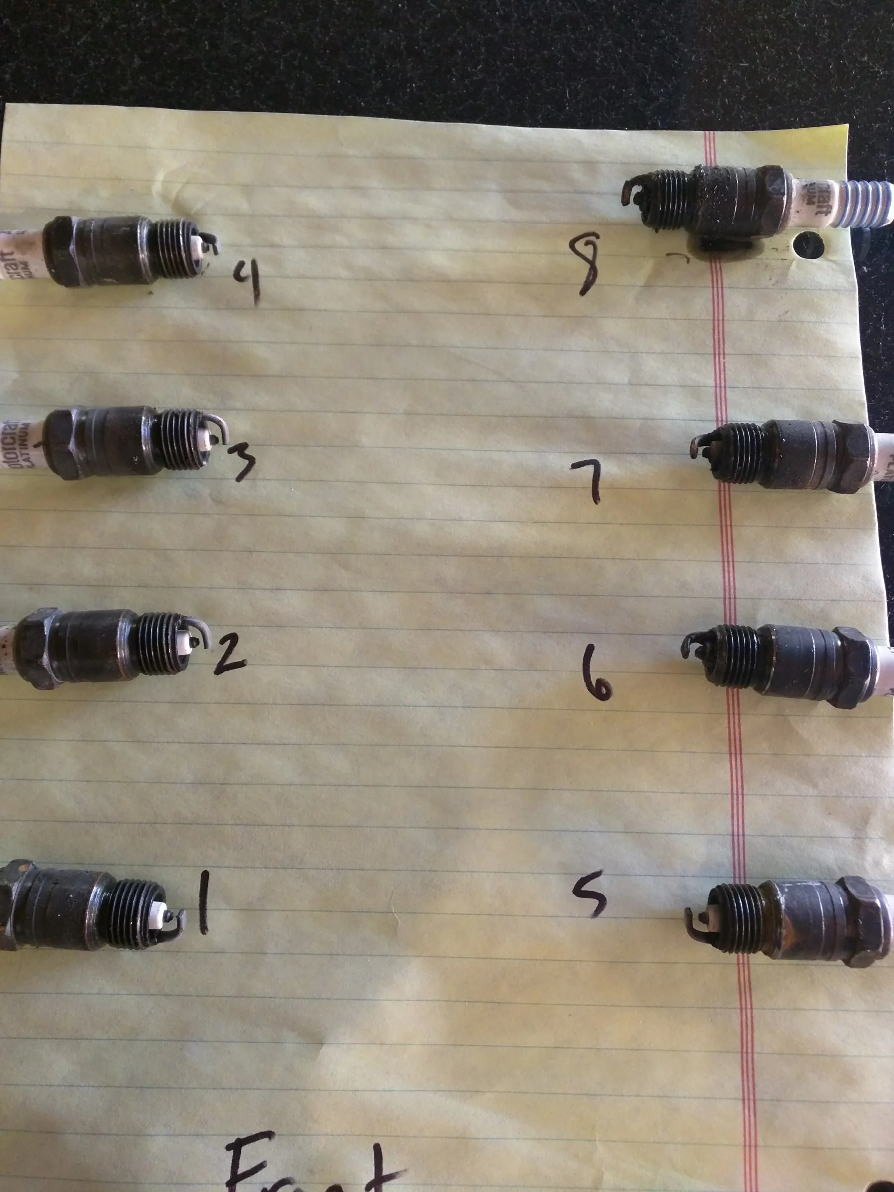

I need to remove my cross over tube to clean it so I may remove that stuff to make it easier on this side. Right now here is what I have. You can see that #8 is pretty rough as well. #6 looked just about like that before I cleaned it to see if it was truly fouled (it is). Keep in mind that I discovered the EGR valve was completely blocked, pcv valve was missing screen, and I had oil in the upper intake. I have since cleaned egr and replaced pcv screen and clean iac motor as well. But I am still worried this thing has some valve seat or ring issues. Wife won't like me saying I need to rebuild it and may result in it sitting for awhile.

Here are all 8 plugs.
