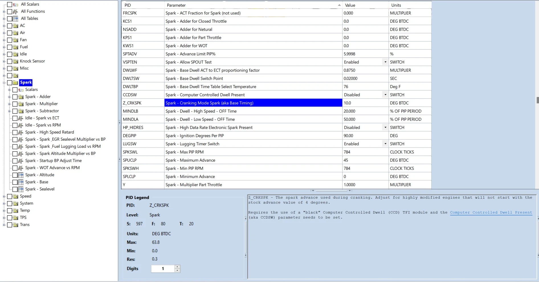

The computer controls the timing with the spout installed, disconnect the battery for 15-30 minutes to erase the codes so the computer starts fresh.
Sounds about right except for the 13* part..Timing is 10* unless you specify in the tune..Even 3 advanced changes the timing events between Injector and valve..

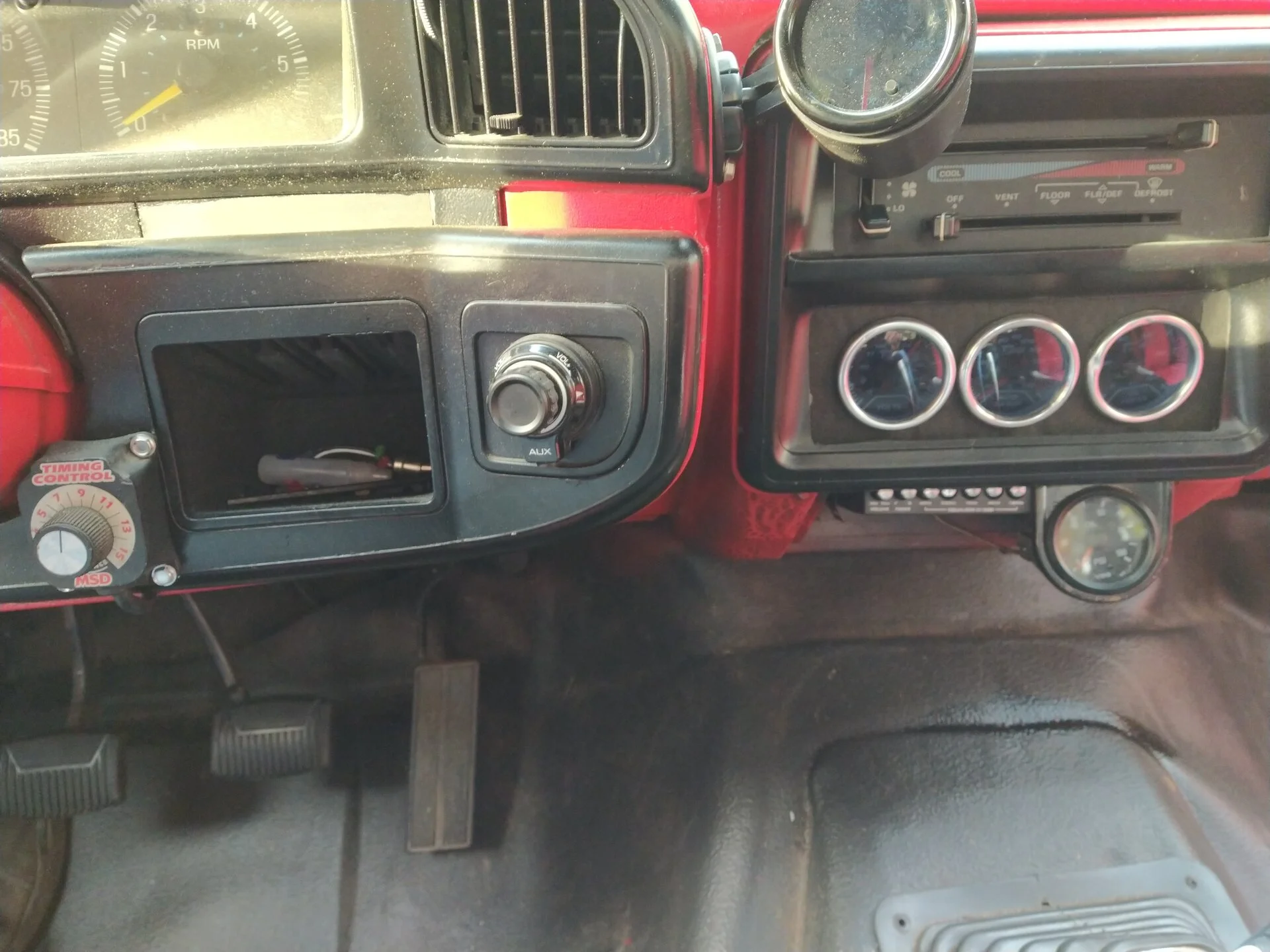

When I want to advance /retard my timing on the fly I use one of these...They sell units that work with and without MSD ignitions....

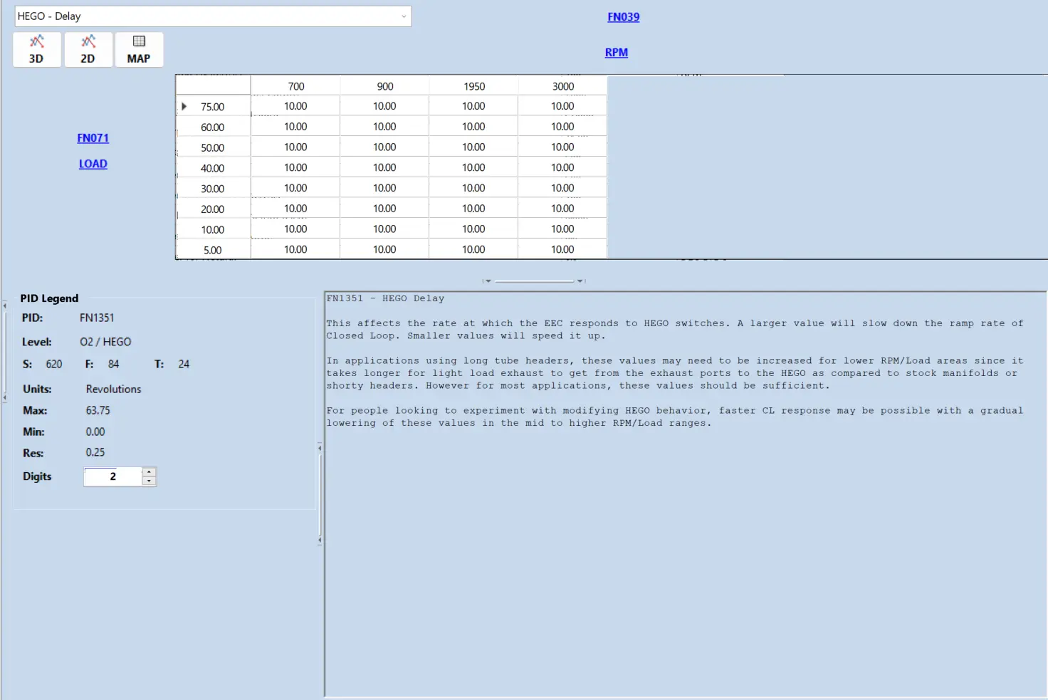

The EEC has a timing table used to time the sampling of the O2 sensors to coincide with the arrival of the latest cylinder exhaust pulse from each bank and when ipen doesnt give a good pulse resonance also meses with proper engine scavenging..
Moving the HEGO sensor further away or letting it operate too cool may result in an mis-timed sample which could also cause improper air/fuel mixtures to occur due to the O2 sensor not sampling when the pulse passes the sensor.
One way to compensate for the additional time needed due to adding length in the Long tube headers is to change the timing table or the FN1351 table values or just put the exhaust back in before starting it any further or ready to drive..
@CAMTWO1070
Too much technical information, we don't have a dial on the dash, not gonna move the bung for 02 sensors for optimum exhaust sampling, or have the ability to change the FN1351 table, I don't even have a dinning table :doh: I have a patio table but I ain't change'n that :nono: oh, and my mustang ran just fine at 13*, far more spunky than the pedestrian 10* the factory sets them at and still ran the crappy 87 octane junk they call gasoline today.
