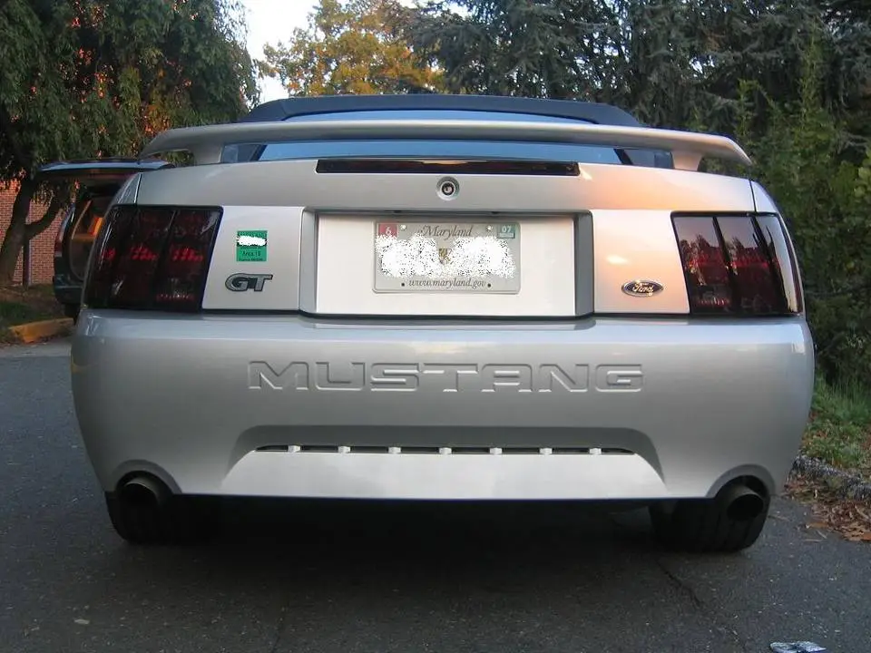

I did mine myself with vinyl window tint. Don't use the adhesive stuff. I got a windshield tint strip at walmart and cut it to fit. Cost 5 bucks and I've never done any kind of tinting before. Its worth it to try it before you pay someone else to do it.
