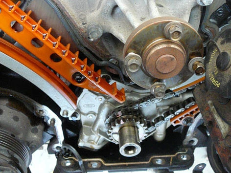

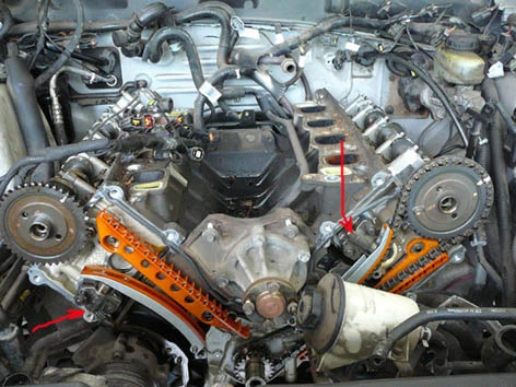

If your timing chain is indeed loose, it is probably due to the tensioners on the picture below

what year is the car? in 2001 Ford went to a plastic timing chain tensioners that are C R A P...pre 2001 used a Steel tensioner thats much better and I recommend the steel ones for ALL years, vs the plastic/nylon ones which have a high faliure rate..........

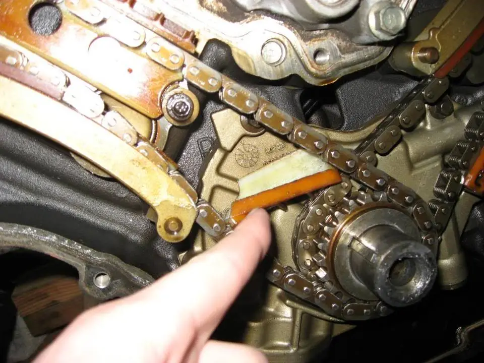

actually it looks like that bolt was probly over tightened.... its only plastic. (not saying you did it but someone did) even if it was you that put that on, it could've been damaged from someone else over tightening it there previously or something. :shrug:

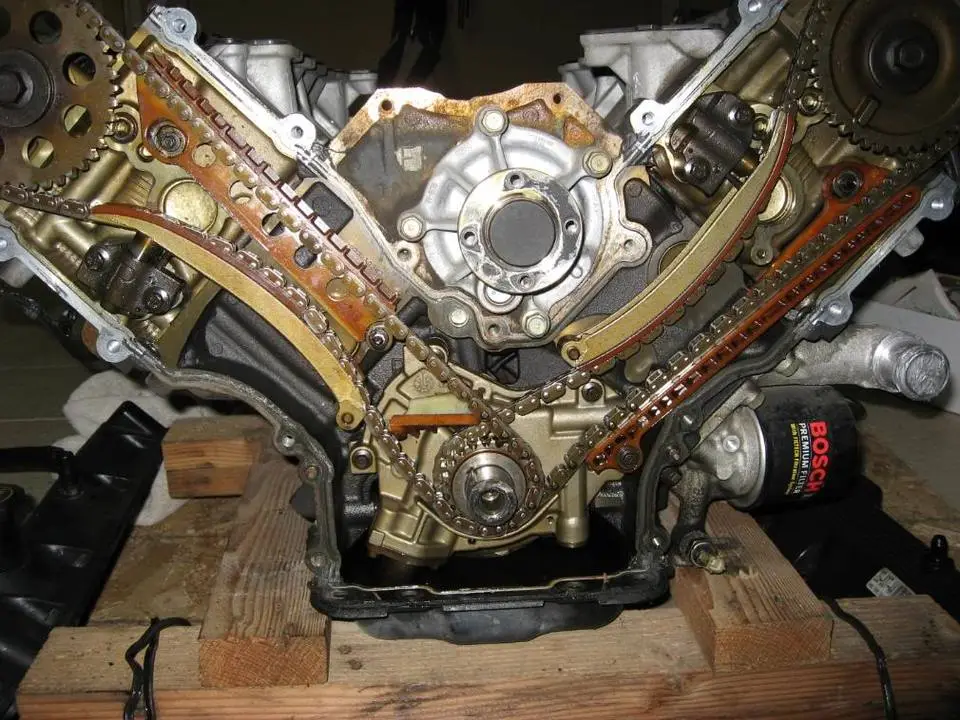

that's the stock engine pulled apart, no one had touched it but ford up until that point. Obviously it was pulled apart cuz it was having problems like that - PI heads were salvaged tho.
Plus, the part you see broken off came from the passenger side bottom tensioner, not the top where that bolt is. That part is fine, so the over tightening scenario is definitely not the case here
