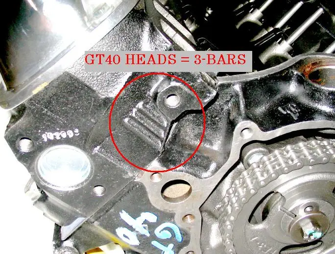

These guys are telling you right. I recently replaced my E7 heads with a set of GT40s I bought used on craigslist. I paid $250 for the heads and $65 per head for a valve job. I think between $250 and $350 is where you will find most of the GT40 heads priced. Identification of the GT40 head is very simple, look for the three vertical bars stamped on the front and back, also there will be a "GT" stamp on the corner. Do not get the GT40P heads, they have spark plugs that stick straight out and have a "GT40P" stamp in the rocker valley.
