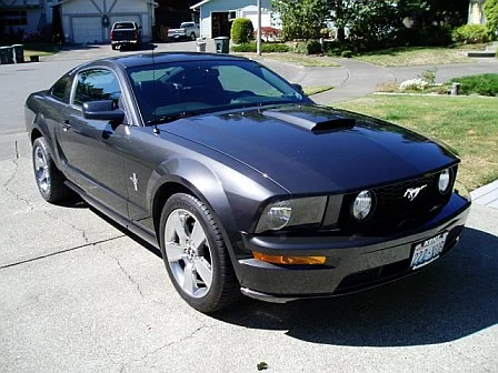

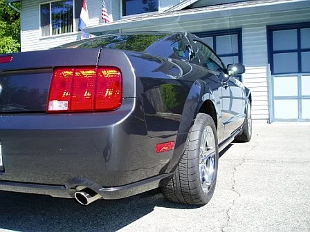

I bought 275/40/17 drag radials for race days and mounted them on Saleen 17x9 replicas that were supposed to be the correct offset for S197's, but once mounted, they stuck out a little anyway. They are shorter, so I have to recalibrate my speedometer for track days, too...
