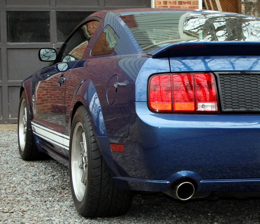

Ok, I want this package, very reasonable price.
I need your guys input on this.
I am getting 20"x8.5" in the Front
and 20"x10" in the Rear
Ok,
Now, Tire size the package comes with:
-245-35ZR-20 Front
-295-30ZR-20 Rear
The part I am not liking is this:
The sidewall on the rear Tires will be shorter, Not much, but shorter.
And, 295 is hellaciously wide, will that be so wide it will make my car look ridiculous?
I am so close to buying this package, but it just scares the crap out of me that the rear might be just to wide and that it will have less sidewall than the front.
Please give me your thoughts,
Thanks!!!!

I think you already have the best looking wheels for this car! If you do go aftermarket, I would suggest looking at smaller wheels and more tire. Comfort and performance

Nothing wrong with the width at all. But personally, I'd get the wheels and tires separately, or see if they can substitute. It looks much better with both the front and rear having the same sidewall. It's especially noticeable on 20's when the sidewall in the rear is shorter. . But 295 is definitely not too wide for the wheel. Not at all.

I also love the wheels already on your car. I'd save the money or spend it on something else like some extra power under the hood.
The wheels you already have are beautiful.

just because the ratio is a smaller number does not make the sidewall shorter. for example, a 245/45/17 and a 275/40/17 tire are nearly identical in height. the tires listed here are going to be OK.

295 on 10" wide wheel is fine on our cars. That is what I run and they don't even come close to rubbing, even lowered 1.5". I wouldn't let a tenth of an inch in sidewall height stop you if you want that setup. It won't be noticeable.

You can still tell the difference. They sit differently on the wheel, so even though they will technically be taller, they will look shorter.
