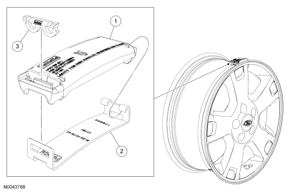

this is what came off of fords tech website.. it should look the same (i got it right out of the mustang "tpms" service section in the workshop manual)
its exactly what mustangmike said, ford's TPS sensor is mounted to the wheel unlike other systems. My winter wheels don't have the sensors mounted to the wheels so I get the error every so often, but I still go and check my tire pressure every so often.

From what I have heard / read: The sensor itself is mounted to the rim with a metal strap. That strap needs to be cut to remove the sensor from the rim and transfer it. The straps are not reusable so you would need to order new ones, but the sensors themselves can be moved.
