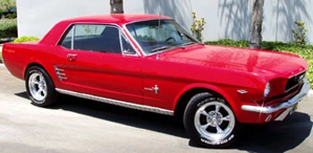

I just bought some 15x7 torq thrust II's with BFG radial t/a's, and the look AMAZING. The only problem: the fronts are rubbing the fenders. They rub pretty good on dips and quick bumps, especially when i have passengers. Has anyone had this problem and how did they solve it? I'm thinking about rolling the fenders up a bit, I am also going to buy KYB gas shocks with heavy duty coil springs. Will this solve my problems?
Here's a fine picture of the glorious wheels/tires
