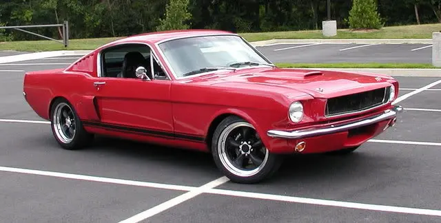

Here is the gospel on wheel/tire fitment - http://www.dodgestang.com/Tire Fitment Guide 65-6.pdf
