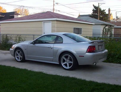

Here's a pic of KDW 295's on a 10" rim. These tires grip very well in dry and wet road conditions. Had 555's on before and the KDW are much better. Sorry, but I don't have a good shot of just the rear tire.

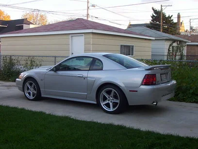

Here's a pic of the stance with Eibach springs. Had BBK springs before and Eibachs are much better in my opinion. Also have Bilstein's installed and they make a world of difference.
