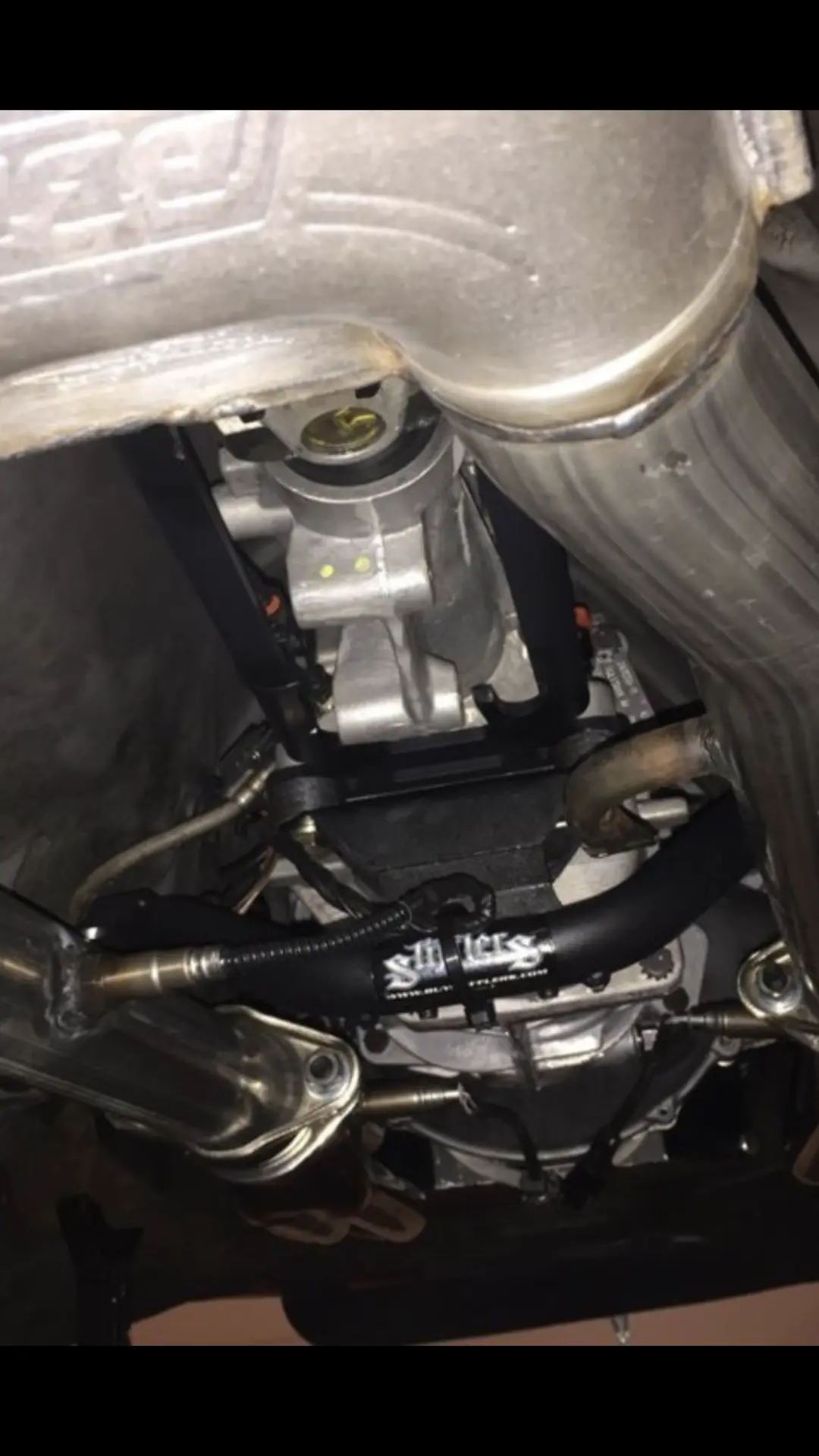

Has anyone here done the TKO modification to fit a Stifflers drive shaft safety loop ? It doesn't look hard to fabricate without having to cut the unused torque arm boss off. Can't find any pictures or info on the net.

Nope . I said to myself I’d rather take my chances of weakening the brace in the center of the loop a hair then cut a new trans so i cut the center of the brace some on the ds loop so the trans passing through .

Do you have a picture of it...I may end up doing the same thing.

It doesn't look too complicated to fabricate. Some 1/4 thick angle and 2 inch wide flat stock should get it done. I've got my other one to get the round part out of. I've got to ponder this for a while.

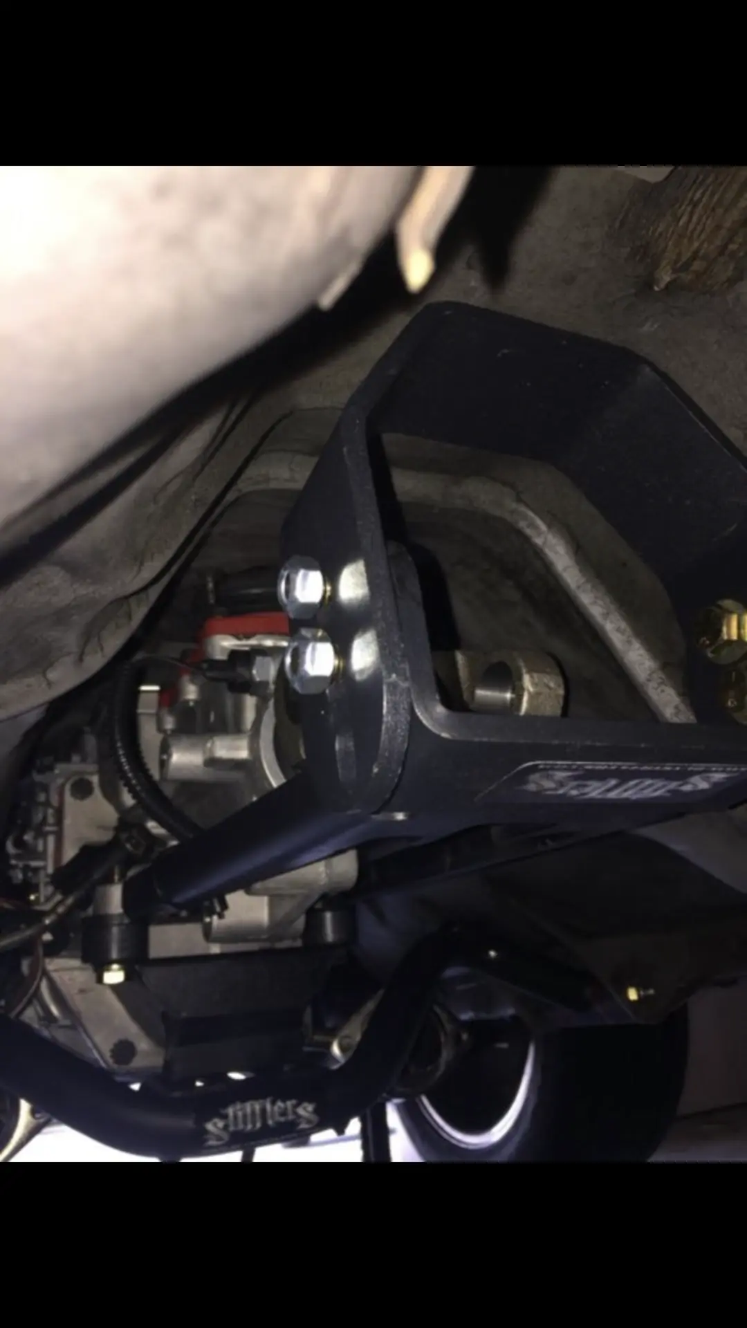

I've seen that one...the loop i have does have those dang bolts protruding towards the driveshaft. It actually won't clear my aluminum driveshaft unless I bend the hoop to widen it up.
The BMR one is nice but not for me. No holes will be in my floor. When I get mine made I'll see if he can fab up a couple extra.

I'm not knocking the Stifflers one. It's clearly aimed towards a market for people who don't want to take their seats and carpet out to install a loop, which is comletely understandable. It looks pretty dang heavy though.

It does look like it may have some weight to it. If I was building a race car I wouldn't care about drilling holes in the floor. There would already be atleast a 10 point cage and a straight axle in it.
To me weight is relative....there's a power to weight ratio....just means it needs more power.
I'm sure there are some heavy beasts running serious numbers. One of them is a full interior trackhawk thats in my racing crew. Its 5300 pounds. A dodge demon weights in at over 4k. Yes, lighter helps....but power makes up for it.
That thing hanging off the transmission mount seems like it would add some harmonic vibrations. Seems like it could turn into some type of tuning fork.

I'm sure it's been tested by now, and I think someone would have found out if it caused a vibration problem or something. I am more concerned about weight than normal. Most things are 3300 or 3400 lb weight limit, and my fat piggie is way over.
