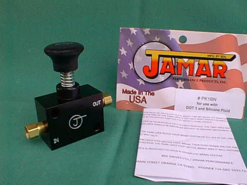

To me, this is a parking brake:
Rear brake line goes in, and out to rear brakes. You step on the brake, push the button, and a angled one way valve holds that line pressure on the rear brakes until you step on the pedal again. I used to use one of these back in the 90's on the front brakes as a poor mans' line lock. (cost about 20 bucks back then, now it's double that)
This gets my vote! Thread closed....
