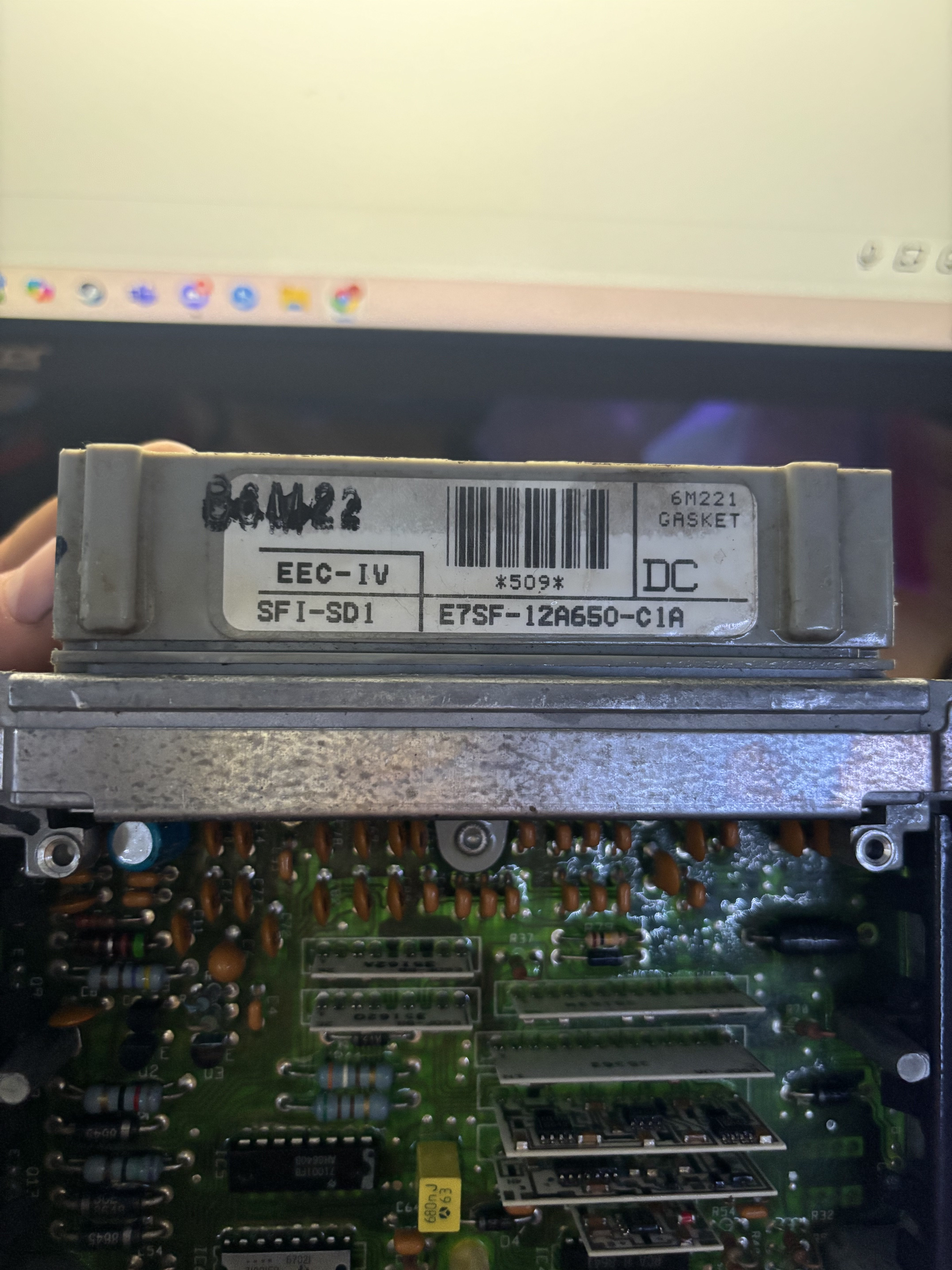

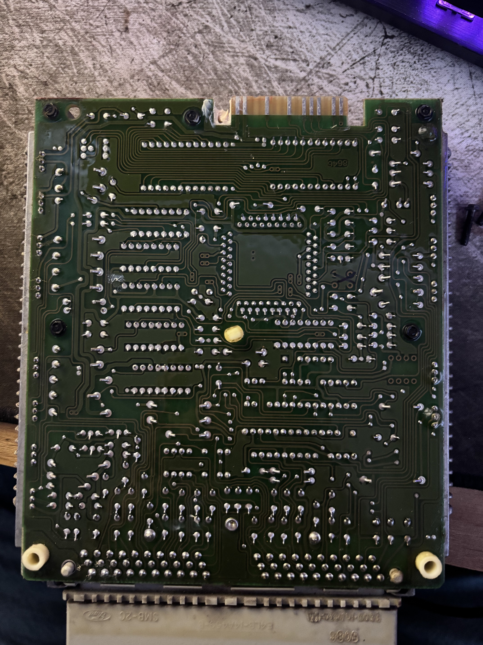

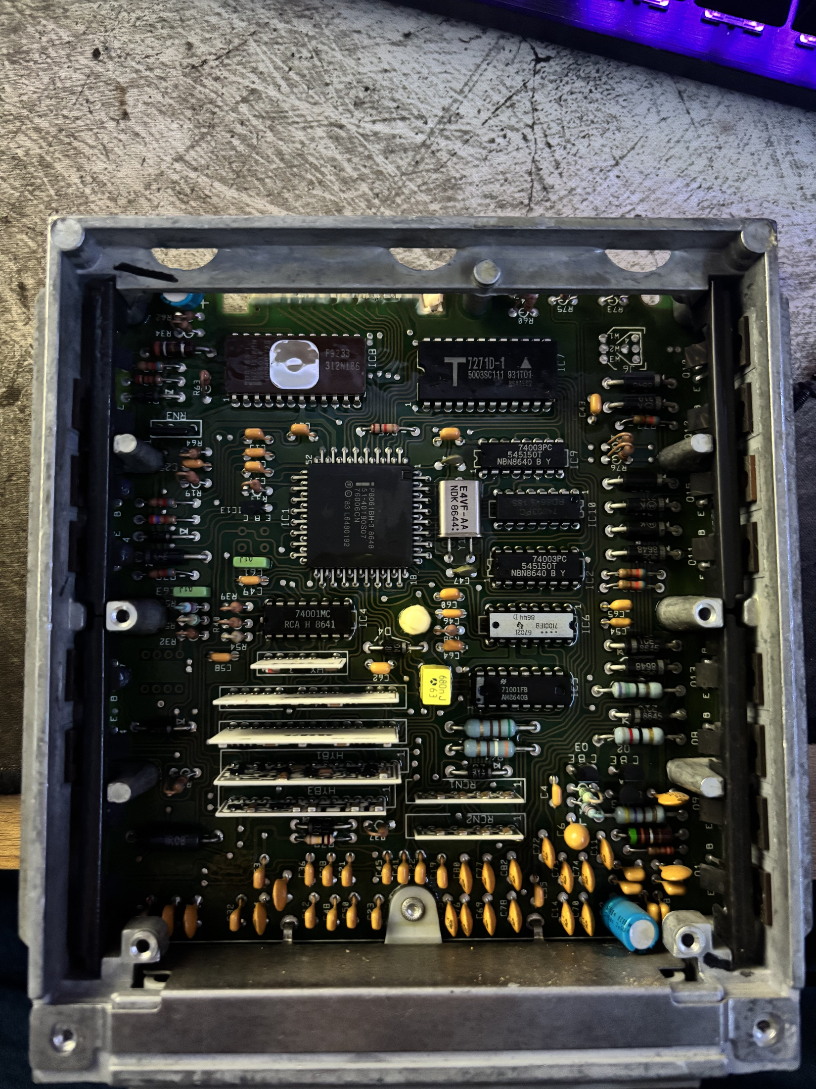

Well I cracked open the ecu to give it a look for myself, best I can tell it is a VM1 ecu and it is original to the car. The inside looks flawless and the caps do not appear leaking or bulging I can't seem to find any good information on the speed density ecu's.

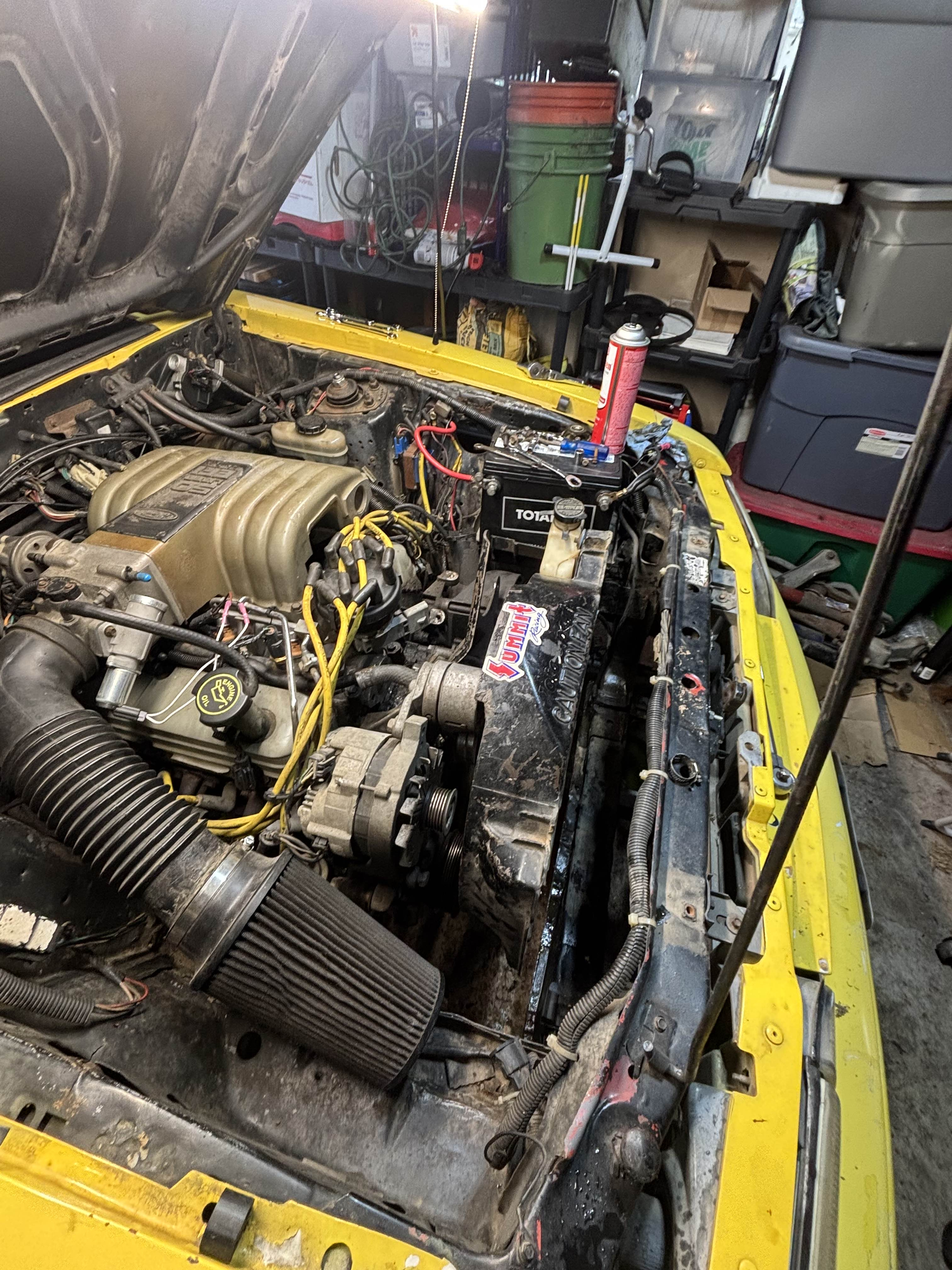

Today I installed a new SVE aluminum radiator from LMR. Before I was having cooling issues, temps would constantly creep and hover around 220 which I didn't like. Also installed a new 180 thermostat and removed the old A/C condenser as it was doing nothing, while doing the test drive after the install I never saw the temp hit over 200 at all! I will need a new fan shroud as the original one is broken and comes pretty damn close to the fan at the bottom.
Although in doing so, I had to move the distributor as I had no access to the right water pump housing bolt from any angle but where the distributor was, I marked its location but I think the timing is screwed up now. It feels down on power and above 4000~ rpm it completely falls on it's face I plan to get a timing this week to check it out.

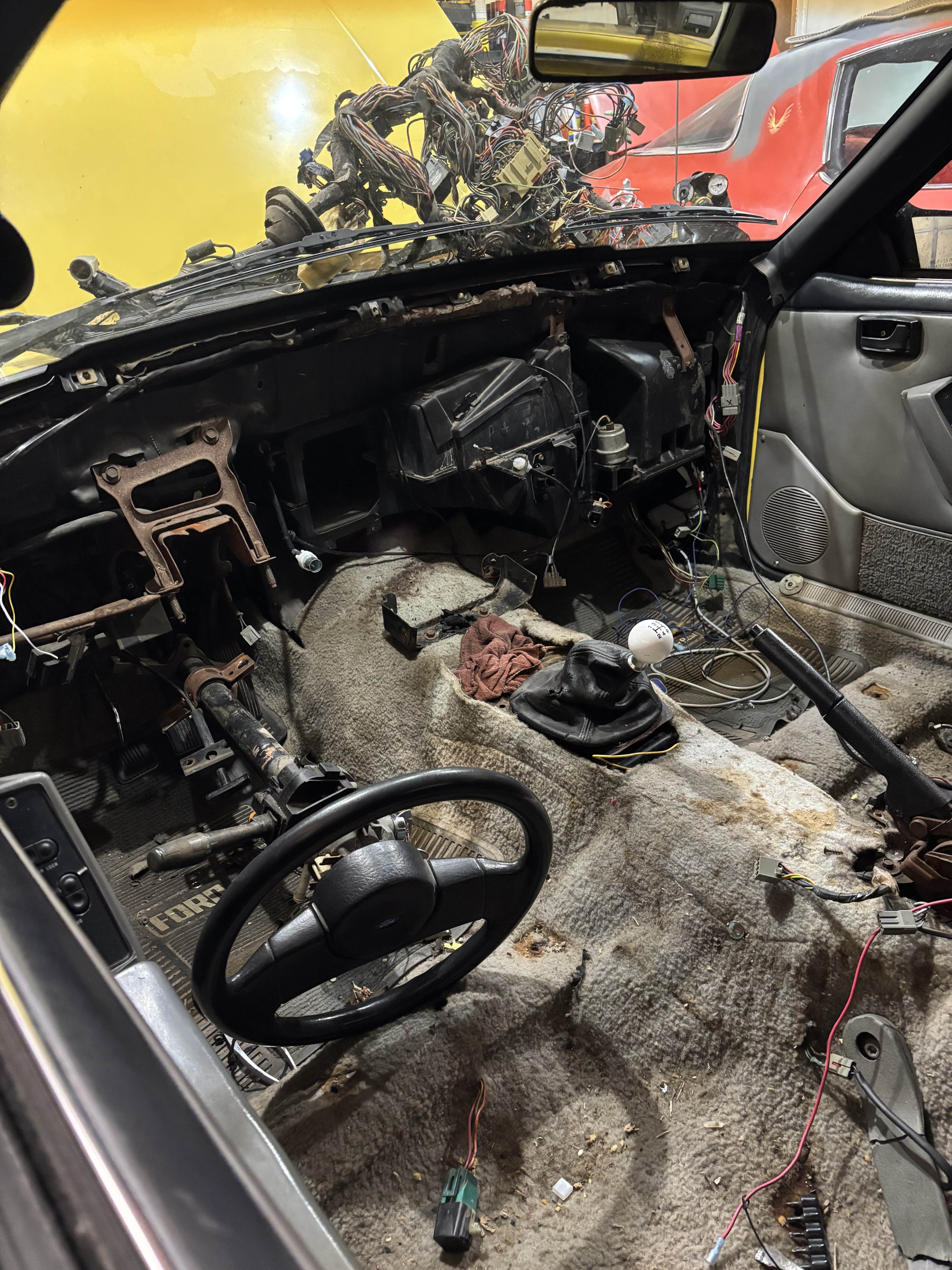

My car has always stunk of mice since I had gotten it, I have seen four in the car so I decided I am pulling the interior first and foremost. Today I pulled the dash out of the car as well as the dash wiring harness as it needs to be replaced, so many broken and damaged wires. I am also planning on replacing the column and plenty of other parts to put the interior back together as it should be! Surprisingly the dash wasn't too hard to remove not real fun doing it alone but definitely possible with one person.

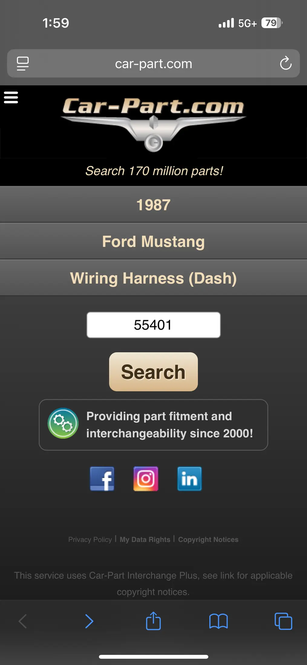

www.car-part.com
87 or 88 will work. Pretty sure you can use a 4 cylinder or V8 harness. My require some repinning on the instrument cluster?
I was talking with my coworkers and they suggested this website! I’ve never heard of it but it seems pretty damn nice.
I figured just about any harness between an 87-89 would work. I’ll do some digging tonight to find the parts I need! I am scared to put the dash back in, lot easier to pull it out than to put it back in :notnice:
Good news! I had a think about my harness situation and realized that I technically don’t need one.
Last night (technically this AM lol) I went through the harness and removed all the unnecessary radio stuff from the harness leaving me with just the speakers, radio power/ground/illumination wiring which is exactly what I need.

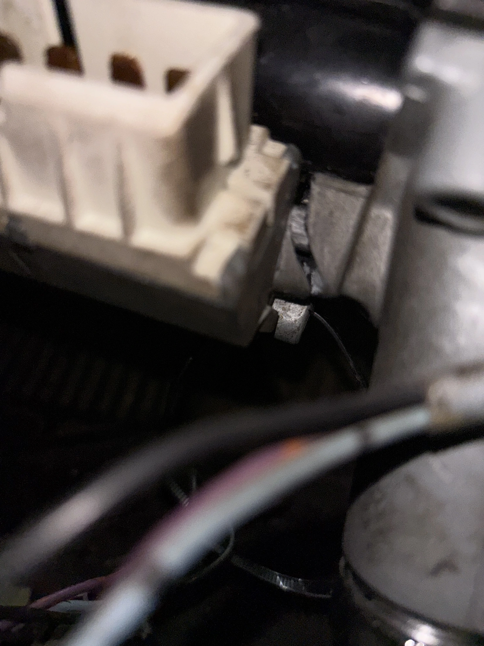

I also went through and fixed the clutch safety switch wiring. I found the switch to have been bypassed with a jumper wire which I removed I also found a bad switch on the pedal assembly itself.
