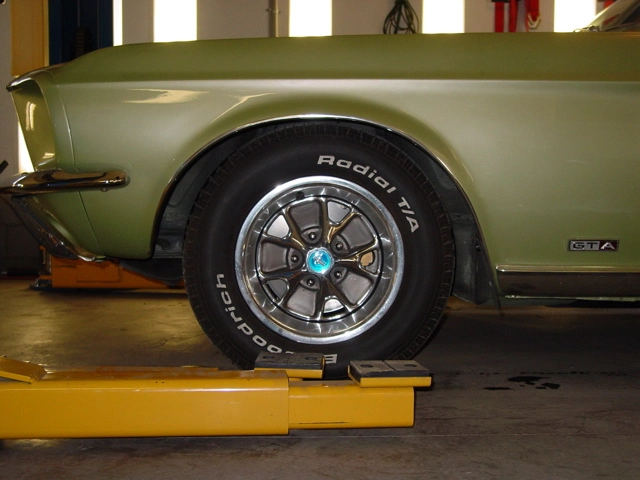

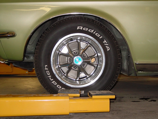

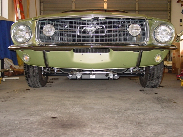

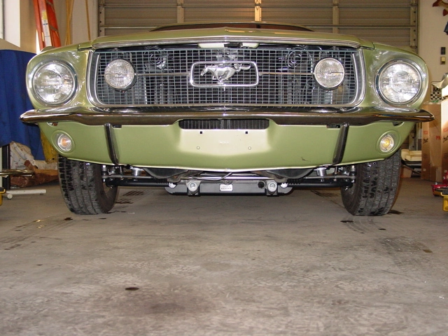

Wow...old thread resurrected. I've since done several Heidt's IFS installs and like the stance. It's certainly lower than stock -- probably 1 to 1.5 inches. This is with coilovers, but with the lower arms level, i.e. at nominal ride height. Here are some example pics:
