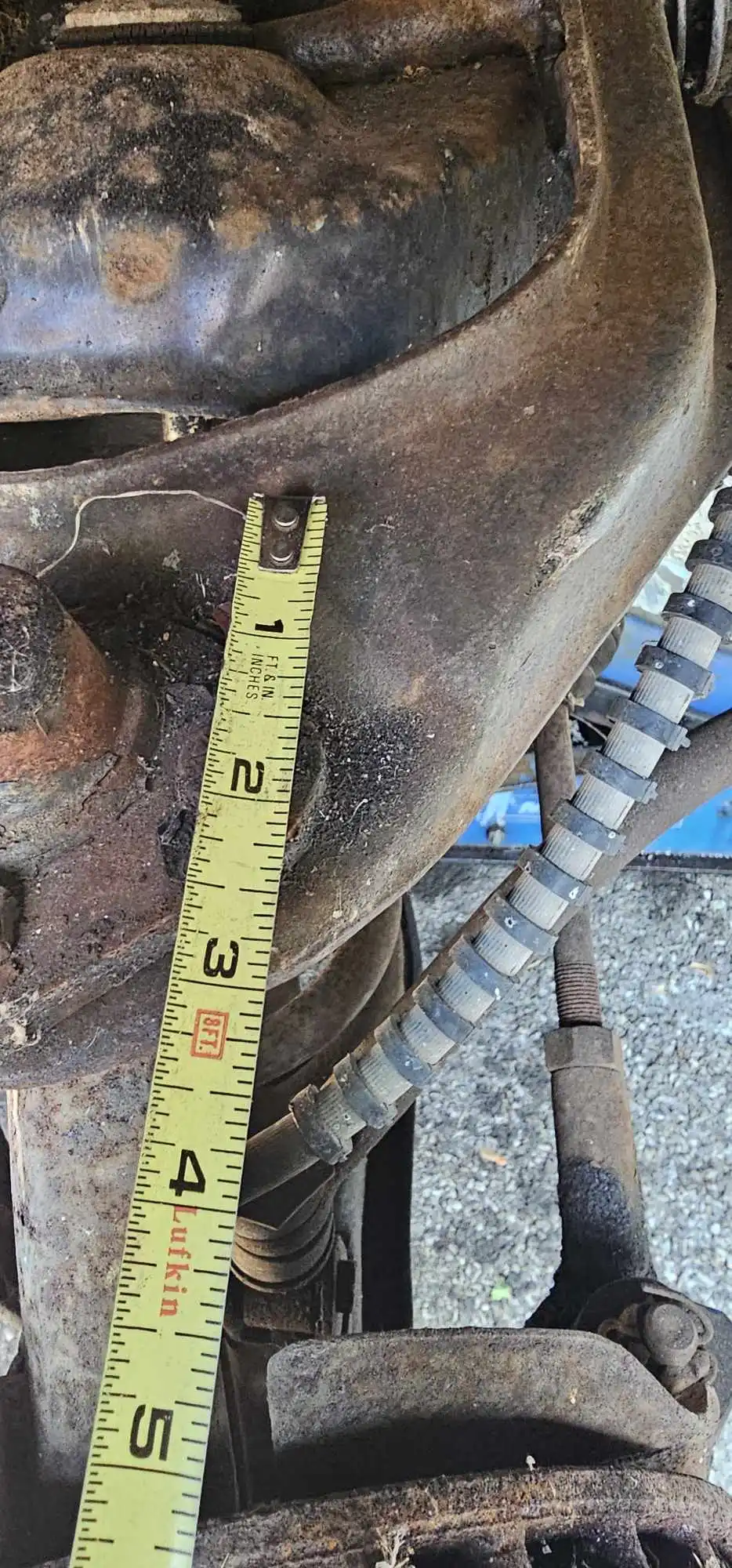

I just measured my front wheel/tire, while it's difficult to get exact measurement with the tire mounted, bead to bead these wheels are over 9.75 inches in width, with exactly 6 inches of back space, and front and rear are the same. Hmmm I thought they were smaller. lol That's why I've been struggling to get steering clearance. Well, for future reference, if anyone is curious, (I will post exact measurements when I'm able) apparently, a 17x10 wheel with 6 inch backspace will physically fit on a II both front and rear, with some things taken into account. However, my car has a 1959 t-bird 9" axle, which is 1 inch wider drum to drum, than the stock 8" was. So it already has a 1/2" spacer on each side. lol For the front to clear the upper arms, I removed the outside half of the reinforcing rib and welded steel plate inside the arm, effectively boxing them. So technically, it's an OEM and it's a (triangular) tubular arm, all at once. With all that done, the wheels will still contact the upper arms when turning more than about 22 degrees left or right, as seen by the marks in the photo, roughly 3" inward from the balljoint. With the 2" drop spindle, that won't even be close to the arm anymore. The steering limiters make the car a pain to turn in a tight space, so I will be doing the 2" drop very soon.

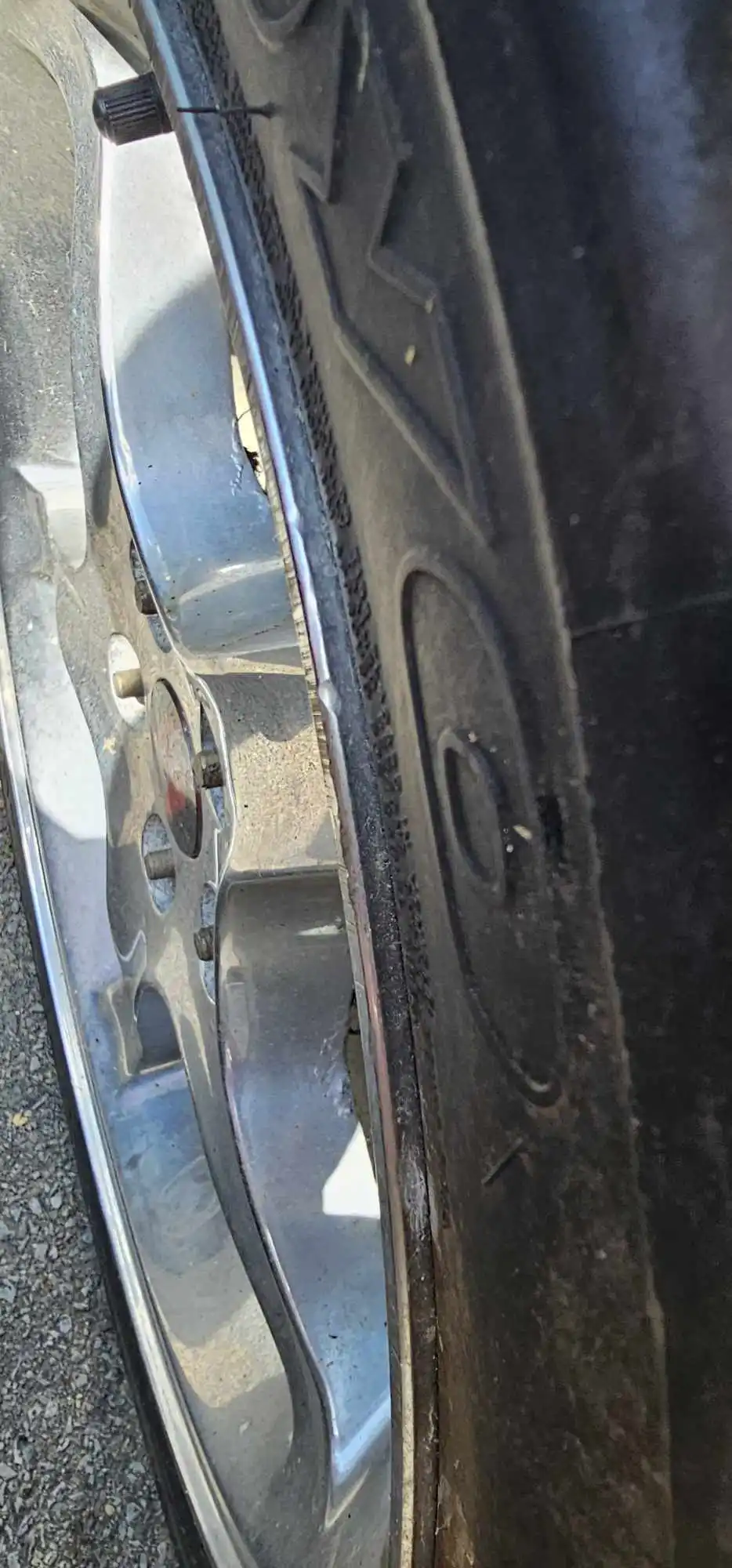

The 255/40ZR17 tire is 10.06" wide, according to what I just read, thus they fit well on the 10" wide wheel. When I got the wheels, they had 275/40ZRs on the back, and those used to brush the edge of the quarter under certain conditions, so I went a little narrower, but when I do the quarter panel replacements, I will remove most of the inner edge of the wheel well, and those 275s will fit nicely. Thinking about it now, I am going to try to fit those 275s under the front too. :D
