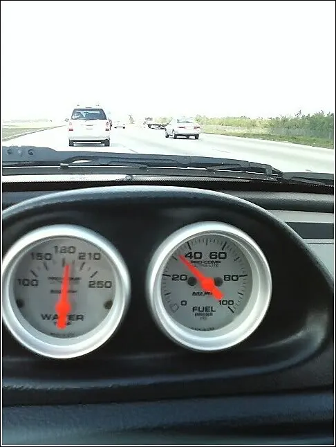

After driving my car (FINALLY!) and putting real stress on the motor with WOTs, and doing 0-60s on the highway I saw the car would go all the way over to the L. It wouldn't pass it (though if I drove it harder I could've made it passed it).
This is the fan running on high speed, on the highway.
So should I aim to upgrade the radiator or the fan?

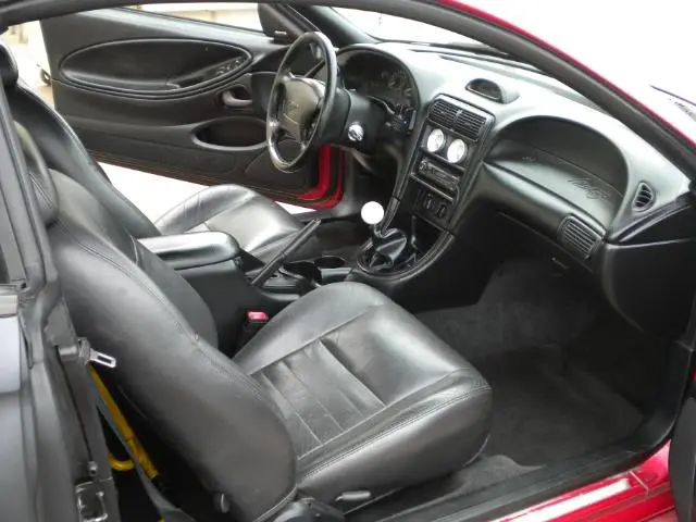

I installed mine in the center stack.
Moved the ac controls to the space where the pocket used to be.
Best picture I have right now.

There was actually this one gauge mount that replaced the spare storage compartment and you could put three in. But that requires putting in two more gauges, and I wanted to upgrade to a double din. But that is one of the cleanest mount spots
Yeah, I thought about mounting them low, but I like them closer to eye level.
How about the cluster bezel gauge mount?
1 on each side, and it'll leave the center stack open for your double din.
If I was keeping it single din then I would've done it the low way, it's harder to say, but it fits perfectly and flows well with the interior.
The cluster bezel gauge is a good one, but still looks off, I considered it for a bit but not to sure.
Maybe I'll do the steering column one, it's not gorgeous, but it's in line of sight and is only one gauge. Time to start pricing I suppose:p

It's really a money thing for everything, it's all thoughts right now. I've just never been about to drive the car into the 'hot section' of the meter on the highway with the fan spinning so it peaked my concern. But, like I said, I was driving it 'rough.'
But, being able to accurately measure my coolant temps seems like a good idea.
180 is the temperature that it opens at, not the flow. Mr Gasket makes thermostats that have a bigger hole and flow more water.

The actually have that Thermostat at Advance and I think at Autozone as well. I have my fan set at 190 degrees. There is no reason to have the fan kick on before the thermostat is open.

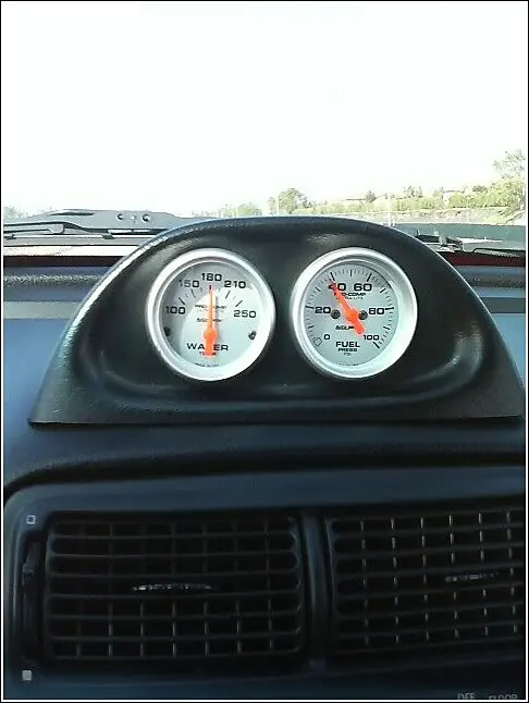

185 in the South Florida heat. C&R Aluminum Radiator, 180 Stat, 2 bottles of water wetter, 60 Water / 40 Coolant, stock Fan switched on HIGH at all times. Oh and a real gauge.

I also have a C&R Radiator. I bought it from Steeda back when they were selling them. Can't speak highly of it enough. I've had it for 10 years now, and I have never had any of the problems people have with other aluminum radiators. The factory setting for the fan is something like 212 degrees. I know for sure it's over 200 degrees.
