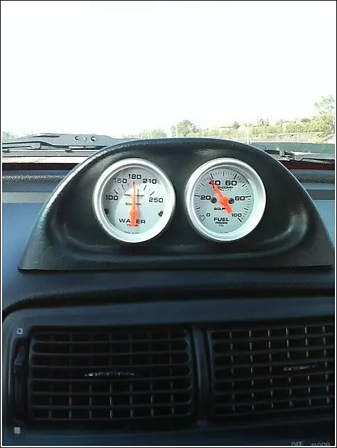

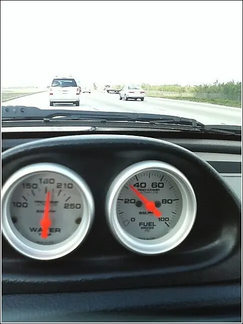

185 in the South Florida heat. C&R Aluminum Radiator, 180 Stat, 2 bottles of water wetter, 60 Water / 40 Coolant, stock Fan switched on HIGH at all times. Oh and a real gauge.
South Florida heat isn't anything like the Texas summer heat, I promise you:/
But that's pretty awesome operating temperatures!
The real gauge must be why it stays so low :(
With my new harness it mostly operates at high speed so that isn't a problem :p
