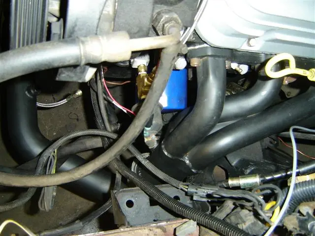

I know some guys can fit the piping on with the sway bar i think it depends on the motor mounts or something i heard...I know can use a small oil filter too but im going to use a filter re-location...What else do you think i need to get..Oh yeah where is your MAF any pics of that?

Ok i see the MAF now in the one picture you have with the bumper off...just where they tell you to put it right after the cold side of the intercooler on the straight part of the inlet tube before the bend into the fender well...Thats Were Chad form on3 told me to put it...Cool ...:nice:

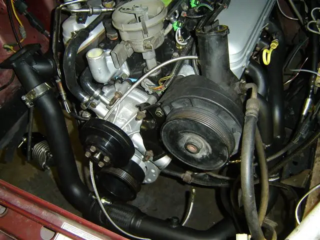

What is that blue hose coming off the TB?..also how do you have your PCV run?...are you using one ?
The blue hose is going to the wastegate. its supposed to only see boost so it should be before the throttle body. There was no nipple on the turbo like usual. I have the whole vacuum system changed on the car. I got rid of the vacuum Tee and just ran each nipple on the intake to something individually. One goes to the brake booster, the other to the BOV, last big one to the PCV, and the 2 little ones to the FPR and boost gauge.
Also, on the line going to the PCV valve, i have a really good checkvalve that closes off under boost. On the other side i have a little catch can. So under vacuum, its pulling oil vapors and catching them, and competely closing off during boost. The stock PCV valve leaks under boost, so that took care of that. I obviously put a breather on my oil cap, and recently drilled a hole in the other valve cover to vent more oil vapors. A pressurized crank case is one of the main reasons boosted motors blow.
